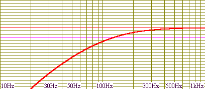

Amo:
I was unable to check Volt's numbers against Win ISD's listed numbers, since Volt's website is all messed up . Text is overflowing the parameters, etc.
Anyway, here is my own WinISD simulation, using WinISD's parameters for the Volt BM2500.4
They seem to bear out Sonic Craft's review.
This for 2 Volt BM2500.4 loudspeakers in an 80 liter sealed box.

This is what I got also. But this responce is very similar to most "mainstream" subs, such as Peerless XLS in sealed... So what does all this mean? Just that sealed/small is no good for bass? But we knew that already.
Amo:
Don't know what to tell you. I'm not a big fan of sealed for subs myself. I know that they are supposed to splice into room gain, but in this instance, you are 15 dB or so down at 30 Hz.
One thing I will point out. These Volts are 92 dB sensitive and rated at 8 ohms. Parallel two and hook up a 4 ohm amp, (like most subwoofer crossover/amps are) and your sensitivity goes up either 3 dB or 6 dB, depending on your amp.
So if, at the least, you are going to go up to 95 dB, then you really are only about 8 dB down at 30 Hz compared to an 88 dB efficient sub with flat response. Room gain should bring it up even closer to flat frquency response.
Just a thought.
Just a thought.

The only thing that I am not sure about, is if it is acceptable to have a sealed box with Qtc of 0.35. This will be the case here.
kelticwizard, you hit it right on the head! The Volts are so sensitive, and doubling up on them doesn't hurt either. The good thing is that the sensitivity of 2 Volts is that it is very close to that of the ATC dome, and also close to many good tweeters! Thank you guys for your help, I just wanted to make sure that I was not going crazy...

The low Q of this driver points to a bass reflex alignment being
the optimum choice, Q=0.35 is too low for a sealed box, I'd say
0.5 is the minimum, 0.6 good, 0.7 maximum.
Even so an overdamped bass reflex alignment is required for
good bass extension. To get a flat bass reflex alignment you'll
need a high port frequency and low bass goes out of the window
- its probably this the comments refer to.
Due to 'baffle step diffraction' the bass unit sensistivity needs to
be 6dB higher than the midrange and treble drivers. BSD also
complicates the crossover to the midrange considerably.
An overdamped bass reflex alignment with a low port frequency
and an active adjustable underdamped 2nd order high pass
filter with f = port frequency will give oustanding results.
🙂 /sreten.

Ok now I understand... I have been modeling it wrong. The two Volts seem ok because of their high sensitivity. All this means is that it will take more power for the other driver to perform on the same level. When you do give the other driver more power, so that the "before drop-off point" level is the same, then you can see how many other drivers outperform these two in the first few octaves.
What you guys are saying about the low Q makes sense as well. I think this one is best left for midbass duties.
