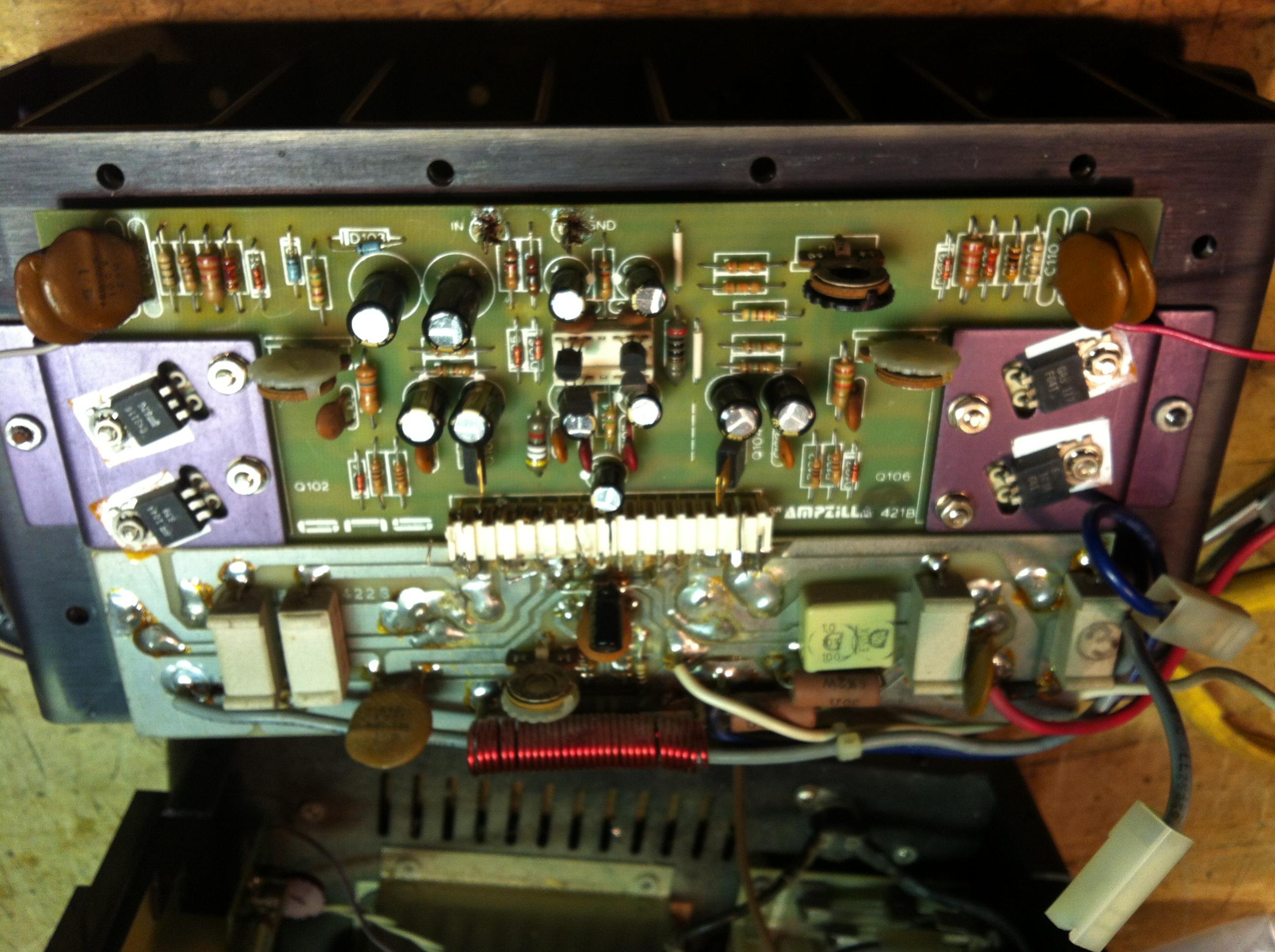

I'm rebuilding a nice Son of Ampzilla. Up to now I've replaced all lytics with Panasonic FM and 2 big ELNA 10k uF 63 volts.
When IVe received and first powered this amp, one side had very low power, even seems only high's going through... After I did re-hooked the amp to speakers and pre, both channels were good? What the hell, let's use it!

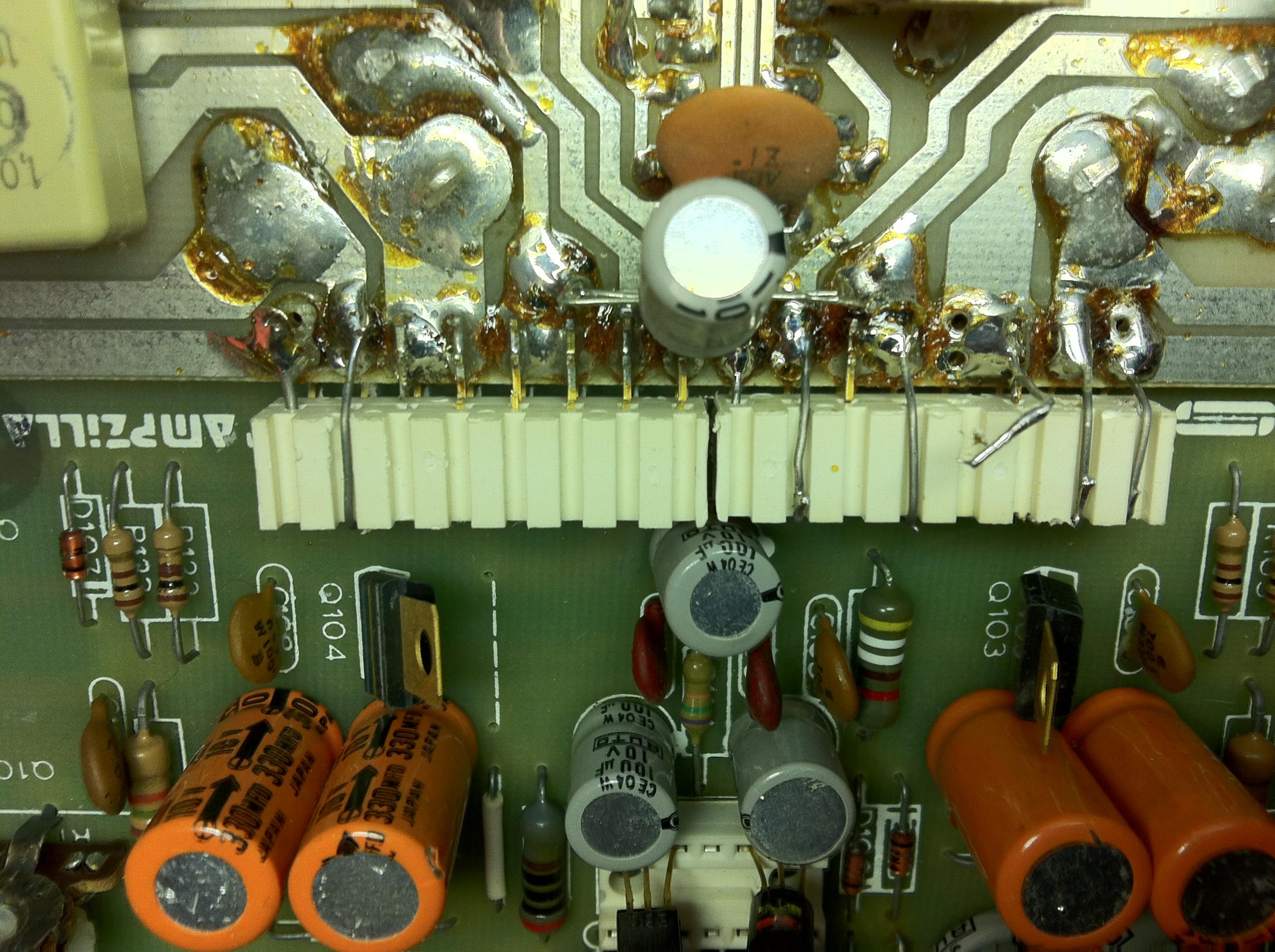

Brought it home and here again, the right channel was weak. Let's open the machine... Found a few strange things; it's beed fixed before. On the left channel (the one that works), the connector strip between the 2 cards was jumped: some wires were soldered over the connector and back to the card except pin 3 that was left open? Thought that was a "mistake" so soldered it again. Powered it up and it got red hot after a minute or 2...? Didn't have time to see if audio was coming out. So removed that link, verified drivers & outputs, and left channel is back working normally(?). I'll post some pictures of this.
And, while playing with capacitors on the power card, I could hear the right channel going up and down so I suspect some bad soldering under this card.
So I did removed all cards, verified all semi's (diodes, transitors) and they were all good. They were all GAS still. No ones have been replaced.
Here I am now; A fully recapped SOA ready to be back to original config. So I'ld like to adjust all the pots correctly. Even, while I'm there, I could replace some resistors, diodes, caps, that you, knowledged guys, would do if you'ld be here. I have in my stuff some MJ21193/21194, MJ15030, 15031, HS4007, etc.

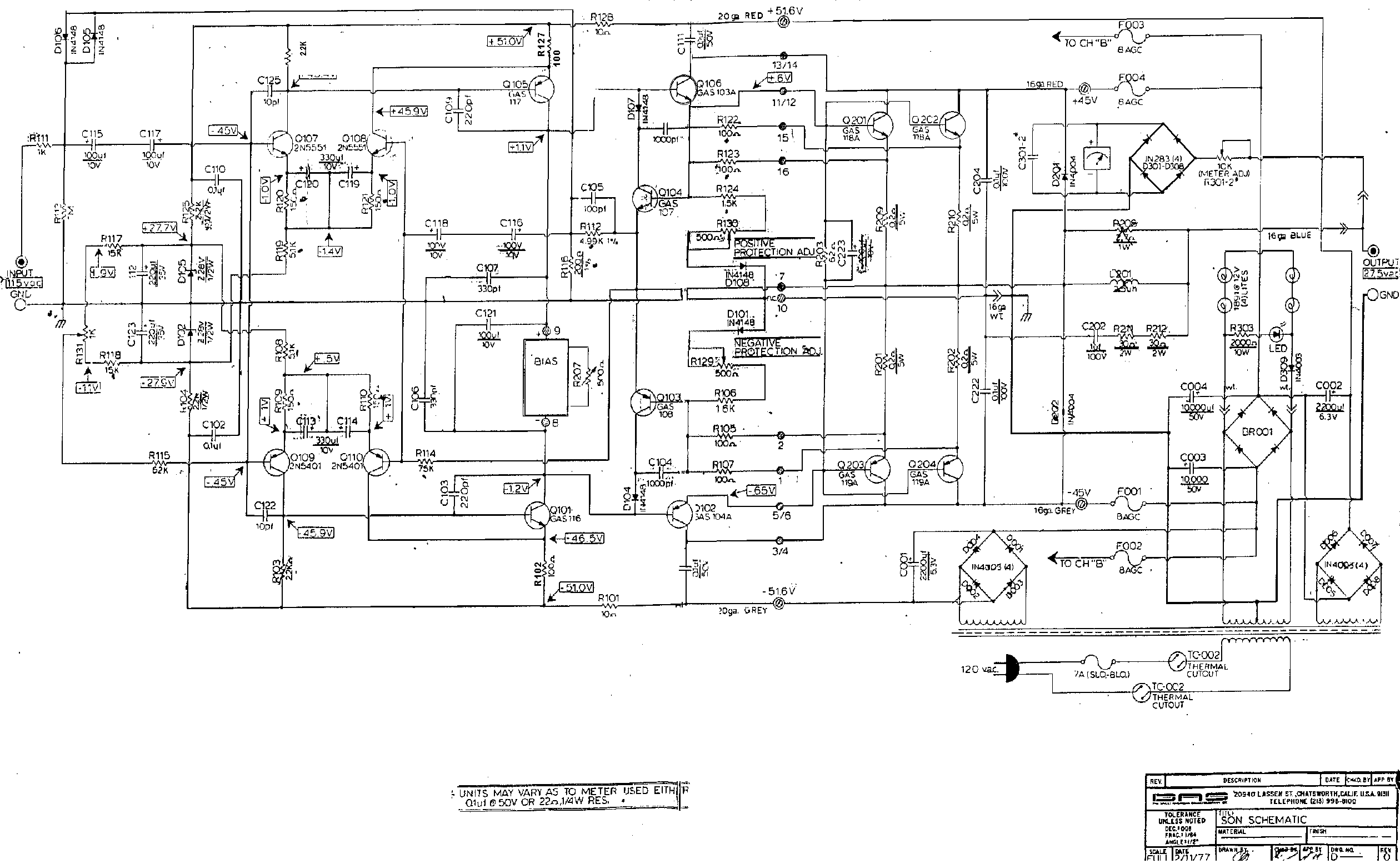

All I cound find on the net is that "marked" schematics. Would anyone be nice enough to get me some decent schematics, or even a service manual with pin-outs, etc? I know now how to adjust 0V on speakers and set bias @ 30mv on the output emitter resistors but the other pots are magic to me.

It wasn't clear from your post whether the problem with the channel was fixed by the cap upgrade and other work you applied or if it's still intermittant. If it is still a problem there are two common issues I see with this version of the drive card.
The most common is intermittant input differential transistors (or the connections to the transistors in the socket). A new set of transistors is always warranted at this age. They need to be matched but luckily the devices are inexpensive. I use low noise Toshiba devices but the original Motorola numbers are still available and normally have a pretty tight distribution, even in small quantities, so matching them is not a big hurdle.
The second common issue, which can act like an intermittant is the Fairchild TO220 devices used as both the voltage amps and the drivers. I change these out whenever I see them as they are a headache waiting to happen. Good numbers to use are 2SD613/2SB633. Both availible from BD enterprises (BDent.com). These original devices did not age well and will cause a variety of symptoms, with intermittant being high on the list.

I was looking at the schematics for a way to disable the limiters, is it enough just to remove the transistors Q103 and Q104? Or do we have to remove the 4 resistors (R123, 124, 105, 106) the diodes D101 and 108 and the variable resistors?

I remove the transistors and leave the rest. As for the replacing the output transistors, if it still has the original Toshiba 2SD424/2SB554s I use them as they are good and GAS matched them well. A quick check of the voltage drop across the .2 ohm emitter resistors to verify if the bias between the transistors is close (<5mv between all) this is a good gauge of whether or not to change them. The high speed transistors might need a different compensation cap on the voltage amp transistors if there is any tendency to oscillate. The current cap is 20 pf and I have had to go up to 100pf with the motorolas devices ElectroChap mentioned.
The hum can happen if the main ground screw to the power supply PCB/chassis is loose, or if someone has upgraded to new input connectors and used insulators for the jacks. The original design grounded the driver card through the connection of the jacks to the chassis. I see this problem fairly regularly.

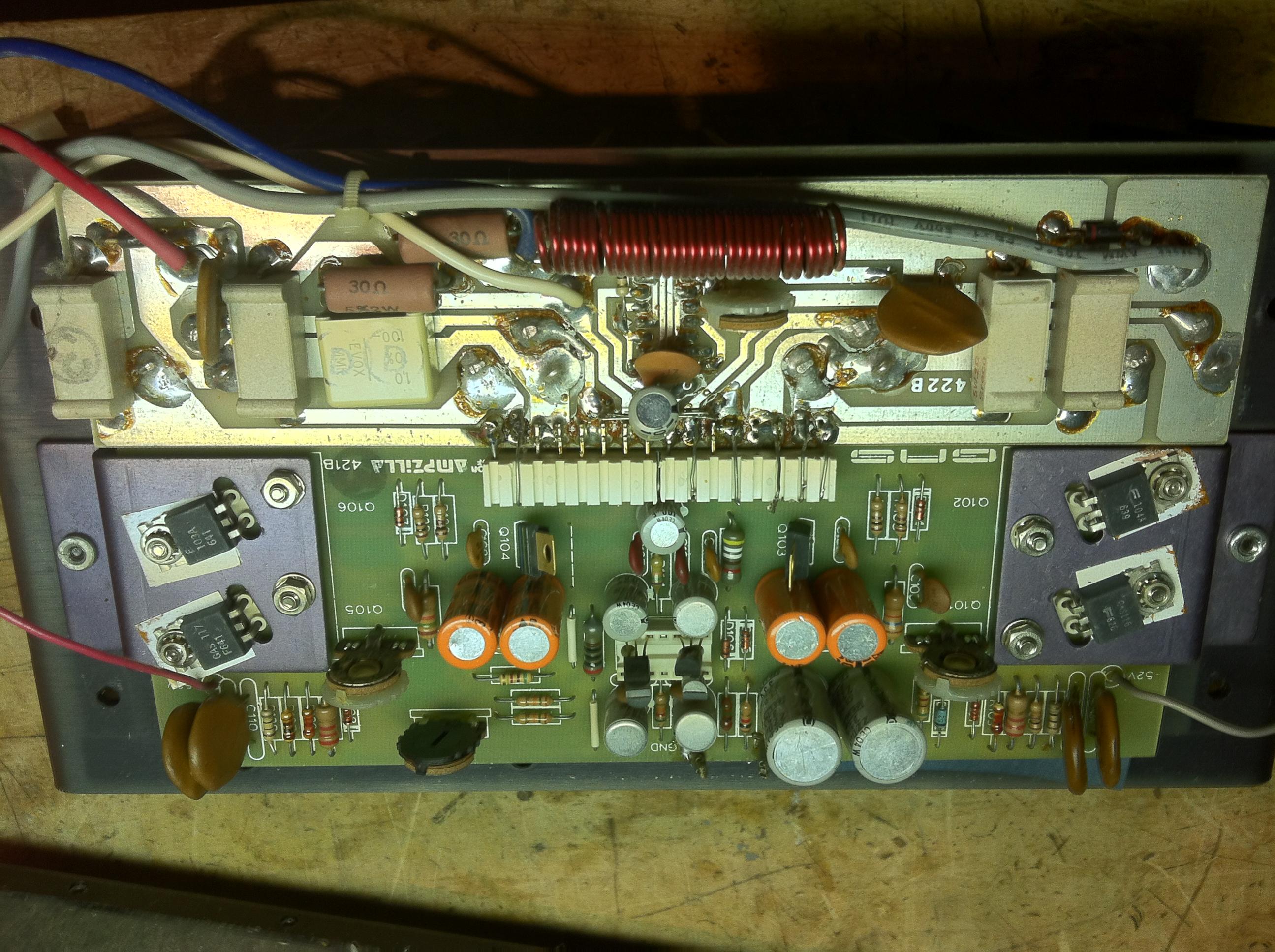

I finished the replacement of the caps, installed a nice power switch, moved the fuse inside the enclosure, calibrated the VU meters with a function generator and powered the SOA on... One channel is perfect, almost 0V DC on the outputs, the bias is a nice 30mV on all the resistors, everything fine. On the other channel, Ov DC on the outputs, but when placing the probes across any of the 4 resistors I have nothing, 0V! The supply is ok and I cant find any obvious fault in the circuit. Am I missing something obvious? Should I statart looking for new output transistors? The bias IC? This thing scares me a bit, since its impossible to find one...
Tomorrow I will test all transistors individually, but any ideas are very welcome.

My SOA is fixed and sounding great!
For those you need to replace the output transistors, please note that the GAS transistor cross reference has a small mistake.
The GAS118 is the NPN and the GAS119 is the PNP, use the schematics as a reference.
I ended up using MJ15022 and MJ15023 on the outputs with nice results.
