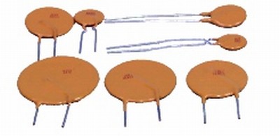

Based on the age of the amp, I'd be surprised if it has it's own inbuilt speaker protection, you might find however the speakers have some polyswitches in them.
If It's polyswitches the speakers will go off whilst the current is too high (due to the clipping), and once you reduce the current (in your case by turning down below clipping) they should reset after a few seconds and everything should return to normal.
This is what a polyswitch (in my experience) looks like, in case you are feeling adventurous :devilr: and want to peek inside your speakers.

when the speaker goes off after 2 or 3 seconds it comes back on again without any adjustment of the volume control... Polyswitches increase the resistace so the speaker is still on, but quieter... I BELIEVE this is whats happening, but it gets so quiet I can't see that it is just a polyswitch increasing the resistance.... when the sound goes off and comes back on after a few seconds, it then goes off again after a few seconds, and so on... 🙄
Maybe not. When my polyswitches cut in there is NO sound at all until they reset (although it's a long time since I have witnessed that and I may have had a few drinks at the time so this account may not be so reliable 🙂
It sounds like some sort of protection mechanism, but whether it's in the speakers or the amp is hard to say. I guess you could borrow an amp from someone else and crank it to see what happens 🙂 Of course if the protection is in the amp, then maybe you will fry your speakers........

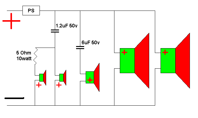

they only both go off when both channels hit clipping point... ok.. I tried a different amp and the same channel still goes off... they have polyswitches in them and for some reason one triggers more easily than the other... while I had the boxes apart, I drew up the crossover circuit.. 😉
Now... we much note that the speakers have printed on the front:
Crossover Frequencies: 48Hz... 1,500Hz... 7,500Hz... 10,000Hz
and now for the circuit... heh... I was feeling ARTY!! 😀

The other thing you could do is use a separate polyswitch on each speaker (although with the number of drivers you have shown that could be a tad expensive), after the crossover components, then you use a small one for your tweeters and bigger ones for the bass drivers, should get better power handling, you'll probably find that with one only, it's been chosen pretty conservatively.
The other weird thing is that there doesn't seem to be anywhere near enough component's to give you that many crossover points, I guess the other thing is that they are pretty much (from my limited knowledge of xovers) only 1st order xovers. Looks completely cheap and nasty to me (sorry)...... Is it worth spending bucks on making better ones?????? Certainly it should be possible to make the speakers sound better than with xovers like the ones you depicted!
Tony.
EXACTLY!!! how does one obtain 4 crossover points with only 3 components.... :bigeyes: anyone? someone? hello hello..... 🙂 heh forget it... I am making some towers that were going to house one peerless 8inch woofer each... BUT!!! considering that with a suitable tuning frequency to get a flat response in a large, 60litre enclosure, the power handeling at 40Hz is only 15watts before they reach X-max... 🙄 so.. instead I am putting two 8inch venom subs per box.. 🙂 which makes it MUCH louder and lower.. 🙂 and a much more realistic power handeling... and... not much more expensive than the peerlesses.. 🙂
