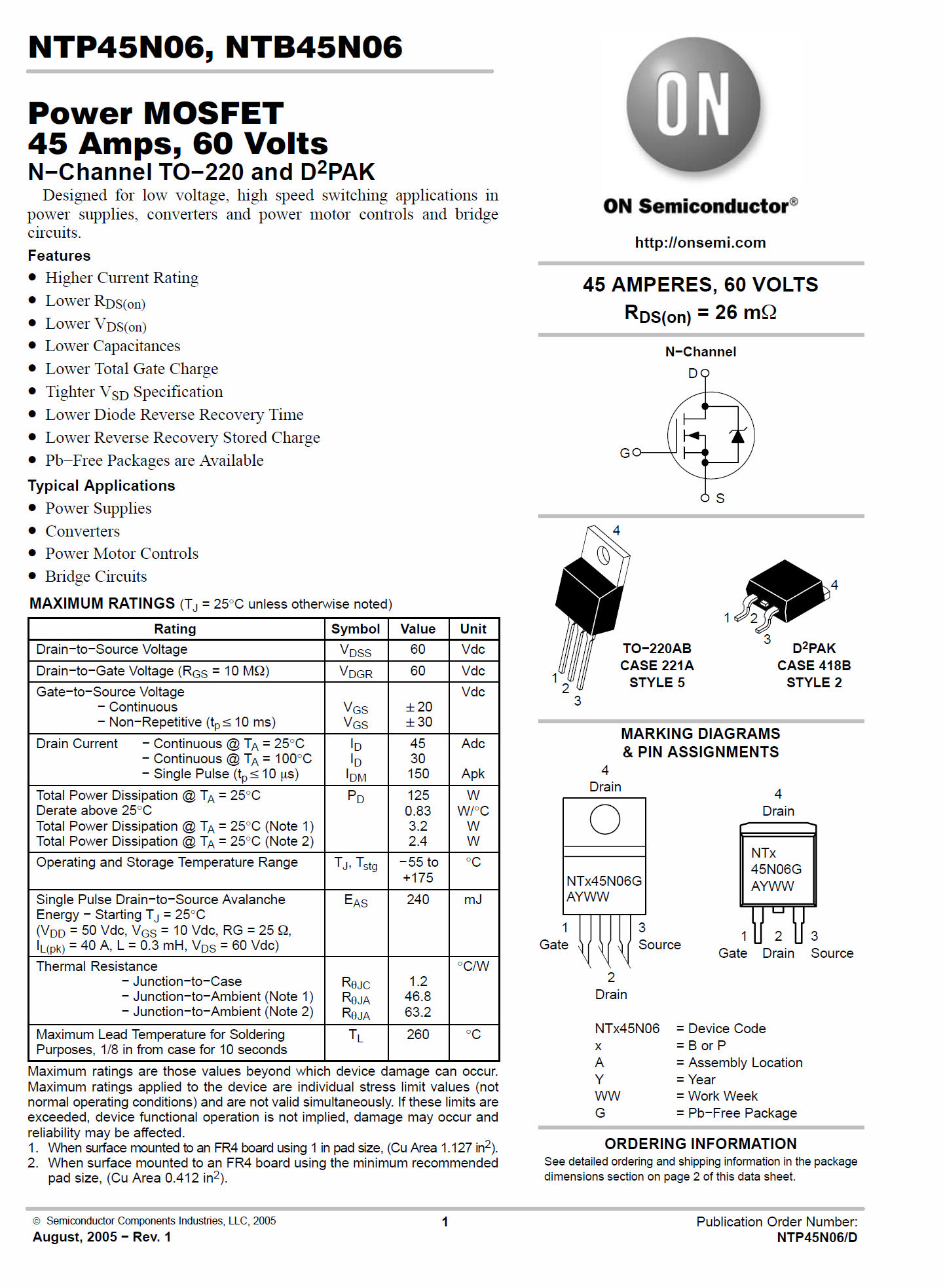

out of the 4 ps fets, this one is the most readable, ntp45n06, but on the schematics it lists board designation number "q6"

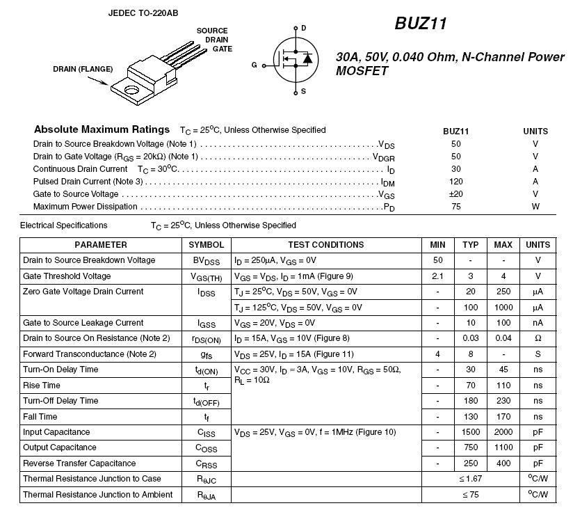

SS-236
BUZ11
the three caps that are on the supply side are 63volt, in paralell, so 189 volts. divided by 4 mosfets in series, equals 47 1/4 volts.
holy crap i think i just learned something.

yep, im a idiot. It was early and I was trying to find a replacment part, because the one i think i need got discontinued in 2001.
Thanks for the help.
