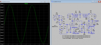

I plug in 490 ohm, distortion wise OK, but it's does not look like RIAA curve of +-20db over 10hz-20Khz. Are all other components value correct? The response should go down slope near 10hz, not 1Khz.
Hi Koonw,
I think your model has 12AV7 tubes in it. The circuit in question will be using 12AV6, which is pretty much identical to a 12AX7, but in a 7-pin mini bottle. That might be why the EQ in your model comes out so far off.

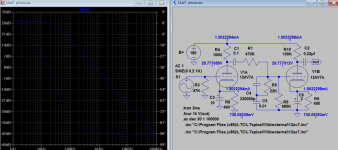

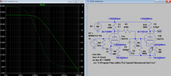

I tried 12ax7 which has nearly same mu and rp is the same slope. So if I increase C4 by 100 time (1000/10=100) from 3300p to 330000p, this is getting closer to RIAA curve.Hi Koonw,

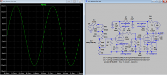

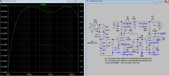

I'm sorry I made a mistake in C5 should be 0.01uf not 0.01f. So here is the full sim of original RCA phono amp. And sim model, if you spot any other error let me know.

I'm sorry, I think there likely is a problem. The input impedance of the pc's line in is probably low, like 10k. That will severely load down a 6AV6/12AX7. Much reduced gain may be causing noise. Some kind of buffer or matching transformer is desirable here.

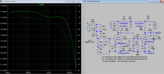

Koonw, can you substitute a 10k resistor for R2, and show us the results? That will simulate how this circuit will react to driving a low impedance input, as on a PC sound card. Keep an eye out for what happens to the gain.
Here are the results. Overall gain drops by about 13db more below 15hz, 1Khz gain drop from 70mV to 15mV but distortion remains same as ~0.05%
