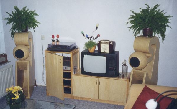

Sorry to say those horns are not mine. I first saw them many years ago on Thomas Dunker's horn pages. They were made by Peter van Vegchel out of mdf. He can still be found online, but has apparently moved on to larger speakers.

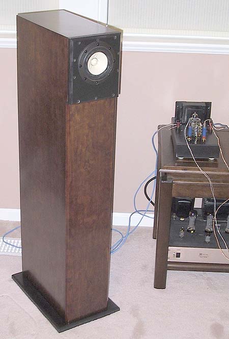

Ok, I've decided. I'm going with the 108 in the Buschorn. I think it's the most flexible option right now, since I don't know exactly what I'm getting into, and since my wife is bass-shy and has more acute hearing than me, I will concentrate on great midrange. I really need her to buy into this before I can pursue this as a hobby. Once I get the drivers, I will play around with some prototypes first and see what happens. Who knows, maybe I will stumble onto something useful (which is usually how I get things done around here).
