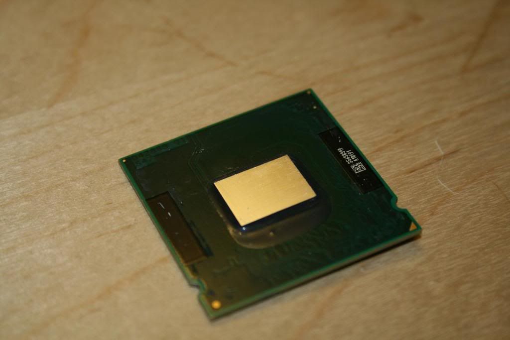

In some casewatercooling can yield asonshing results. I have personally rigged 2 audi tt radiators to passively cool an extremely overclocked CPU (putting out heaps of heat)
The heat is generate by a very small die which can put out several hundreds of watts of heat
(my e6600 with the HIS removed)

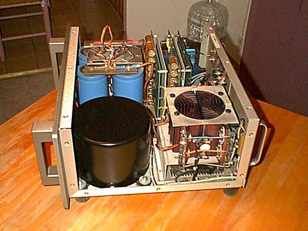

Mr Pass states in all his Aleph manual that best performance is achieved after the temperature reaches a specific level and is "stable". This can take up to an hour in the biggest builds (like aleph 1.2 ecc)
If it is then I understood you correctly the first time..

IMHO it's a good idea but I like my amps silent, not quiet but 0 noise from them. My other hobby is watercooling and modding comps but that stays with comps. Noisy complex case builds stay with comps silent elegant and simple stays in audio for me!
May latest amp build, will be three Wire amps at 300W a channel. (only want that power for dynamic peaks not continuous before you get on my back andrewt for the size of my sinks!). Home made of course!

My personal experience: I owned a pair of Krell KMA100 100W Class A monoblocks which use a small fan driven at a reduced voltage(fig. 1). To avoid any direct sound path to the listener the fan is horizontal and very close to the floor. The KMA100's are very sweet sounding high powered amps that proved to me that GREAT audio was possible. BUT...BUT...BUT... I COULD ALWAYS HEAR THE FANs, even when they were 20 feet from my ears. Because of fan noise I had to sell the musical KMA100s and bought Krell KSA250 passive cooled amps as a replacement. The treble on the KSA250 was a little harsher than the KMA100, but NO FAN NOISE was more important to me. When the KMA100's were idling between CD's my wife would often say, "what's that noise?...is that on the recording?" I will never own an amplifier with a fan or a water pump. For DIY, there are excellent passive solutions.

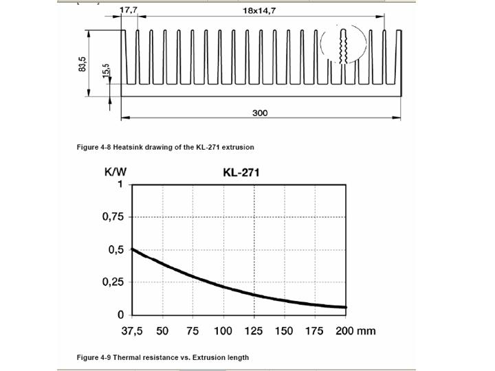

Heat sinks like the KL-271 profile can provide under 0.25 C/watt. It helps cooling to also use a large aluminum bar across the backside of all transistors to both provide even pressure against the heatsink, and also a second cooling sink.
