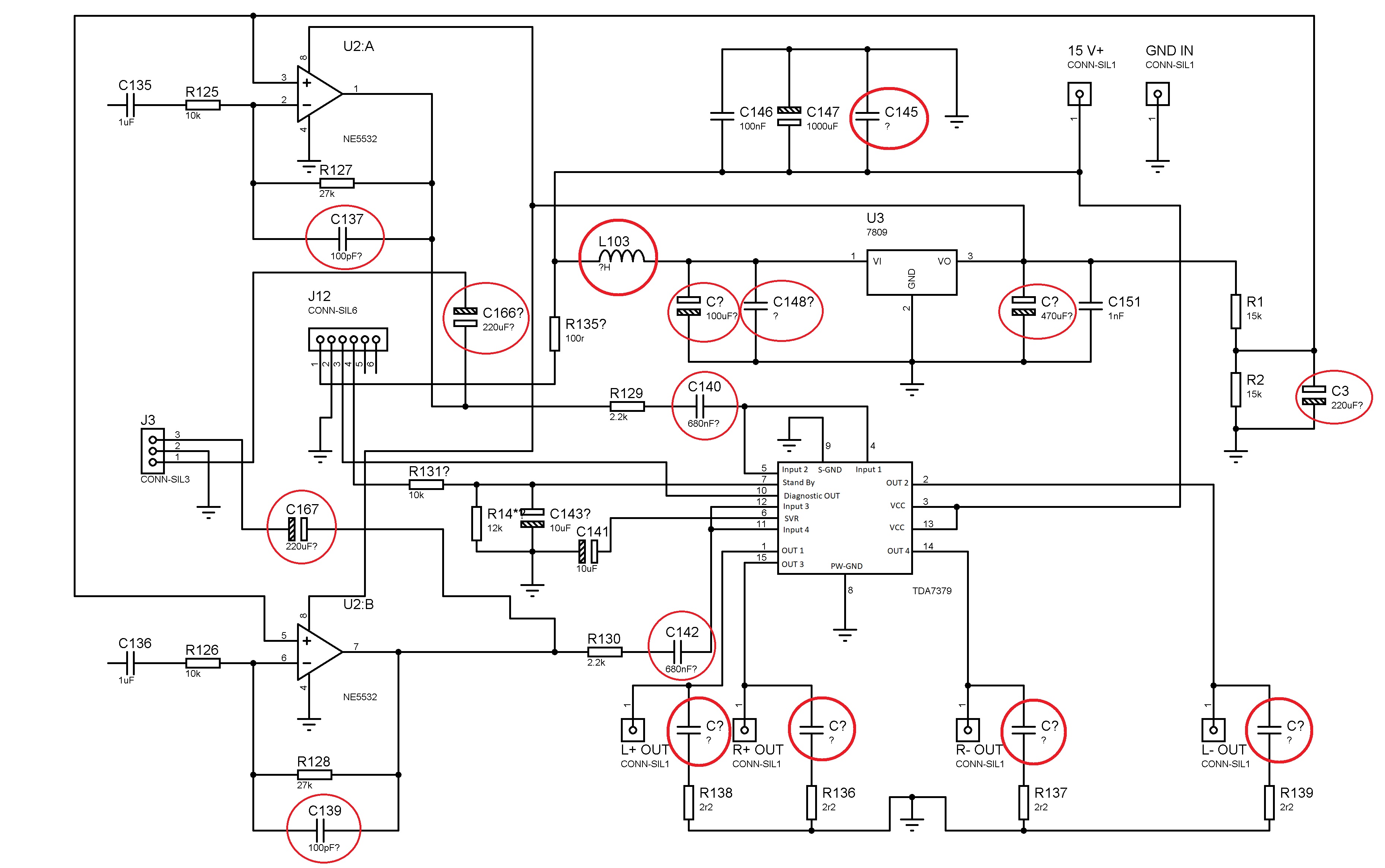

So what values do you think are the ones missing here? The ones that has values but with "?" are values I can almost read from the photos but I'm far from sure. The last caps are from a zobel network I think, and I will use initially some old Grundig 4ohm speakers, but then I will use others too with different values (originals aren't specified but they have a 6.5" 4 Ohms midwoofer and a 1" 6 Ohms silk dome tweeter, and testing with a multimeter gives me around 5 Ohms resistance). Also what modifications should I make given I will not use the stand by, mute, and diagnostic features? In the datasheet the standby is connected to something, what it is?
"J3" goes to headphones exit, "J12" to the front panel bard where the processor, display and controls are, C135/136 are connected to TDA7303 outputs I guess (can't see the traces there as they are under the chip).

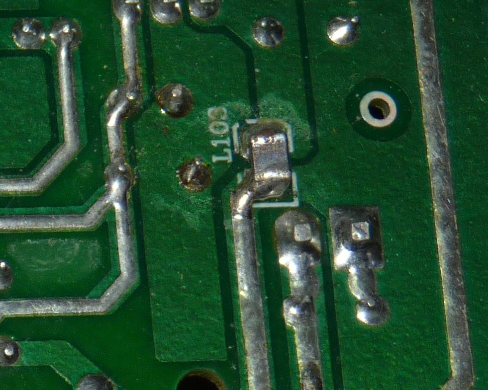

This is L103:
What value could it be? How do I do it myself?

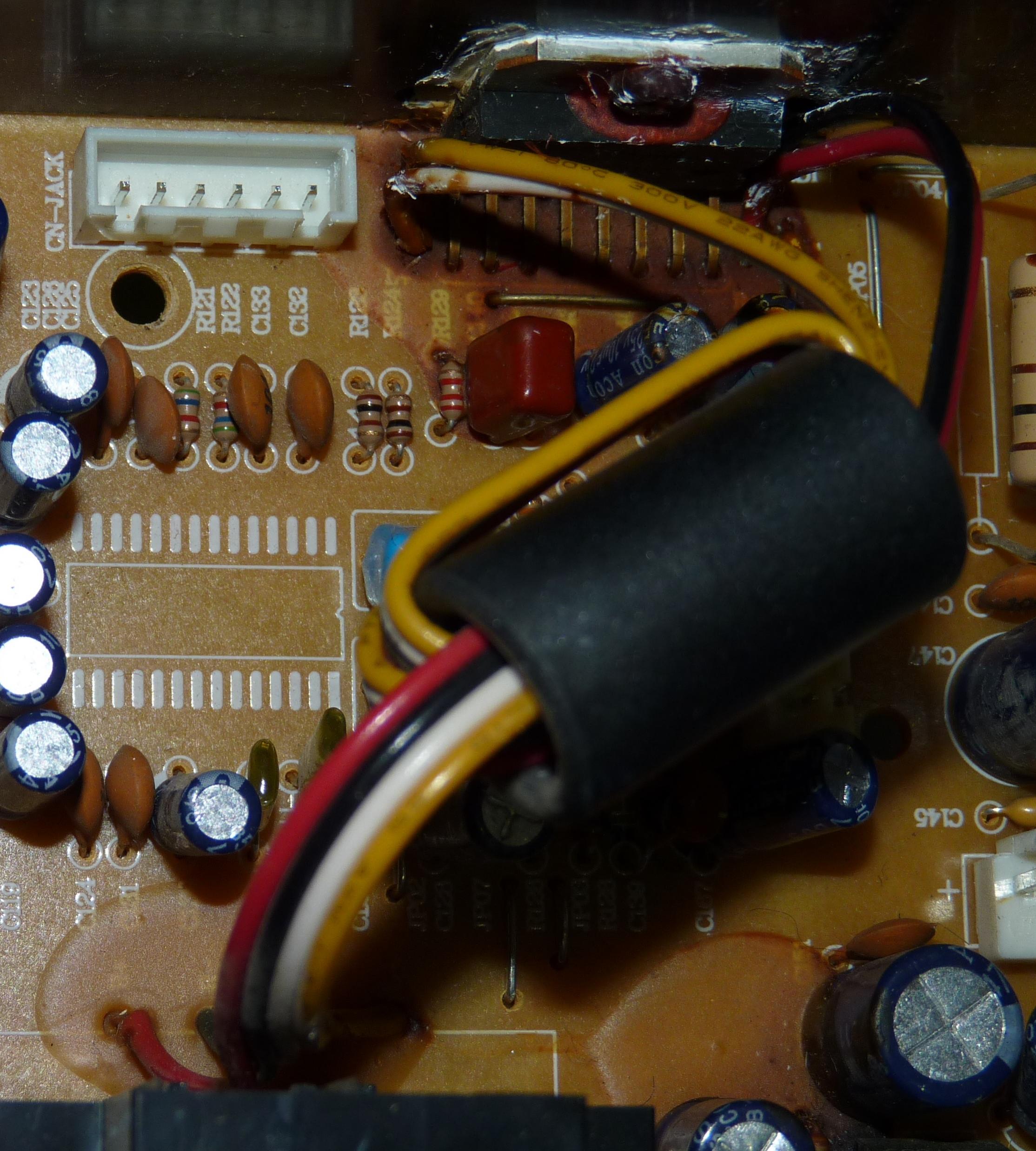

Also, not in the schematic there's a sort of coil made with the cables from the TDA7379 to the zobel network and speaker output terminal.
Is it a coil? What's the purpose? How can I get away with that if I don't find a similar ferrite core (if that's what the cables are wrappled around on)?

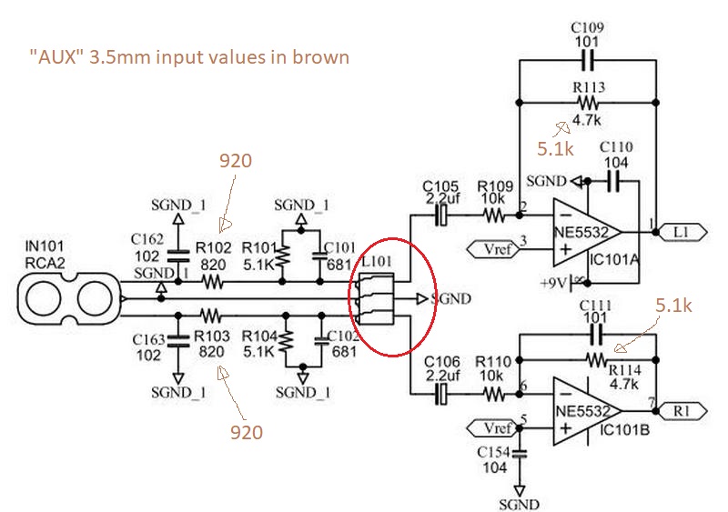

Then the input stage, which are two actually (PC, RCA: 400mV ± 50mV / AUX, 3.5mm: 350mV ± 50mV, 10k input impedance, according to specs), so I added the auxiliar values. The difference seems negligible in use, both sound almost the same volume. This is an official schematic I found of it. As probably it's designed to work with the TDA7303, and thinking about it's low sensitivity (high power needed in input or risk low volume with cell phones and PC onboard soundcards) and given I will probably add a Baxandall tone control, what modifications should I make?

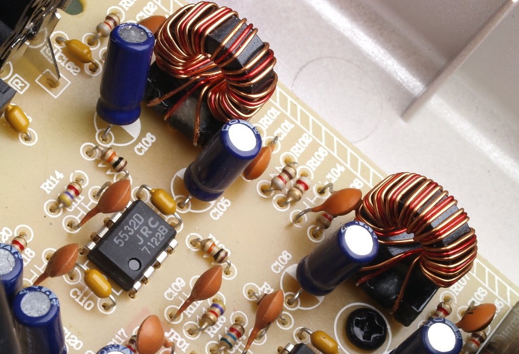

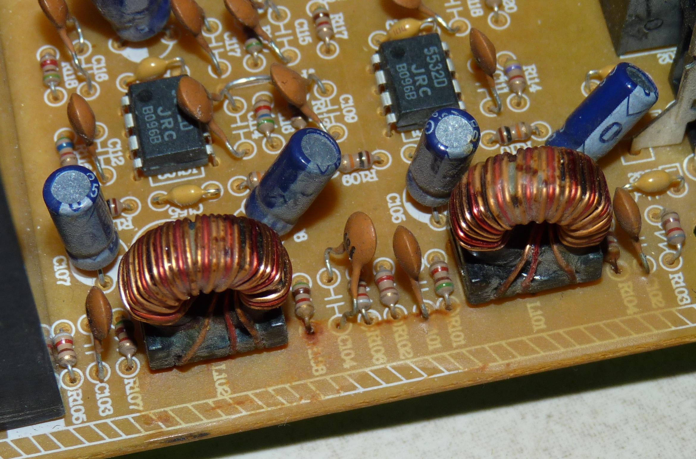

As you can see in the red circle, there's a coil there which is this:
I guess it's a HF filter, right? What value could it be? How do I do it if I find a similar ferrite core and if I find different ferrite core?

The capacitors in series with resistors 136-139 form part of the Zobel network and are for load stability issues a 100nF 63v capacitors should work fine
Thank you! But will it work with 4 to 8 ohms speakers the same?
The three windings coil is a common-mode filter.
Thank you! Reading about it I see that I guessed right. But why I never see this filters in any preamp desing?
You see that type of filter if the designer knows that there is a problem or the designer finds it likely that there may be a problem. If no problem is foreseen, you don't add a quite large and relative expensive component. It is the first time I see it in this place. Perhaps it helps against ground loops?
And what about radio signals? I live next to a big radio antenna that mess with all I do, and this amplifier is inside a plastic case and it's completely inmune to that and to, apparently, anything else here. On the other hand I don't know if it would be a problem otherwise...
The designer clearly was very keen on keeping RF out and used the medieval fort approach. 1 nF - 820R - 680 pF makes for quite a lot of input capacitance. Apparently they had conditions such as yours in mind.
I am not exactly sure why the input stage has a -6 dB gain (not to mention input impedance of only around 3.3k), the TDA7379 only has 26 dB of gain in BTL mode. Perhaps they have some input gain active in the TDA7303 or didn't want to risk clipping its input with CD level signals. That chip's datasheet is a bit mystifying - it shows several graphs with a volume setting of up to +20 dB when the thing only has a +11.25 dB maximum input gain and no output gain. 's a pretty neat chip for micro systems and the like otherwise, with output noise levels that are easily hi-fi worthy and distortion that isn't quite so. Apparently it's a TDA7318 (now obsolete, dated 1999) with fewer inputs. Yeah, I did think the datasheet and performance had quite the '90s feel to it.

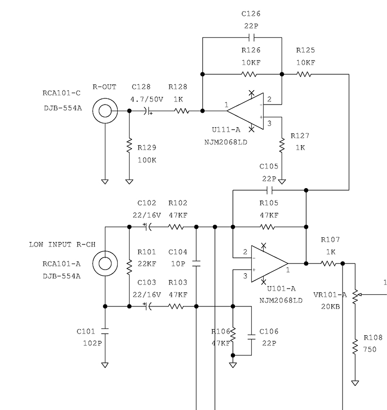

Yesterday I was looking at car amplifier shcematics (I'm interested in the crossover/filter section) and saw that they had what I think they call "differential balanced inputs" that apparently serve a similar purpose if I undertood that correctly. Should I better go with that simpler approach? Will it work for radio frequencies?
("LOW INPUT R-CH" of course)
