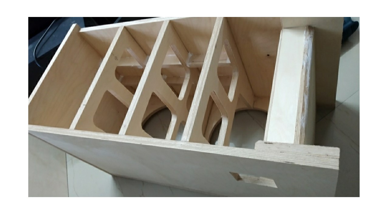

Hi All,
I made a ported sub with dual 12" drivers.
(Please see the attached image)
Some people are saying that much bracing is not needed for ported sub. I used 18mm britch ply for the box, with double layers for front baffle.
1. Is it necessary for the box to be completely inert for a ported sub??
2. Does the box walls really resonate with frequencies below 100Hz??
3. If I knock on the box it sounds different, with and without bracing. So the bass also sounds different with and without bracing ???
4. Assuming the port is tuned properly to have a flat responce, and smooth rolloff, does the bracing help further for clean bass??
Any suggestions will help a lot !!!
Thanks in advance...
With sub woofers, easiest way to deal with cabinet resonance is to stiffen the enclosure with bracing so that the enclosure resonances go up in frequency, high enough not to be in the sub woofers pass band and thus out of mind. So 1) no.
2) Maybe, walls resonate on some frequencies. Stiff bracing doesn't eliminate cabinet resonance, makes a resonance higher in frequency dividing panels into smaller surface areas. Dampening would reduce resonance in level.
3) You'd have to build two identical boxes, one with and one without bracing and arrange a blind listening test with help of a friend switching between the subs to determine if there is audible difference.
4) Yes if it makes audible cabinet resonances not audible 🙂
Too much bracing is just more work and more weight. More weight can benefit, if the woofer wants to walk. Cheaper and easier to build solution would be to put the two woofers on opposing sides of the enclosure and let them cancel out even more cabinet vibration, if aesthetics allow. Less mass and bracing needed this way I think.
There is tons of info on the forum and on the web if you search. My terminology might contain errors. In general, add some bracing, no need to go overboard with subwoofers. If two speaker elements, but them on opposing sides.
Diagonal braces, (preferably glued with elastic glue,) will be more efficient in stopping plate resonances, since triangular plate sections have no natural resonances.

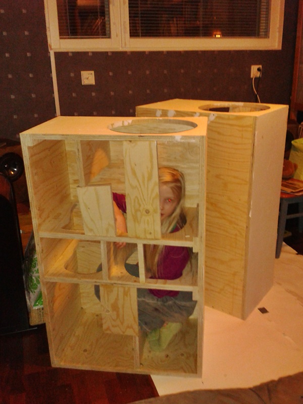

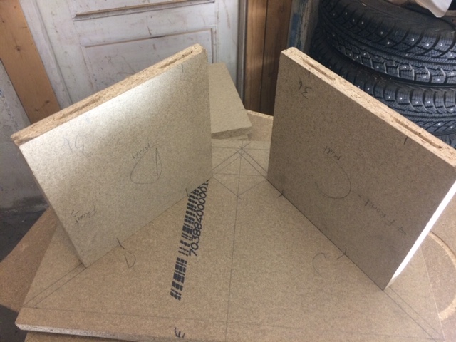

By the way - a bisquit joiner is a very nice tool for asembling internal braces. In the box in the picture, I only used screws for the stiffeners along the top and bottom plate. All the rest was done with the bisquit joiner, glue and clamps.
Johan-Kr
