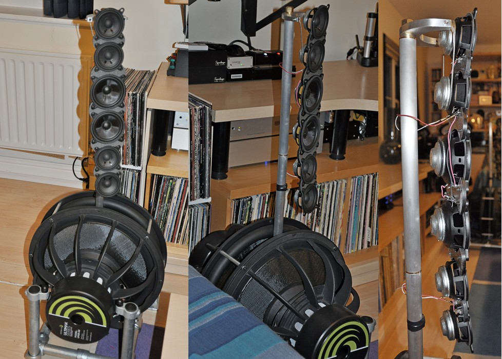

You are exactly right on many of these points. That is why I have arrived at this design.......

That is cool.
What are you using for EQ, not just as far as passive vs active, but - do the drivers get any correction for OB cancellation, or is that part of the transition to the SLOB like woofers? I have a few Alpair 5.2's on closeout sale when the 5.3 came out
Woofers are actively driven using dedicated DSP amp.
There is no eq applied to array, apart HPF @ 200hz.
OB bass roll-off is compensated for by appropriate woofer cross-over.

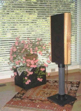

So, i am also playing with OB, I agree with you, if i ever do it i would have grilles, perhaps like these, here attached is SL phoenix (copied from website and credit given here!) with nice simple cover, could be front and back in the same style even if this is not!!

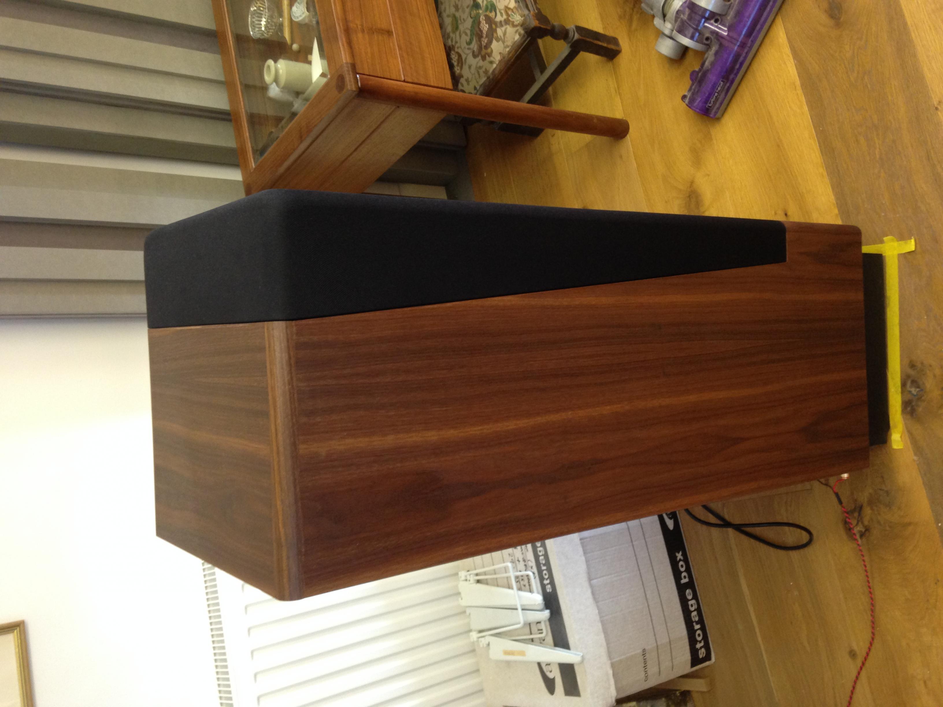

Now i have built what i consider is a really nice sounding speaker, Troels Gravesen designed Fusion BAD, another pic attached and they sound very nice, so in Covid lockdown, the works of the Fusion have escaped and been set up as an OB experiment, mid and treble on the passive crossover and bass bins with the Hypex, with help from Fluid, poster on here i have set them up and they pique my interest to see if i might build OB to achieve the magic that SL describes, but actually the Fusions can also be difficult to beat...
Here attached a pic of the current state of the experiment, definitely has some appeal as an open sound, not smooth and integrated like the Fusion, but that's not surprising.

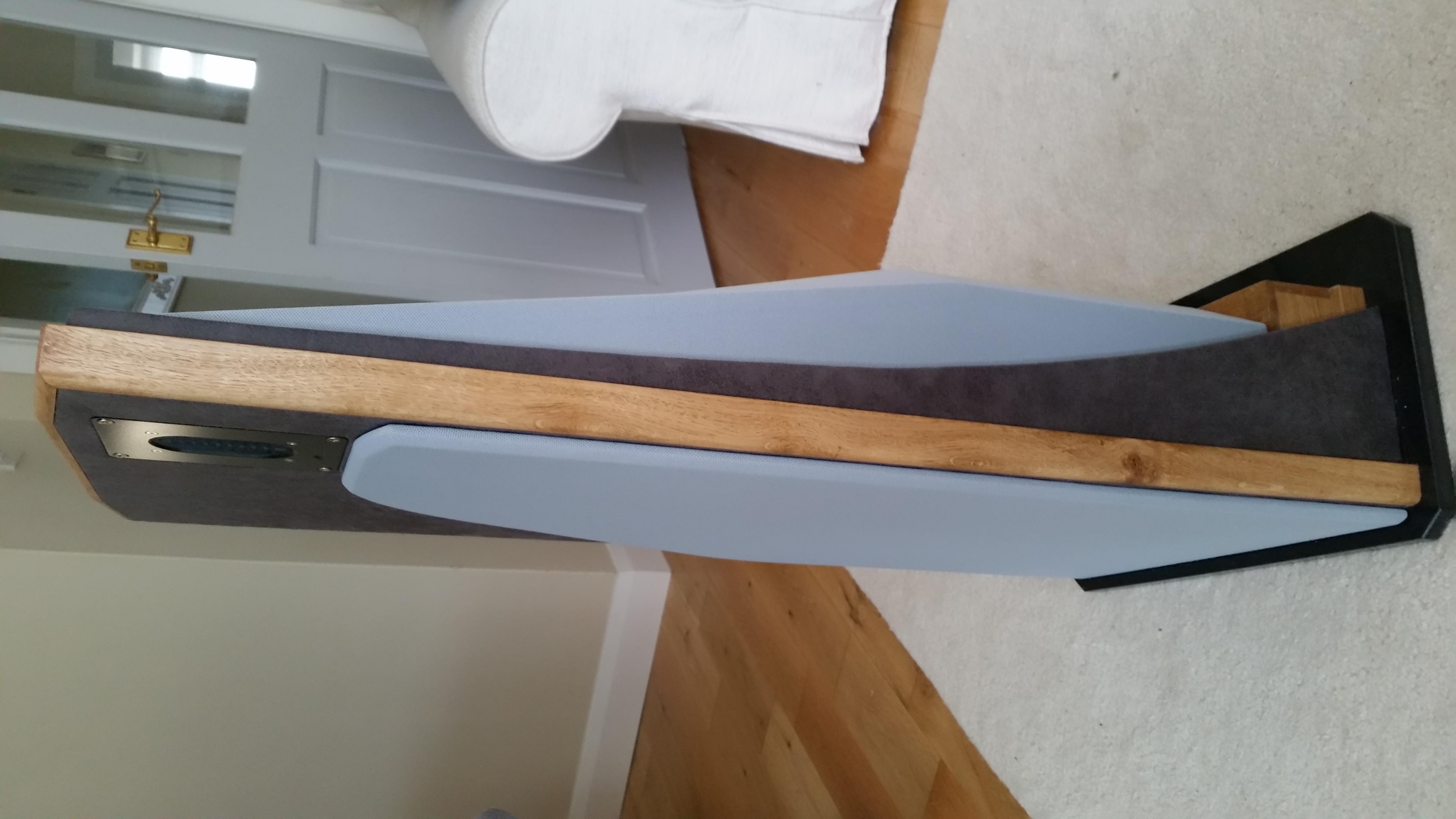

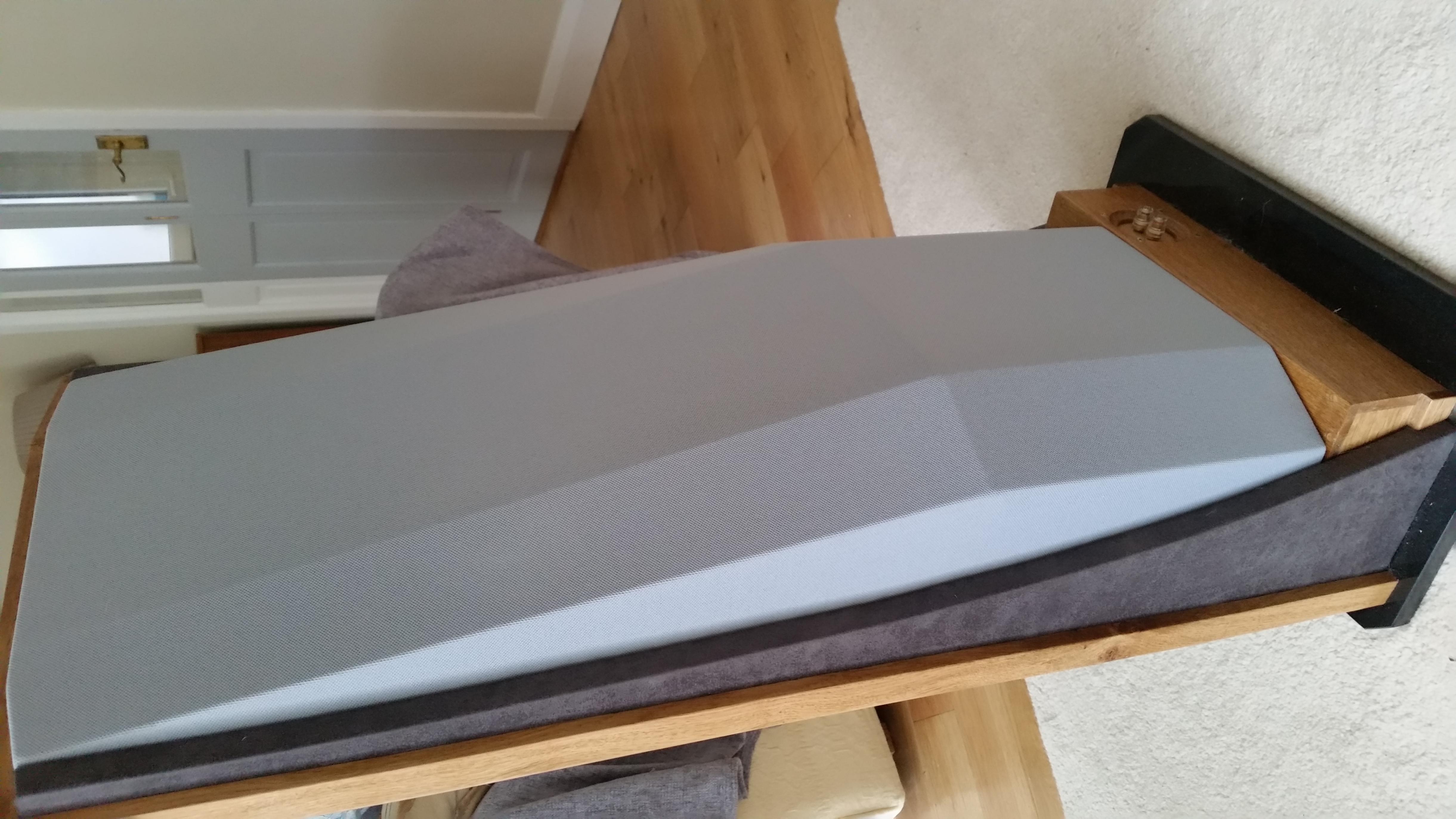

1) Why do people keep the back of their open baffle speakers exposed? I am considering wrapping acoustically (very) transparent material around a simple think rear frame to create the visual effect of an enclosure. This would hide the 'ugly' parts from the wife, protect the drivers from prying fingers and protect the drivers from a build up of dust. The fabric layer would be easy to wash or to replace. Yet I have not seen a single person do this.
Well, now you have🙂 They were time consuming to make though.
Oh, the front panel too! Good job and thanks for sharing. 🙂
