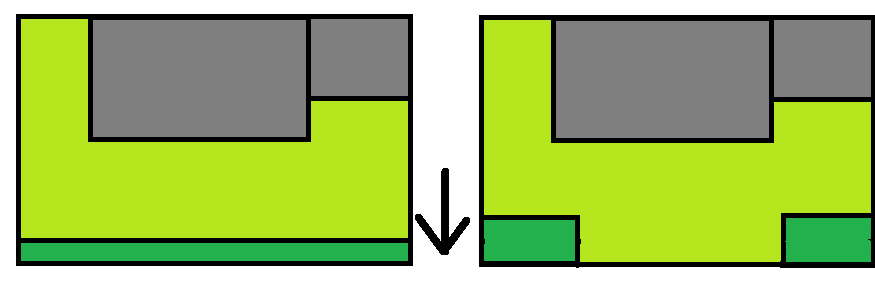

Just to show why i am kinda unflexible to rebuild the box... i got the green area for the box, while the grey area is used for other sstuff.
Thats a view from top on my driver's cabin.
I have no problem with overengeneering... i am allways doing that 😀
The question is just... could it help more, then it would make it worse? If the answer is yes, i might do it.

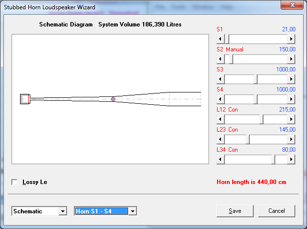

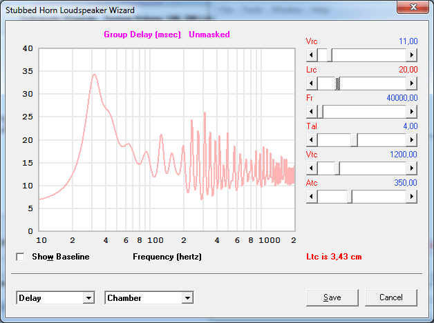

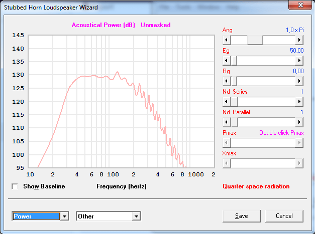

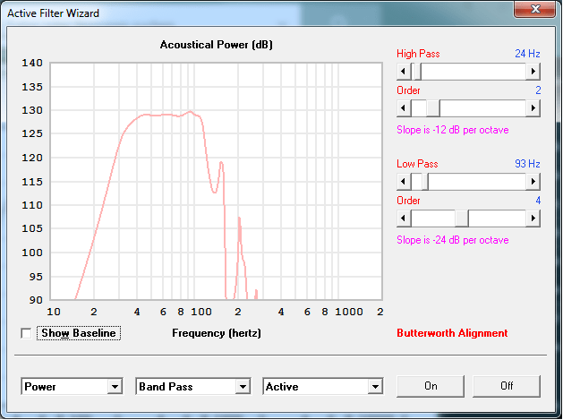

I was simulating a lot more in the last days, and came up with something nice (at least in my eyes), and need your opinion about it.
It is a stubbed horn, here are some pics of the simulation:
I got a few questions related to that:
- What do you think about it? will this be usable?
-> The cone movement should be ok like that... i did not use any high- or lowpass here...could i use it WITHOUT any filters, like it is?
My idea here is to adress the delay, wich filters produce... i think i could come up with some similar or even better delay compared to a BR-Box wich uses filters
- At wich frequenzy would i crossover, and more important...how does the crossover work with these delays/phase changes?
Thanks for your help
