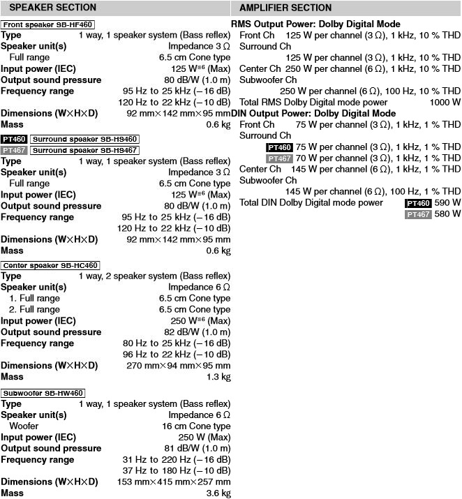

First, look at the speaker specs closely. If they say 125w peak or max or something, then the speakers do not really have a 125w rating. Look for terms like continuous or RMS or noise ratings. They will be more honest.
My car will do about 132mph...if I drop it out of an airplane. But realistically, it will drive about 80mph. Speaker makers pump up their specs to look more impressive.
Hi yes you are right, they all say max rating. So is that bad?
Here are the specs..

Erm I forgot to mention in my last post that I don't have the amplifier that is stated in the picture I uploaded.. but the speakers were part of a home cinema system and those specs are from its manual. Would just edit my post.. but it is still being moderated!
So what kind of wattage should I be aiming for with them? Only in a 12ft by 10ft room so don't need to rock the house with them!

TBH it could be a lot of trouble. You don't know what active EQ
and active x/o's were built into the systems original amplifier,
and common nowadays, any dynamic processing/limiting.
There is a reason the speakers were cheap, they are pretty
much next to useless without the original dedicated amplifier.
You could try 3 class D stereo modules powered by DC bricks.
2 of the them would be the generic 20W / 4 ohm type and
one of them higher power, a 40W / 8 ohm type.
Personally I suspect its going to be more trouble than its worth,
compared to simply buying an off the shelf 5.1 computer system.
rgds, sreten.

Hi there.. They are Panasonic. Here is the product. Panasonic SC-PT460 5.1 Surround Sound reviews, prices and deals: Home Cinema System
