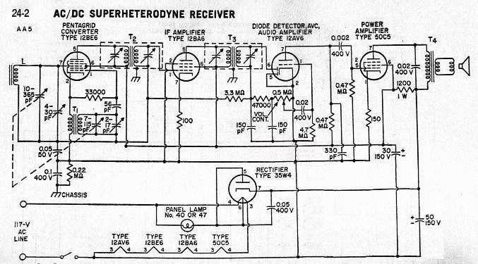

Hmmmm, given the tubes you're listing, the other two are probably a 35W4 and a 50C5. The 35W4 is a half wave rectifier tube and the 50C5 is a power amp pentode (beam tetrode?)
It's easy to tell the 35W4 and 50C5 apart by looking at their internal structures. The 35W4 plate will be smaller than the 50C5 and "hug" the cathode more closely.
If you are motivated enough, you could probably build a mono power amp with the 35W4, 50C5, and the 12AV6 (hope you saved the output transformer). You won't need a power transformer, but you will need to drop the line voltage to the heaters 22 volts (assuming you're using 120VAC line) so use the appropriate dropping resistor. You won't need the two diodes in the 12AV6; these were used for the detector and AVC in the radio and won't be needed in the amplifier. I'm attaching the schematic for a radio that uses these tubes so you can study the amplifier portion and perhaps hack the design to make your amp. Good luck.

Dangerous circuit
You should not build an amplifier without using an isolating transformer of some kind. The schematic shown above is an example of the classic non-isolated radios that were built back in the days before transistors. This approach is fine for a radio or TV set that can be placed in an insulating box (wood or plastic), and does not need to connect to anything else. To connect to an external signal source you need to expose the internal "ground" as part of the signal input. There's a 50-50 chance this terminal could be the Hot side of the AC line and will electrocute somebody, probably you.
