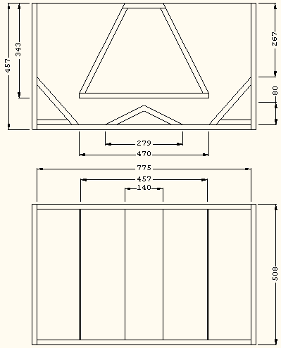

http://zmatek.jinak.cz/diy/pbaudio/w-eliminator/show_construction.asp.html
(Yeah, the plans are dutch...but the front elevation and plan view are there with all the measurements)
So for the subs then i've chosen the W-Bin design, and from what i've figured so far - its an old design? In any case would two of these loaded with Eminence Beta 15"s do? @ 8OHMS each my Hill DX1500 will power em' good! I'm using a Behringer Super-X Pro CX2310 crossover to split the signal at 250Hz for the subs and i need them ideally to go all the way down to 40~45Hz. Here's a link to my drivers with all the T/S:

I'll just caution that W-bins are designed to be used in multiples,
the bass performance of one a side is likely to be very dissapointing.

The expression W-bin is used for both - a class of single-folded cabs like the one you posted - but also for a specific model which is significantly larger than the whimpy one that you posted.
There were designs with 1x18" or 2x15" (the 18" being the original AFAIK). It was a hybrid design using a single-folded horn like you posted and some reflex loading below.

W-bins are essentially a very large cabinet broken into pieces
for transport. Bass extension essentially depends on mouth area
and so AFAIK 4 cabinets will go an octave lower than 1 cabinet.
That is the mouth area of one cabinet is too small, the total
design only makes sense considering 3 or 4 together.

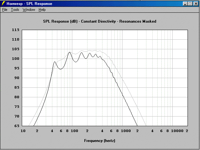

I have tried to attach a picture of a simulation of the horn i mentioned earlier with beta15.
-As a reference, the gray line is jbl 2226 in the same cab.

Thank you, electroaudio! :angel:
That will be my solution, that is if i can build that thing!
I'll the ******* in and try and flatten out the reponse with my eq. I've got an SPL meter so this will be possible, i dont know what the results will be like however it will get the job done, and i'm sure the new system will sound better than my old one: 2x AC Euro AC115's for full range. Yuck :dead:
I'll build 2 of them complicated horns and then in 6~7 months i'll stick a real nice driver in them! Whats the ideal driver for them? Lets hear yur suggestions. The JBL one you modelled in Hornresp?? :cannotbe:
Thanks for your help!

The driver the horn was intended for in the beginning was actually EVm15L. Its response is almost identical to jbl2226 and i suspect that most drivers with the necessary specifications will be similar too.
- But if you go that route, then a test in hornresp is a good idea just in case...

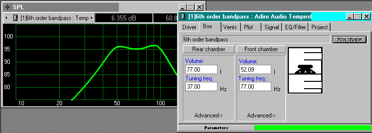

You could cheat,and use an average car audio 15" on a 6th order bandpass box,boosting the efficiency between 50-100hz up to the same as a pro driver.
