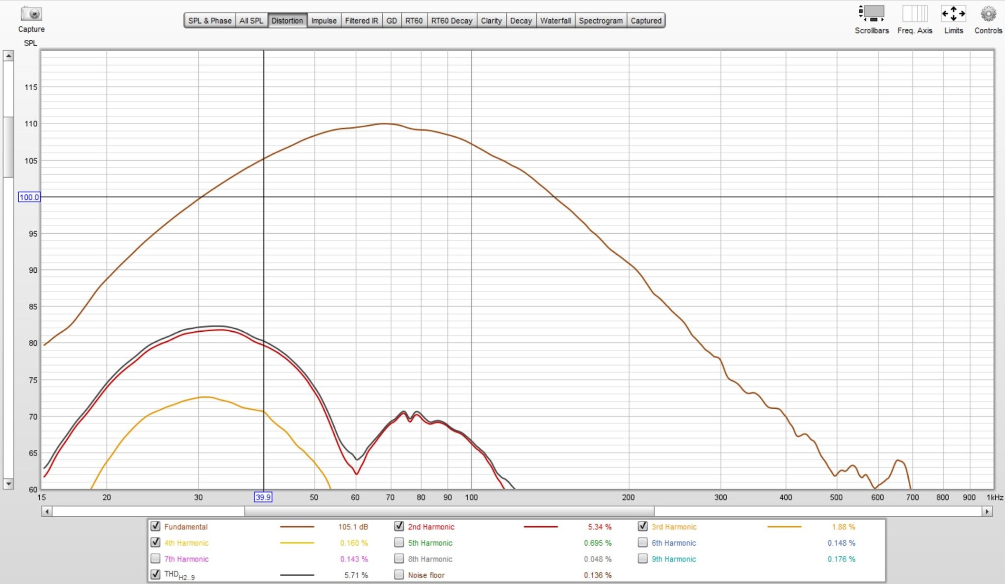

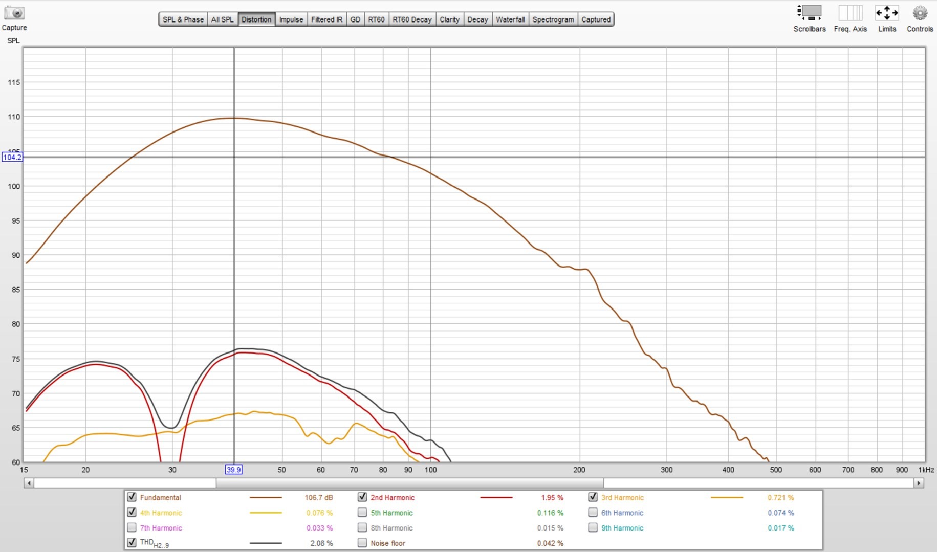

Here's a few driver distortion measurements I made today
These aren't terribly scientific, but if they help someone out, cool! I just set my amp to -3dB and measured each driver at the same amplifier level, which isn't necessarily the same SPL level because the impedance of these drivers is all over the map
I used a 15Hz highpass and a 120Hz lowpass, both LR4
I used no baffle; this is just the raw driver
First one up is a measurement of a twelve inch Infinity woofer from the Infinity Prelude speaker. These are readily found on Craigslist for a few hundred bucks. I trashed mine (all of the mids and midbasses had surrounds that were trashed) but was pleasantly surprised by how capable the subwoofers are, despite looking fairly pedestrian

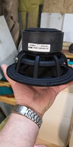

Here's a DIYMA R12. This was a super affordable twelve inch woofer made by npdang over at DIY Mobile Audio almost twenty years ago.
Funny story:
I nearly threw these away.
Basically, the sensitivity on these is so low, I thought there was something wrong with them. I've had them in my garage for ages, and even had a few people interested in buying them, but was reluctant to do so because I thought they might be defective.
Whenever I played them full range and gave them a lot of power, they sounded pretty rough. One of the reasons I went to the trouble of measuring the distortion on some of my drivers today, was that I was trying to figure out if these are broken or not.
It looks like they work perfectly fine, they're just so low in sensitivity, if you play them full range and crank the volume, the 2nd and 3rd harmonic distortion will be more audible than the fundamental.
This is something that's vexxed me about low distortion subs, in general: you have to get accustomed to the fact that a sub that's really low distortion in a properly built enclosure will be FELT and not HEARD, and if you're not careful with the low pass you could wind up in a situation where most of what you're hearing is 2nd and 3rd harmonic, particularly if you don't listen at really high volumes.
The overlay shows the Infinity vs the DIYMA, note the Infinity is 10dB more sensitive above 100Hz. VAS on the DIYMA is something ridiculous, it works in a box of around half a cubic foot and the woofer weighs a TON because they had to use a ton of motor force to drive the VAS down. I had the Diymas in a 15Hz tapped horn back in the day and it nearly killed me moving the subwoofer. Thing was like a refrigerator:

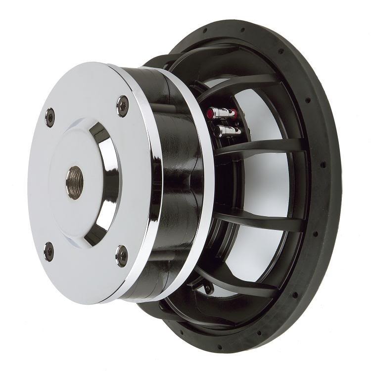

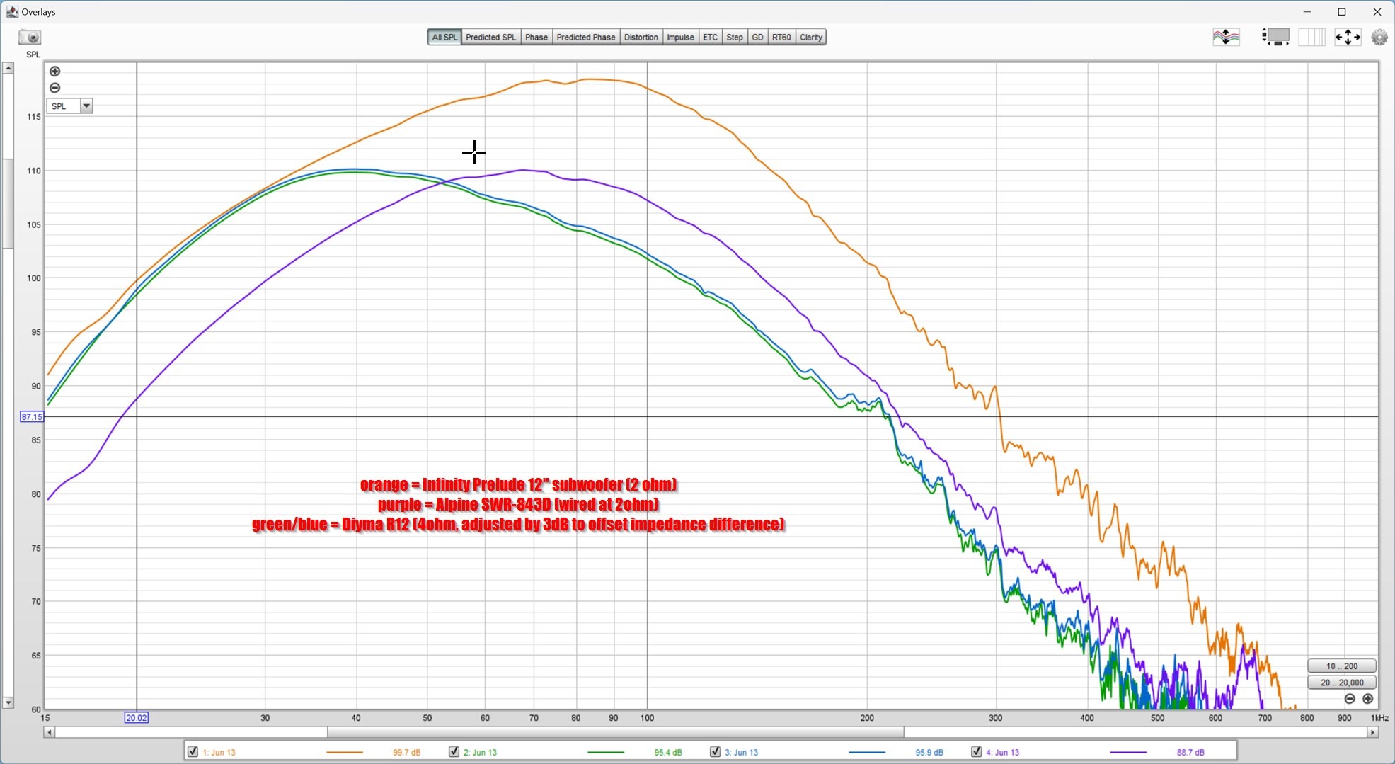

Here's an Alpine SRW-843D
I'm a big fan of the Alpine subs of this era; Alpine was basically offering subs with split gaps and shorting rings and underhung motors at prices that weren't much higher than the cheap Skar Audio stuff that's so ubiquitous on Amazon
Naturally, 90% of the car audio buyers couldn't care less about low distortion, and Alpine wound up getting gobbled up in some kind of weird merger:
https://www.reuters.com/article/alps-alpine-ma-oasis-idUSL3N2101IA

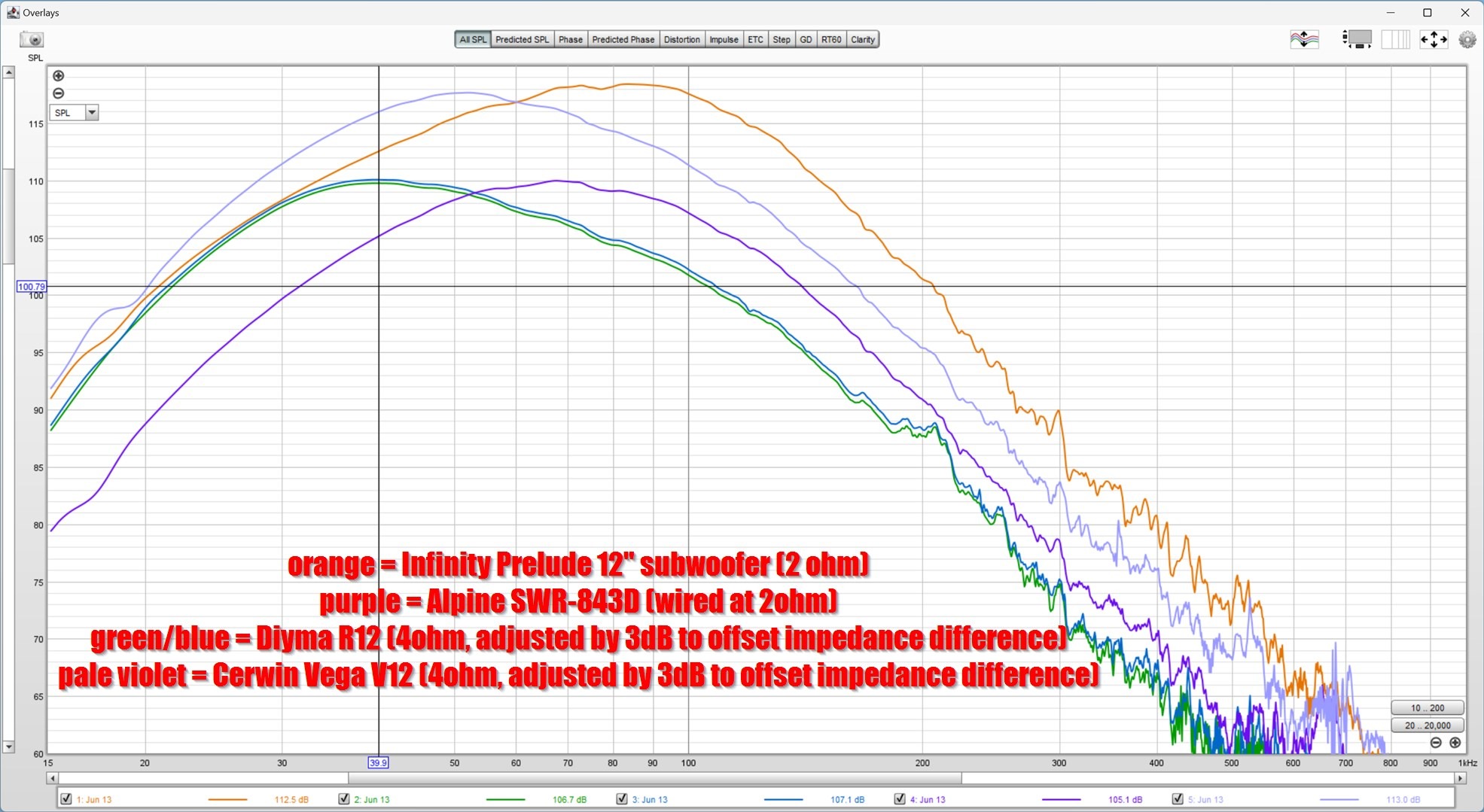

As far as the measurements go, a few thoughts:
1) I think the high distortion is deceptive here. When running the sweep, I can hear something buzzing, but I think it may be the frame of the sub itself. So two bucks worth of mortite could go a long way here. The Alpine weighs about 1/4 as much as the Diyma
2) We can see in the measurement that there's only so much bass you can squeeze out of an eight. The Alpine response looks a lot like the Infinity response, but about 8dB lower. The Alpine's VAS is just twelve liters: https://www.alpine.co.uk/fileadmin/...car_audio_manuals/SWR-823D/OM_SWR-823D_EN.pdf
The designer of the Diyma R12 told me that it took some inspiration from the Peerless XXLS subs. Due to this, it's worth comparing the BL^2/RE of the two. The BL^2/RE for the Peerless XXLS is 44.77 and for the Alpine it's 31.88
Assuming the R12 specs are similar (I still need to measure that), the R12 is definitely a better value. They were selling for around $100 when released. XXLS costs $216: https://www.digikey.com/en/products/detail/peerless-by-tymphany/XXLS-P835017/6557551
Which is actually a really good price for that kind of performance, all things considered

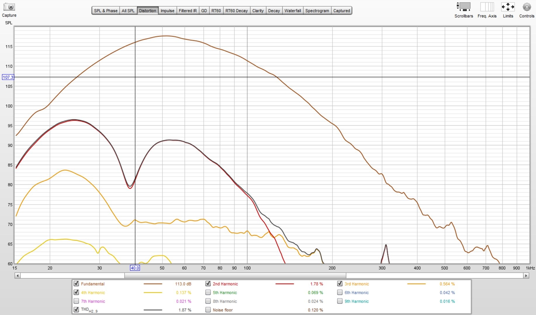

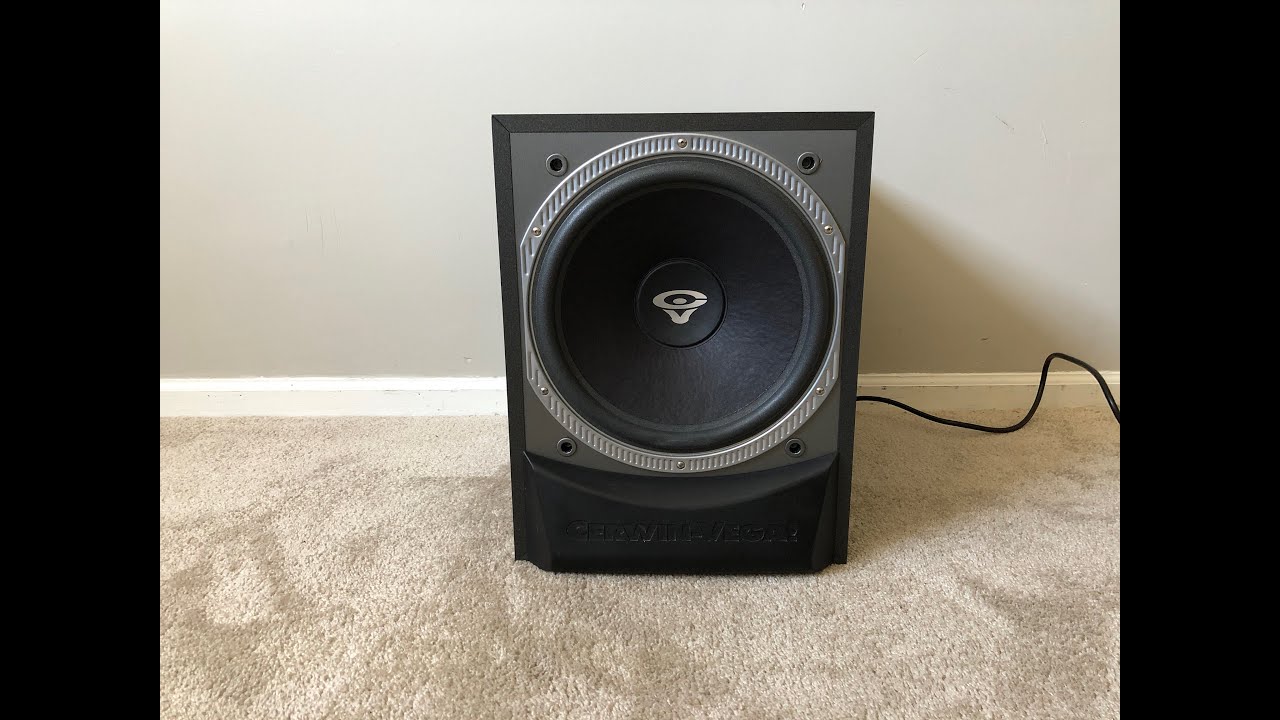

Here's one that looks really terrible at first glance. Cerwin Vega V 12S.
Apex Jr was blowing these out for a few years; IIRC I paid less than $100 for four!
The frame is stamped steel, there's no pole vent, voice coil is tiny, magnet is tiny, it just looks cheap cheap cheap
but...
1) it's pretty darn sensitive. Yes, I know sensitivity is nearly irrelevant for subwoofers, but if I had to pick between the $200 Alpine and the $20 Cerwin Vega, I'd probably take the CV
2) Because it's so darn cheap, and it's 2nd harmonic distortion is 10dB+ louder than 3rd harmonic, this is a really really great candidate for a style of box that went out of style almost 30 years ago: isobaric. Isobaric should knock the 2nd harmonic down to nearly nothing, and it doubles our power handling. Yes, we lose 3dB in sensitivity, but we have sensitivity to burn here.
When looking at the distortion graph, note that the distortion trace looks scarier than it really is, because the overall sensitivity of the CV is highest among all the woofers I tested. IE, YES the distortion curve is about 12dB higher, but the sensitivity is ALSO about 10dB higher
Big question is if I went isobaric, would the sensitivity go down 3dB while dropping the distortion curve by 10dB?
I have four of these and there's one way to find out...

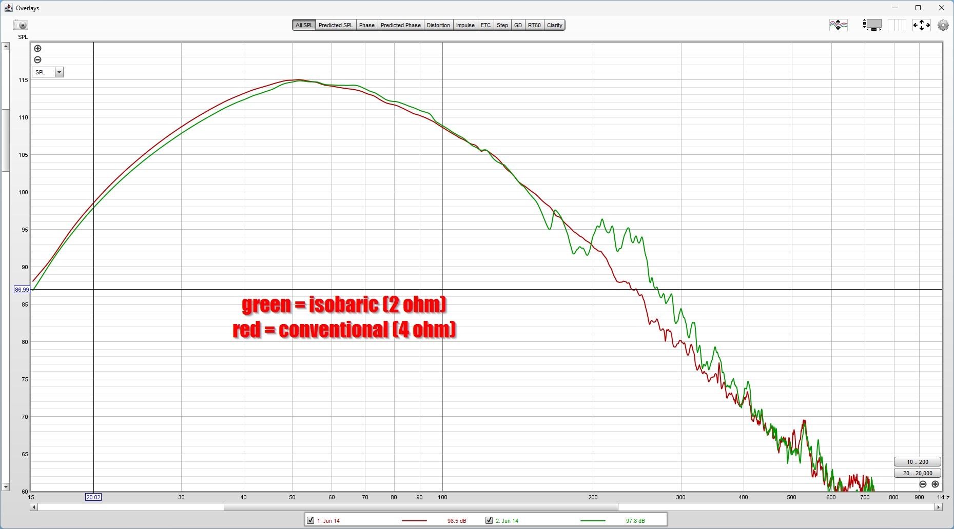

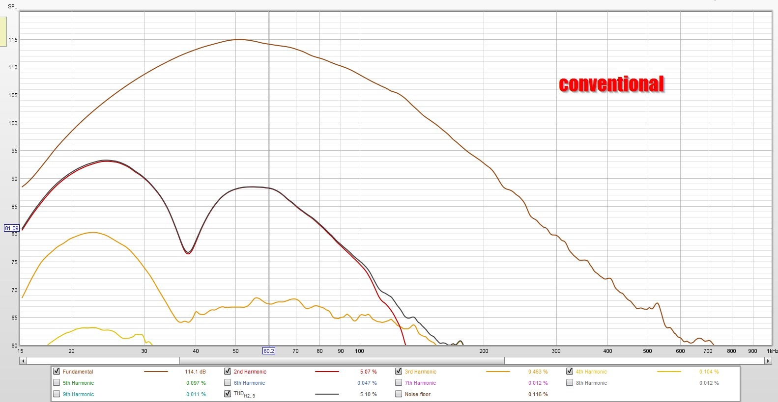

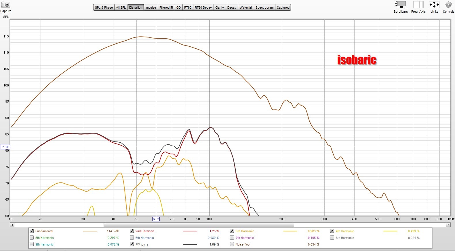

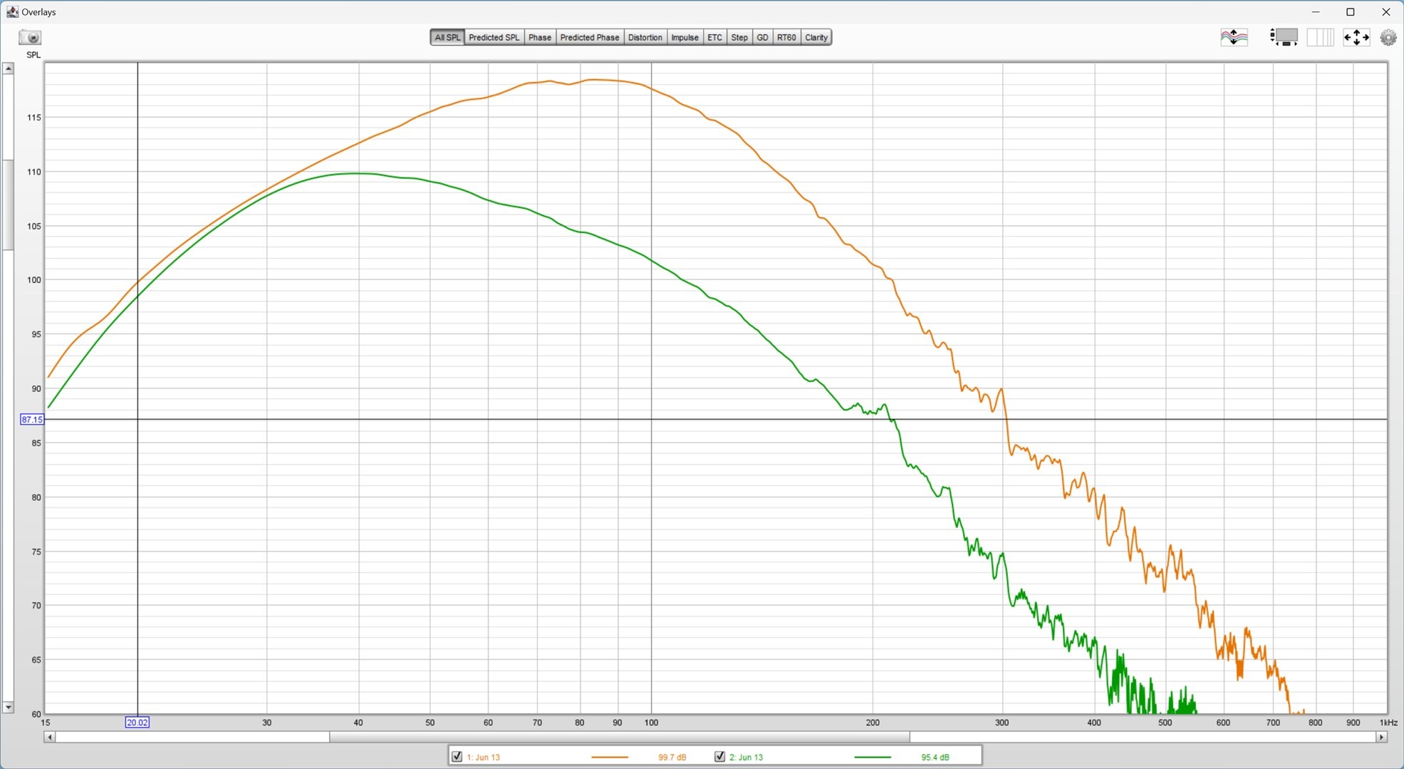

In Post #5, I toyed with the idea of going isobaric with the cheap Cerwin Vega woofers. My thought process was that it's a really low tech speaker with high distortion, and isobaric might improve that. So let's see!
Attached is a comparison of the Cerwin Vega by itself (a 4ohm load) and isobaric, with the voice coils in parallel (a 2ohm load.) In the comparison, you can see the output level is basically identical. There's a variance of a fraction of one decibel. The iso pair has more output in the octave between 200 and 400Hz, I'm not entirely sure why that is.
The second and third attachments are a measurement of distortion. The 2nd attachment is conventional, the 3rd attachment is isobaric. Going isobaric doesn't eliminate distortion entirely, but it definitely reduces it:
  • At 20Hz, 2nd harmonic distortion is reduced from 41.3% to 15%. That's a 63.7% reduction in 2nd harmonic.
  • At 20Hz, 3rd harmonic distortion is reduced from 10.9% to 2.65%. That a 75.7% reduction in 3rd harmonic.
  • At 30Hz, 2nd harmonic distortion is reduced from 11.6% to 7.2%. That's a 38% reduction in 2nd harmonic.
  • At 30Hz, 3rd harmonic distortion is reduced from 1.8% to 1%. That a 44% reduction in 3rd harmonic.
  • At 40Hz, 2nd harmonic distortion increased from 1.8% to 3.2%.
  • At 40Hz, 3rd harmonic distortion increased from 0.4% to 0.8%
  • At 60Hz, 2nd harmonic distortion is reduced from 5% to 1.25%. That's a 75% reduction in 2nd harmonic.
  • At 60Hz, 3rd harmonic distortion increased from 0.5% to 1.0%.
  • At 80Hz, 2nd harmonic distortion increased from 3.2% to 4%.
  • At 80Hz, 3rd harmonic distortion is reduced from 0.6% to 1.8%.
I'm no expert on driver design. My hunch on why some of the numbers went up, is that distortion levels in the range of 1-4% probably can't be measured accurately with my crude setup. Basically, if I repeated the test with more power, I could get the SPL levels up to a point where the distortion is easier to measure. As noted in previous posts in this thread, I just set my amplifier to about 95% of it's maximum gain and measured distortion in the nearfield. That's why some of these SPL numbers look crazy high, the mic is less than five inches from the cone.
It's nice being able to compare isobaric back-to-back with conventional mounting. It's noticeably cleaner.
Low distortion subs haven't been a big hit in the car audio world, IMHO. Companies like Pioneer, Alpine and Orion all offered them, ten years ago, but discontinued them. In the isobaric set up, I can kinda see why - once distortion is reduced sufficiently, you really don't "hear" the bass very much. Even with less than 100 watts on tap, the isobaric setup was able to cause things in my room to shake. IE, I could hear things being shaken by the force of the sub, but the bass itself wasn't particularly audible, especially below 60Hz:
My intention here isn't to discourage people from building low distortion subs. Just pointing out that it's not going to sound like a conventional sub, and you'll want to invest quite a bit of effort to be sure that your cabinet walls aren't generating harmonic distortion on their own, and that the subwoofer is isolate from the room so that the force of the sub doesn't generate rattles among the items in your room. If you stuck one of these isobaric subs in the trunk of a car, there's a pretty good chance that the sound of the deck lid rattling would be quite a bit more audible than the subwoofer itself.

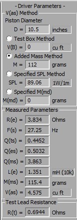

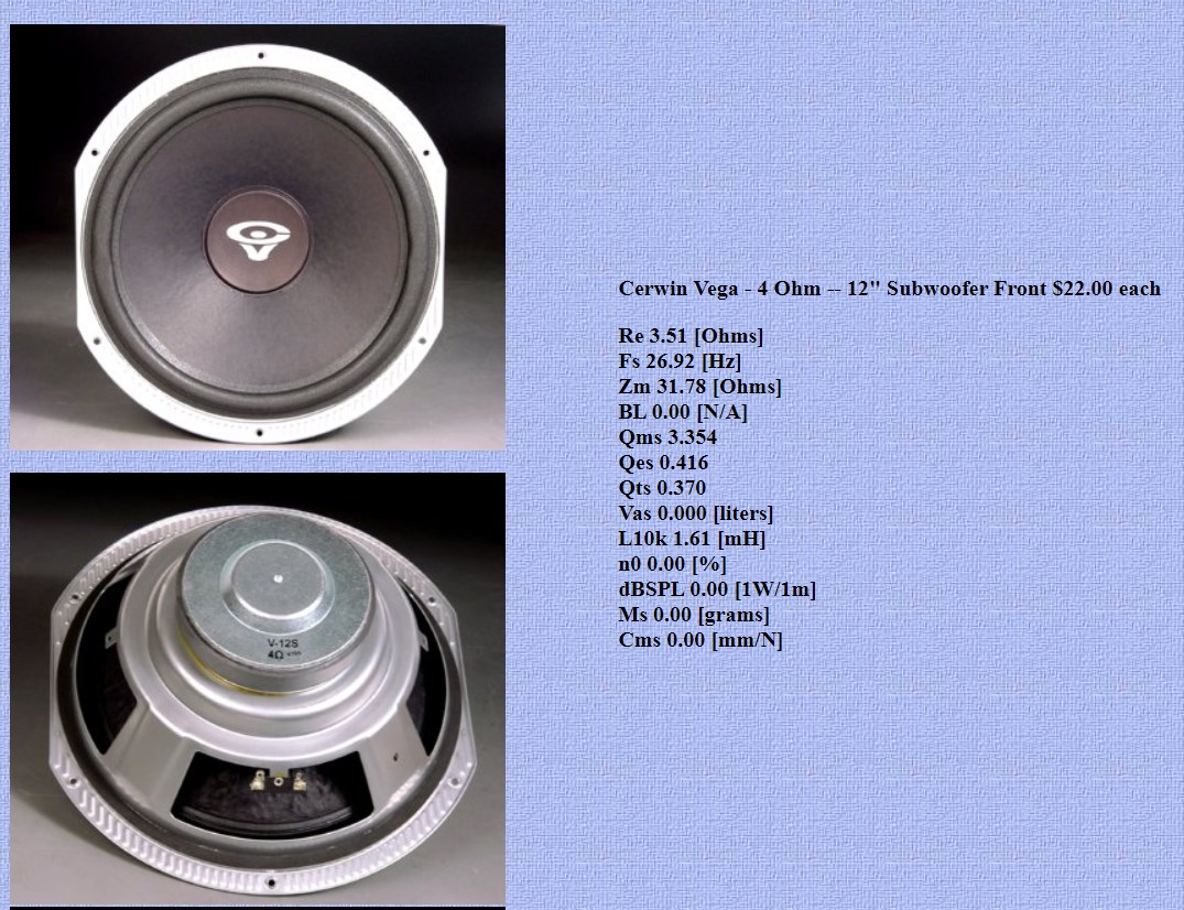

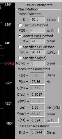

Attached are the Cerwin Vegas V 12s specs as published by Apex Jr back in the day, and also my measurement that I did today
My DATS always seems to wind up with a QTS figure that's quite a bit higher than published specs. Not sure if that's because this woofer came straight out of the box and hasn't been broken in at all, or due to age, or both.
My VAS measurement also looks to be on the high side, I was expecting something around 3-4 cubic feet.
If I wasn't so impatient, I'd burn these in for 24 hours and see if the QTS and VAS will go down

I re-ran the measurements with the driver mounted horizontally instead of vertically, and it didn't make a difference
What was neat was that I played 40Hz over the woofer for 150 minutes and the VAS dropped by 23%!

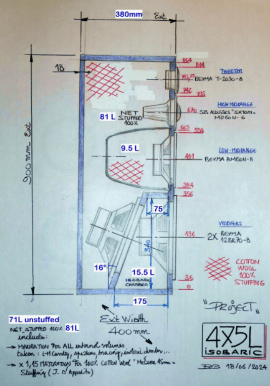

Thank you very much @Patrick Bateman for your study of the Isobaric Cone to Magnet study ! 😎 😎 😎
Your work matches the points announced by Vance Dickason (The Loudspeaker CookBook) and Martin Colloms (High Performance Loudspeakers) in their respective books. So it's both interesting and reassuring, since I am working on an Isobaric enclosure project :
