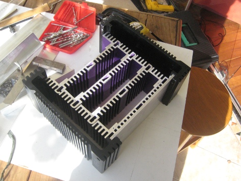

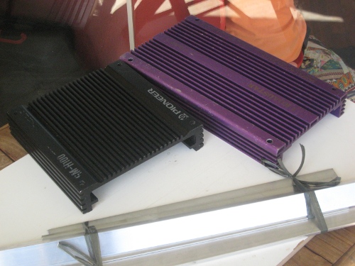

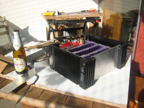

So I got a couple of big-ish heatsinks from one of the car audio repair places and bought a couple of pieces of alum. to help fit things together. (First photo below shows heatsinks before doing anything.) Then spent a couple of sweaty hours with a hacksaw in midday Brasilia heat, producing what you see in the second and third photos. Bottle of liquid refreshment gives scale. (My wife: "If you always complain of how tired you are after doing this stuff why keep such a stupid hobby?..." Me: "Almost all men's hobbies are like this....". Except fishing, I suppose.... Anyone here fish? Thought not....) I haven't bolted it all together yet - that's for some time in the week.
Here's the plan. None of these pieces individually is enough to heatsink an F4, but using 12 mosfets (or possibly only eight) I can spread their positiioning around all this metal, which is a good start with heat distribution. Leaving the bottom open, and only some sort of mesh on top to stop children's fingers getting in, there is loads of surface area to carry heat away. A best guess is about 6000-7000 sq. cm. My F5 has a little more than 7000 sq cm., although not ideally distributed, so we should be in the ballpark. If I can get my hands on a screw-down power resistor I'll try measuring the dissipation of the whole shebang. If it isn't enough for a full F4 maybe I'll try an 8-mosfet version. Assuming heat is a linear
function of the number of mosfets there should be enough heatsinking here for eight. If not I'll save it and use it for some other project.
Anyway, I'd be most glad to hear opinions on all of this, especially the effect of reducing the number of mosfet pairs....

silly ZM here
mentioned mini F4 ( with just one pair of outputs ) was meant as joke , but practical one - either mini follower for usual speakers or proper follower for 16 Ohms speakers as mine .
regarding headphone amp - it's pretty known "secret" that almost any amp can be scaled down to became dedicated HP amp , under condition that PSU voltage and Iq are still big enough to preserve linear operation and function of all active parts .
Papa , and few other DiyAs , sez many times that 15V per leg is pretty much lowest value you can use for stages using mosfets ;
that's pretty general condition , presuming that active parts aren't cascoded etc .
btw - looking at these htsnks you scavenged - are you sure that you have enough thermal contact between different pieces ?
important if you need them as such ( one big heatsink ) not so important if not .......
anyway - they look so cute !

Hi ZM,
I wondered if it wasn't really meant as a serious suggestion - nonetheless, a "mini follower", as you put it, is what I was imagining. Suppose, for instance it was intended to follow an 8W Le Monstre, or similar, into 8 Ohm speakers; would a version with *two* mosfet pairs (rather than the three in a full F4 or the single pair in he headphone amp be adequate? What sort of power output would it have? A stupid guess would be 2/3 of the 25W the F4 produces, or about 16W... This would be a pretty interesting size for me... What do you think?
I'm planning on trying a +/-20V PSU I madefor the Hiraga 20W Le CLasse A. If it's too wimpy I'll build something better, but it would be nice to reuse if possible.
As shown they aren't bolted together so the photo may be deceptive. Plan is to clean off the anodizing on touching surfaces, use a little silicon grease, and bolt them so that the surfaces touch under a little pressure. This would hold the four inner pieces together and spread heat well. Since each piece has two mosfets (and hence heat is being produced in a dispersed way) I'm sure this is enough. Heat will also be transferred to the big black sidepieces (which will also have two mosfets each, if I can get twelve running), via other bolts, and also by tow strips underneath which will help to hold the whole thing off the ground and let air enter below. It's not too easy to describe, but when I have it all fitted together 'll post more photos.
Cheers

good enough
go for +/-20V , and use 2 pairs , as you say ;
Papa use 3 pairs to make amp capable of delivering proper output current ;
if your speakers aren't current hungry , you can make compromises ;
if they are , think about using original circuitry
