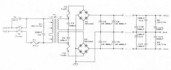

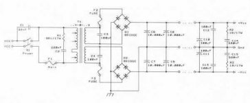

No, I don't see a way to use such a scheme with a centre-tapped transformer without creating a short circuit 50 or 60 times per second.
I also don't see what the advantage of this circuit is compared to one with a single bridge rectifier, except that the single bridge rectifier needs twice the voltage rating.
If there is 4 transformer output, system completely seperate from the transformer (same thing with two rectifer); ground seperated, not the zero output of the transformer.
