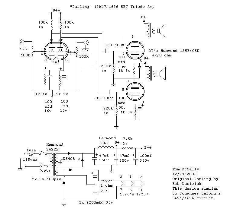

Wondering if someone can clear up a simulation issue for me...
The schematic in post #2 is essentially a 'typical' Darling, being run at Bob Danielak's original operating point. But is this too hot? I'd hate to go to all the trouble of building this, only to burn up my 1626s.

But,that notwithstanding, it still looks to me that the 'normal' Darling operating point is too hot... Schematics show ~250V on the plate at 25-27mA. That is way over the 5W plate limit.
Should the cathode resistor be 1.5k or so instead of 1k?

I can't speak to your Spice simulations but a lot of Darling type amps run the 1626 tube a little above 5 watts.
Mine uses the DIYTUBE "Clementine" board and it runs about 5.2 watts. The tube seems plenty capable of running above the 5 watt book specification.
So, no reliability issues from running above the spec? The 1626 tube is getting harder to come by...
I mean, it looks to me that the original Darling runs the plate at 250V * 27mA = 6.75W. Way high!
When tubes were cheap many were run above the recommended value but it will shorten tube life. E.g. I've got a design that runs the EL84/6BQ5 at 280 V @ 58mA. Guitar amps often run tubes above their ratings but tubelife is notoriously short. If you want long life then run them at 70%- 80% of the maximum rating, they'll last almost indefinitely. One other design I've got is running the EL84/6BQ5 at 200V and 50mA which has a reputation of running almost forever without changing the output tube. Output at that level is approx. 3.5 Watt (not taking in account OPT losses).
