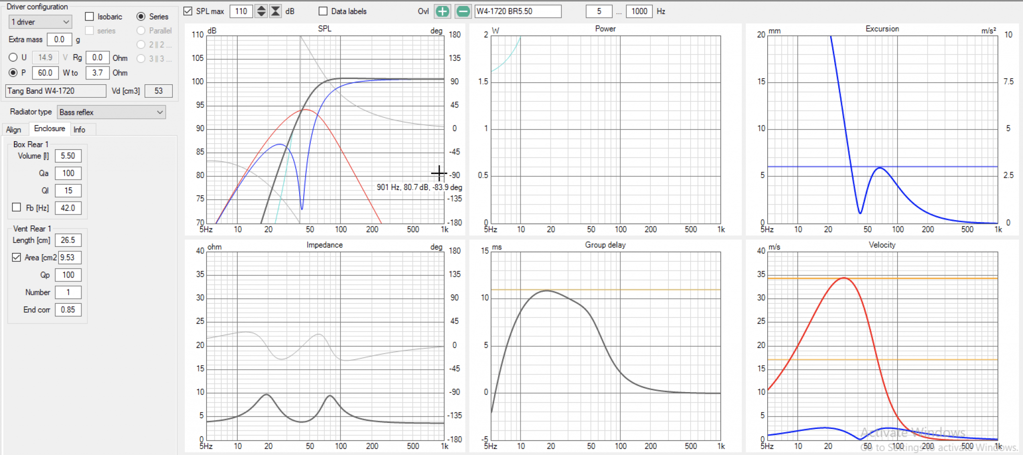

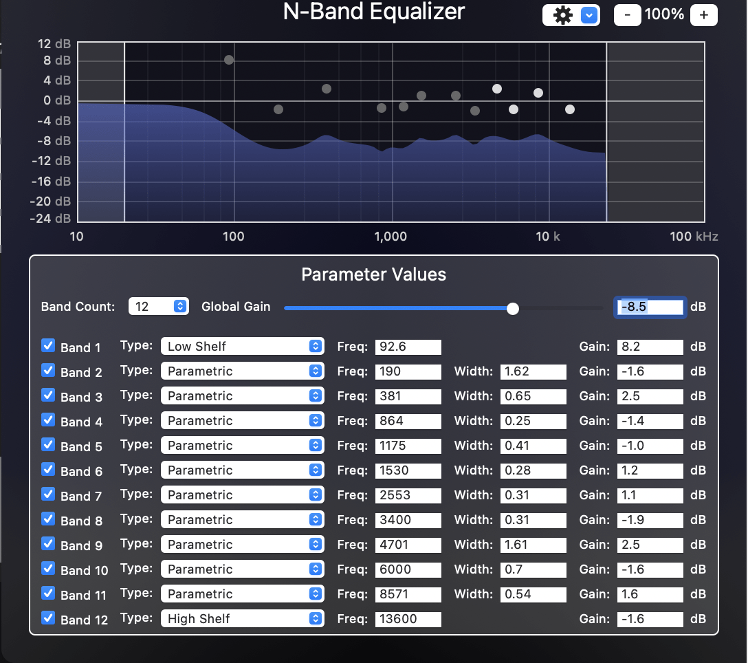

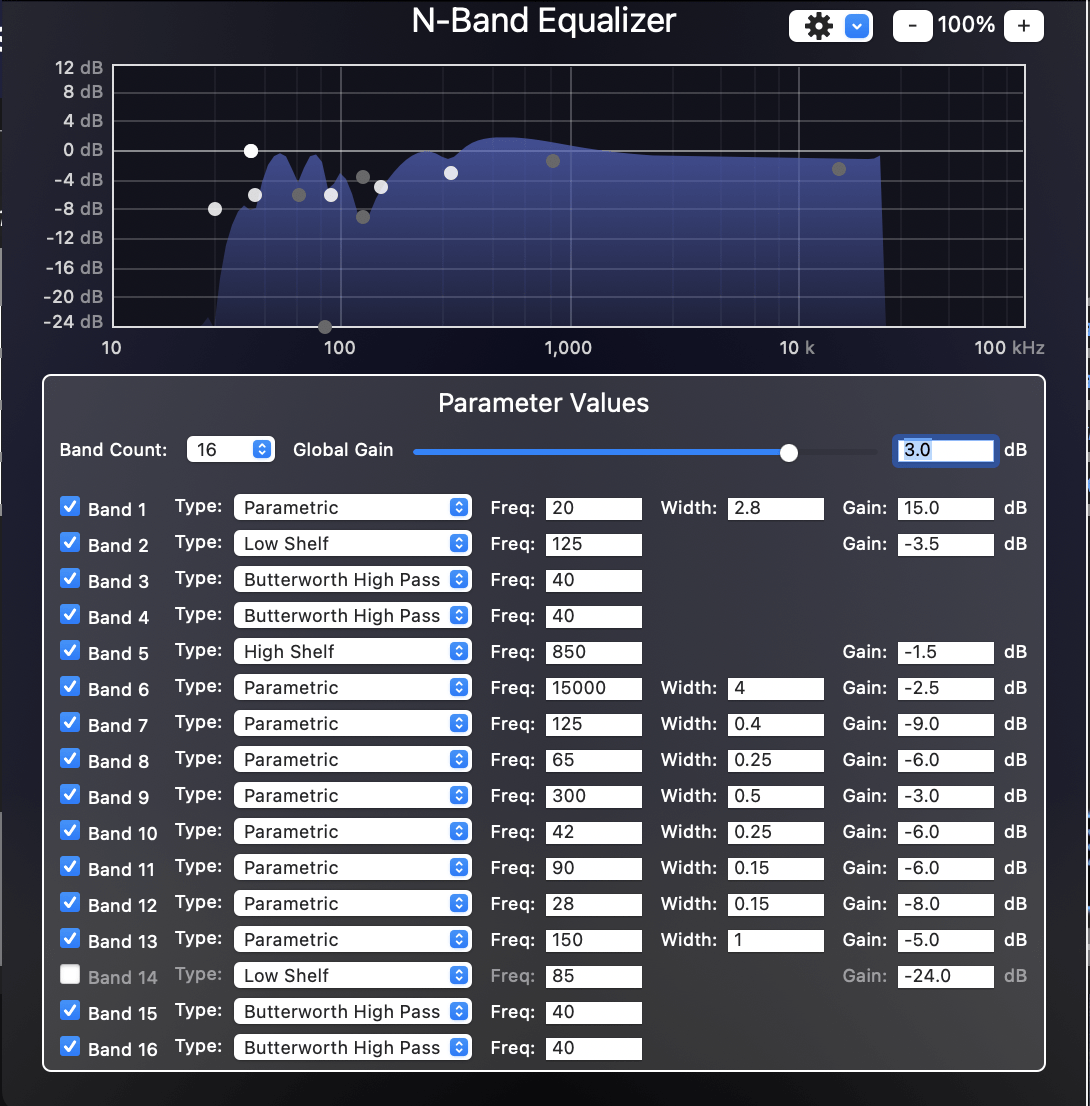

I've had a pair of Speedster kit speakers in my posession for a few years now. They're excellent nearfield monitors, covering most of the musical range by themselves in a small package. I'm quite happy with them, but as with all things the tinkering began about a year ago. Some pretty serious EQ was brought to bear on these, trimming the excess brightness and cleaning up my room modes/desk bounce, etc. The bass management in particular has become quite cumbersome, totaling 9db of boost and a 4th order cut at 40hz. The frequency response is incredible now. No fatigue, deep resolving bass, no midbass hump, etc. All this boost however has completely overloaded the port at high listening volumes. I'm getting unimaginable chuffing. In the long run, my answer will be to add a sub like the SB3000 Micro.
For now, I'm thinking about replacing the port. In theory, this could be resolved with a simple flare, right? I cut a new port with total length equal to the previous, same diameter, same tuning with less interference, yes?

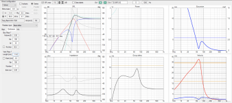

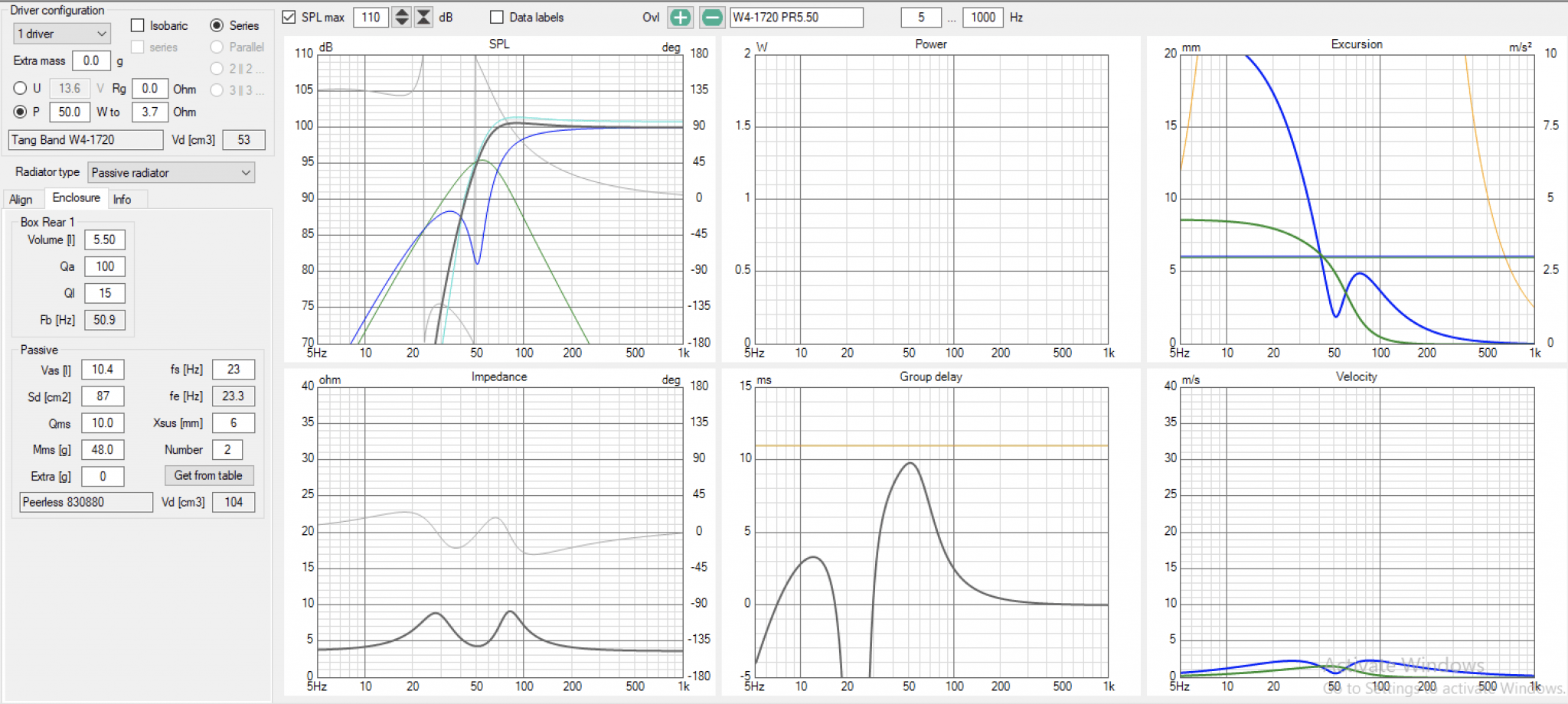

The next, more extreme option would be adding passive radiators. I've modeled a number in VCAD and my best bet to match the W4-1720 is the Peerless 830880. They do not fit on the back. A full half inch too long, unfortunately. To fit them on the existing enclosure I would have to remove and plug the rear port and mount them on their sides. Not sure how that would affect the sound to be honest. It does remove around 3db from the bass response.

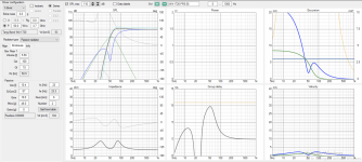

My last, most extreme option would be to recreate the slot port design of the enclosure. I've been considering an enclosure redesign but haven't gone through with it. The slot port has a wider opening, lower tuning, and a broader, lower air velocity peak. I'm not that excited about the front facing nature of the port, either.
I'll take literally any recommendations for how to solve this. Cheaper is better, but I plan to have these for a long time. I could invest in them a bit if convinced.
Some reference material, EQ and VCAD sims are attached.

A simple flare will help very little.All this boost however has completely overloaded the port at high listening volumes. I'm getting unimaginable chuffing.
Regardless of the size of the port, it will be "blown out" and chuff when boosted below Fb- if you want lower frequency output, tune lower- your simulations show Fb's in the 50Hz range, not going to work with boosts below that frequency.
A fourth order HP should be used just below Fb, and any boosts only around Fb.
To reduce port velocity related wind noise requires a larger, longer port for the same Fb, which would require external ports since the box has already been built and it's volume is fixed.
A slot port could be added externally, and vent to the rear or side if you don't like the sight of it.
You could plug the port, which would make for a sealed box alignment . . . and then revise your EQ profile.
However, boosting to high levels at frequencies well below Fs will likely reduce the life of the midwoofers.

So then what about PRs? I haven't actually used them ever, but I keep hearing about them. I'm losing some output by adding mass and suspension to the design, but they could theoretically help me play lower cleaner, right?

I think they are a bad idea. Hey let’s add another resonance!So then what about PRs?

Sheesh! In HR its 30 W vent mach peak is ~41 m/s and only ~9 W/~17 m/s and with sufficient damping it rolls off below ~120 Hz 🙁, but it's a bookshelf speaker so fine as is and add a sub for < 120 Hz for max power handling.
Personally don't like PRs above ~35 Hz; this driver needs an inverse tapered TQWT.

And Scott has done a box that turns your Speedsters into ML-TLs if you are interested in more bass naturally instead of overEQing
