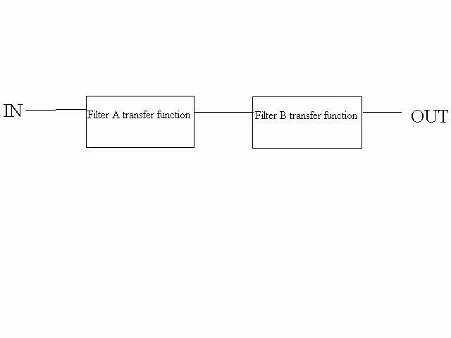

Realizing an amplifier is a simply a filter with gain then the sketch below is correct and the two filter elements exactly do simply add up. Each has been characterized individually. Do you not agree with this practice? Accepting that is the case then the numbers I give are conservative for open loop gain at DC. The sketch does not show the global feedback loop as that was the discussion.
It was said by a great audio designer "that if more gain is good then most is best." With that philosophy this IC amp was developed. Please, I did it, it works as stated, and has huge gain. Please accept this. I know it is difficult for many to believe because they are not yet of the understanding reached for amplifier design to allow them to make such a high gain amp.
If two amplifier units (or filters) are cascaded, then there is no "open loop" gain for the total, as both of them are configured in their own closed loop already.
For an example of an implementation of 180dB open loop gain by multiple opamps, take a look at pp 26 of 1994 February issue of LT Journal (by Linear Technologies). The 180dB gain is not at DC but 10KHz, though.
http://www.linear.com/ltmagazine/LTMag_V04N1_Feb94.pdf
Isn't your topology like the above article??

No, not at all exactly.
With those filter characteristics in mind then what I say still holds true and the amp has 225dB gain at DC. There is no local DC feedback. Why do you think it needs a servo? Can you imagine trying to trim that out with a pot???? That would be a good chuckle!
I do not mean to be rude to anyone but I am also tired of people trying to figure out how I made this cheap amp into one that others say competes at the $3000 level as far as sound goes. I am not going to answer any more questions about this specific design, thank you. Everything I have posted (except for an obvious typo in the distortion matrix) is correct for the "as built" one. Will say one thing, I used parts on hand and not the optimum values. Factor of two was close enough. Think filter with gain is far more useful than thinking "amplifier."
Please, forget everything you believe you know about amplifiers and go to the lab and play!
