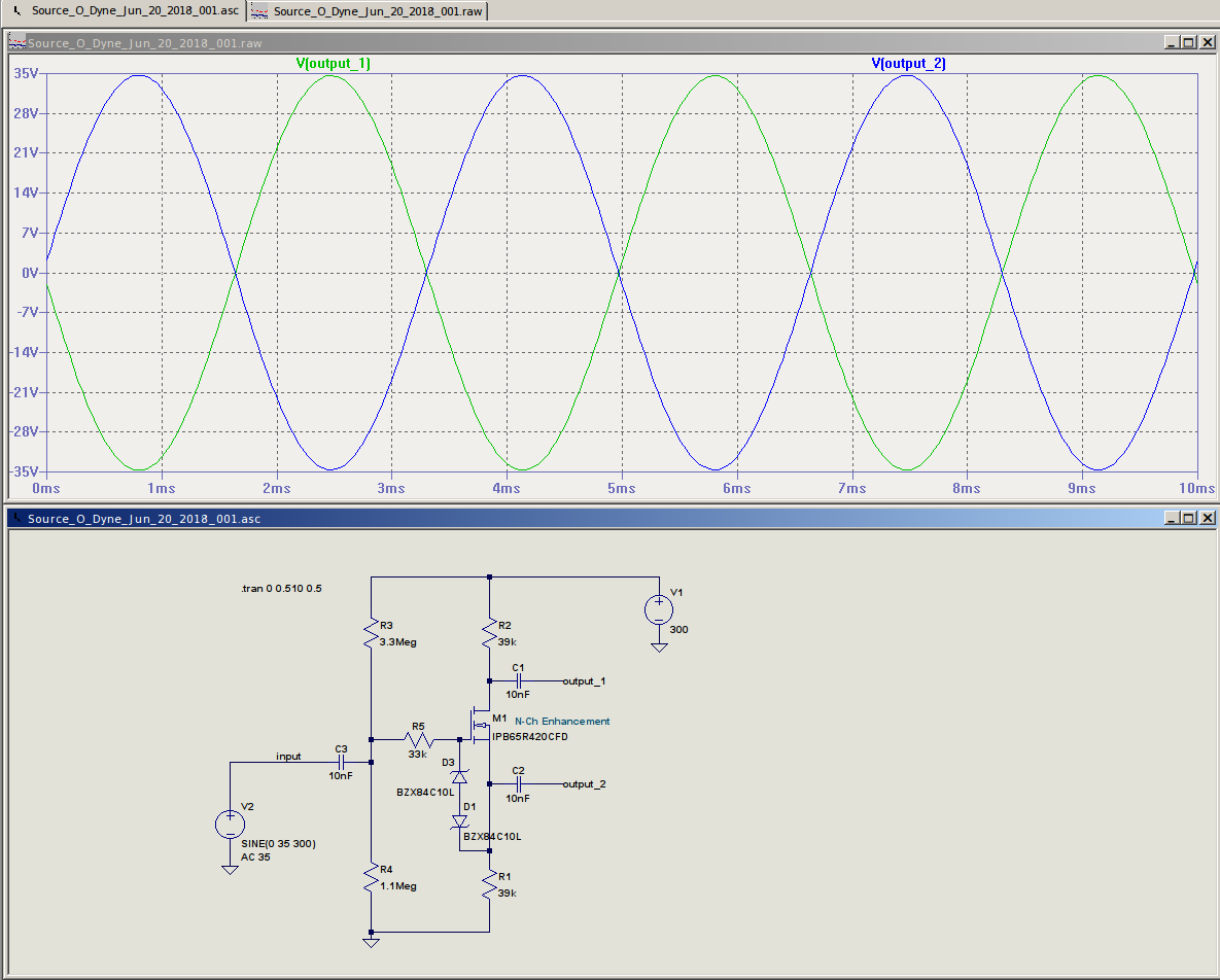

I was thinking to build a tube guitar amplifier, and to save a bit of power and space to use a solid state phase splitter to drive a push-pull EL84 power stage.
Any experience with that? Suggestion on a good schematic?

I have a "source-o-dyne" phase splitter made with an LND150 MOSFET in a small push-pull 6AK6 amp I built a few years ago. It works very well, exactly like a valve-based cathodyne, but even better.Any experience with that? Suggestion on a good schematic?

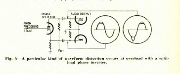

(A true valve cathodyne has some nasty characteristics when overdriven unless you take several precautions. There is a section on this in Merlin Blencowe's valve preamps for guitar book.)
IMO, a real valve is wasted in a cathodyne. With so much negative feedback, the cathodyne produces too little harmonic distortion to hear. It sounds sterile-clean, just like a transistor. So why not just use a transistor (MOSFET) instead, and save the triode for somewhere else in the circuit, where it can actually contribute to the sound?
A generic schematic and LTSpice simulation is attached. The exact MOSFET you use doesn't matter much, as long as it's rated for a sufficiently high voltage. I just picked something built into LTSpice. The back-to-back 10 volt zener diodes are necessary to protect the MOSFET gate.
Incidentally, minimum B+ is at least four times the largest peak signal you want to drive your output tubes with. Put another way, if you use, say, 300 volts B+ on the MOSFET, it can spit out two phase-reversed signals of up to almost 75 volts peak (150 volts peak-to-peak) each.
That's without any load on the source-o-dyne outputs. Once you hook them up to the EL84 control grids, there will be some loading from the grid bias resistor, and heavier loading from grid current once the EL84s start to overdrive, so the maximum available signal swing will decrease.
-Gnobuddy

We can now easily find 500V MOSFETs, so we can drop-in a MOSFET and run it on the same 300V rail as the tube we are replacing.

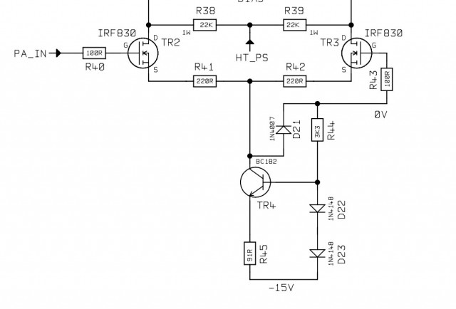

A MOSFET differential-pair PI is a no-go, unfortunately. The reasons are not immediately obvious, so I'll start at the beginning:And what about using the case of a phase splitter based on a differential pair cathode biased? Using an equivalent mosfet circuit will it influence the sound?
A proper (triode valve) diff. pair, unlike a cathodyne, does have voltage gain (say 25x - 30x to each output). It also overdrives gradually as the signal level goes up, and this provides enough distortion to be quite audible, at least if the amp is designed so the output stage hasn't gone into hard clipping long before the phase splitter starts to overdrive.
To me, the long-tailed-pair valve phase splitter has a sort of "growl" to it, probably from significant amounts of third-harmonic distortion. It is a push-pull amplifier, after all: that means even harmonic distortion is cancelled out, and only odd harmonics are generated (assuming perfectly balanced MOSFETs.)
So, to replace a proper valve diff amp PI, our hypothetical MOSFET differential amp phase-splitter has to do two things: it has to provide voltage gain like a valve diff amp PI, and it has to overdrive and "growl" like a valve diff amp PI does.
It's easy enough to wire up a pair of MOSFETs in the same differential amp configuration (though self-bias is a no-no). But we immediately have a problem: the voltage gain will be way higher, maybe ten times higher, than a valve diff amp. This is because modern MOSFETs have enormous transconductance compared to a half-12AX7 or similar triode.
Okay, we can fix the too-high voltage gain by putting an unbypassed source resistor betwen each MOSFET and the shared "tail" resistor. But the fix introduces another problem - now you have a sterile-clean PI that provides no audible distortion at all. It will sound like a cathodyne, not like a long-tailed pair.
Maybe there is some clever way around these issues. But at the least, it's not a case where a simple substitution (MOSFET for triode valve) will work well.
Incidentally: FETs and self-bias are a very bad idea. It doesn't work at all for enhancement-type FETs, and it doesn't work reliably for depletion-mode FETS either, because of the wide parameter spreads all semiconductor devices suffer from.
This is why, for instance, the circuit I posted for a MOSFET "source-o-dyne" doesn't use self-bias. Instead, a pair of resistors across the power supply biases the MOSFET gate to one-quarter B+. The source of the FET will settle to within a few volts of that, and with a few hundred volts B+, we can just ignore those few volts, and say the source will be at one-quarter B+. Now chuck in equal value source and drain resistors chosen for reasonable current flow and reasonable power dissipation in the MOSFET, and you're done.

Thanks for the link! I note that RG Keen experienced exactly the issues I just described in my last post. He didn't mention that adding local NFB to lower the MOSFET PI gain also linearizes away any trace of audible distortion, but perhaps he was okay with an audibly transparent PI, rather than one that sounds like one made with a pair of triodes.<snip>

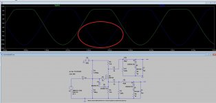

Agreed, that thought has crossed my mind as well. It would work as a cathodyne substitute that does not suffer from "nipple distortion" like a real cathodyne or source-o-dyne.If it remains as clean as the 100% NFB splitter as described on the previous page it might be an option to someone also.
The attached image shows the problem. The zener diode mimicks what happens when grid current starts to flow in an overdriven output valve.
In this example, I used a 10V zener, so if Vout1 exceeds 10 volts peak, the zener starts to draw current. This acts like bypassing the FET source resistor, which bumps up the voltage gain to the FET drain. This in turn shows up as "nipple distortion" on the second PI output, Vout2 (blue trace.)
The MOSFET long-tailed-pair you showed will not suffer from this problem.

I agree that large grid-stoppers are one of the keys to managing cathodyne distortion.A 47k/100k 1/4w resistor is as cheap as efficient to reduce the mA hungriness of the following power tube...
But as the attached image shows, there is still distortion even with a 47k grid stopper. I've used a typical Fender value of 56k for the cathodyne's cathode and anode resistors. When the output valve starts to flow grid current, that effectively puts the 47k grid stopper in parallel with the 56k cathode resistor.
That drops the effective cathode resistance to 25.55k, bumping up the voltage gain at the anode from nearly unity (1.0) to nearly 2.2 times.
Because the cathode resistor (or source resistor, in this case) is so large, IMO it is virtually impossible to make the output valve grid stopper so big that there is negligible "nipple distortion". If we make that grid stopper too big, there might be unwanted treble roll off within the guitar frequency band.
The long-tailed-pair circuit doesn't suffer from this problem, and if we build it with MOSFETs, it's also cheap and compact.
