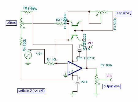

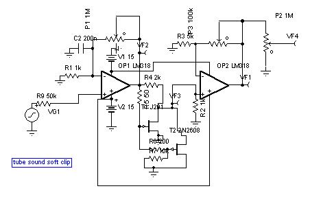

here's a tube fuzz circuit
this ought to give you a tube fuzz sound. it simulates a tube amp in output clipping. remove one of the transistors and it simulates tube input stage clipping.

i see.

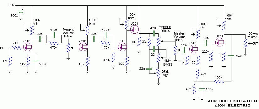

i have found a jcm800 'emulator'. it uses jfets and mimics the whole amp not just the preamp so apparently it sounds rather nice. i was thinking of sticking with that as a clean(ish) preamp stage and using my boss me50 for the effects, which i was originally trying to avoid.
the thing that puzzles me about the jcm emulator is that it doesn't appear to have any clipping stages so the 'drive' must be purley overdriving the jfets. i've never heard overdriven jfets personally and i was wondering if it would sap the tone.

Clipping characters of both FETs, BJTs and vacuum circuits depend on the gain of the actual device, the gain setting of the circuit, DC bias point of the circuit, amount of negative feedback applied and, last but not least, on low and hi-pass filtering of the stage (post and pre). The tone of a certain device is always as much a result of the surrounding circuitry. Without seeing (and usually hearing as well) the actual design it's always difficult to comment anything about its tone, which is also a highly subjective matter:
I can tell you that I think the clipping characters of a common source JFET gain stage are not that superior over clipping characters of a transistor (or even an opamp) and some one else can tell you that they are. To my ears both clip suddenly and harshly - in circuits designed for clean tones. Then again, another common source JFET gain stage (or a common emitter BJT stage), designed to be overdriven, can sound good while clipping but to my ears it does not sound very good if I need a clean tone.
Don't believe all the hype about clipping characters of certain devices. There is some truth in it but in the end it all comes down to all variables I listed and to how they interact with each other. If you like the tone of a certain circuit then build it. It's that simple.

That is almost like the version of "Thunderchief" effect from runoffgroove.com that had a tonestack (http://www.runoffgroove.com/tc-tone.png). There are couple of differences - like an extra gainstage - but at least the mysterious "Electric" should have given credit to the original designers of this circuit. The low-pass filter is missing as well - that will make a difference to the tone.
There were some problems with the original design so Runoffgroove has released another updated version called "Thor", that is quite different from the original (http://www.runoffgroove.com/thor.html). The linked page discusses some issues related to the original design. You'd better read the FAQ (from the same site) as well since there is a question related to biasing problem of the old design - the circuit you linked has the same problem. There is also a mp3 sound link to the basic "Thunderchief" design that you might want to check out. I'd imagine the inclusion of another gain stage and tone controls will shape the sound quite drastically though, not to mention the exclusion of the lowpass filter.
This design has shown up earlier here at DiyAudio when someone asked how to convert it to higher (and dual) supply voltage. It was mentioned that the supply rejection of this kind of circuit is very poor and I completely agree with that. Unless you decide to run that thing from a battery or from a very stable regulated supply you need to add some filtering between stages to lower supply ripple and to prevent possible "motorboating".

Nope, it's not the tone stack that causes problems. Apparently there are some problems in the gain stage that mimicks the phase inverter circuit and takes feedback from the output stage.
A direct quote:
"Too much resistance between source and ground will prevent the stage from functioning correctly. Reducing the resistance then re-bias, and the stage will amplify as it should. With different part numbers for the FETs (we've tried a few), you'll find some that will not work at all. Some will not bias regardless of the resistance you have between +V and drain. If however, you change the resistance between source and drain to something within the particular FET's "operating range," you'll be able to bias up and the stage will perform as it should. Apparently, even J201s are inconsistent enough to cause the circuit to work well for some and not for others."
True, FETs are very inconsistent and that's why those circuits have those trimmer potentiometers - and even they seem to go out of range sometimes. There seemed to be an easy fix to the problem that was described in the FAQ:
"Find the 470/4k7/4k7 resistor chain going from Q3 source to ground. Reduce the first 4k7 to something smaller. Try 1k, then re-bias to half the supply voltage at the drain."
There you have it. I don't think either Uno or Thunderchief are that difficult to build. If you have time you might as well build all of them, the cost of parts is extremely low and (considering future projects) you probably wish to buy a nice bunch of those FETs anyway.

The JCM800 emulator by Electric. No sound clip on that but this is how imagine it would sound like: The lowpass filter is removed so the sound is brighter than with the Thunderchief. Tone controls cause a scoop at middle frequencies and bring more clarity to the signal. They also offer more versatility when compared to Thunderchief or Thor. It has an extra gain stage, which is good considering insertion losses caused by the tone stack, but if the extra gain is not implemented carefully it might lead to excessive overdrive in one stage that causes the sound to "fart out" on bass frequencies.

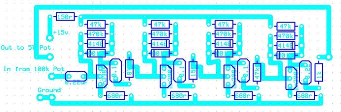

Here is an op-amp pre-amp design that I worked on for my young son a few years ago. It may be of some use to you. His mate had a Fender front-man so he needed something to compete. It was coupled to a 25W chip amp. I had it at the stage of a working prototype built as a combo (still have the fully built board somewhere) when my son decided that he preferred the sound of valves and went back to the 7W all valve combo I had built earlier... so end of project. This is a preamp only. 2 inputs so one of his mates could plug in as well. Tremelo on both channels and switchable distortion/clean on the second channel. Distortion has gain and tone controls. Has a 3 band active eq, that from memory needed some work on the component values to work in the guitar range, especially the treble. I had some capacitor values worked out but can't recall what they were. A dual supply +/- 15v is needed. The 50hz notch filter intended to combat single coil hum was dropped from the final design. Channel switching was done by a relay on the main board. Ldr1 and led1 were coupled together with black plastic tubing for the tremolo. Its important to block out ALL ambient light from the led1/ldr1 setup, ie ambient light comming in from the back of the led will affect the tremolo, even the shadow of a person walking past the back of the combo will affect the tremolo. ldr1 is one of the cheap Dick Smith types about 6 or 7 mm in dia. Led1 is high intensity red led also from Dick Smith. Led2 and led3 are part of the tremelo oscillator. Fx in and Fx out were not used so I soldered a jumper between them on the board. This is all of the info that I have, but a few nights spent studying the circuit and board layout and you should have no problem working out the function of the unmarked pots , connectors and IC's. Board was made using press and peel. I made the mistake of assuming that it was A4 size when in fact it is US letter size so I had to shrink the final printing using the printer properties, from memory I think its about 95%.
Input sockets were placed in the gaps between the channel volume controls with short lengths of sheilded cable running from the sockets to the board. The thin lines on the board are jumpers, I spent many hours trying to get a single sided layout with no jumpers, but in the end decided I had already spent enough time and had to be content with the board as you see it. Circuit is put together from smaller circuits I found in magazines and on the net, they are all standard text book stuff. Mine worked first time the only problem being the tone controls which worked backwards. I had to cut tracks to fix the problem. I'm not sure if the board here has the same problem but its easy enough to fix by cutting tracks and basically swapping the two ends of the pot connections using short lengths of wire, or you could re-route the tracks before the board is made using some sort of graphics software. Its not fancy but it has been built and tested, it works.

Board and circuit are PDF files located on Megaupload. Sorry for using Megaupload but I could'nt make the files small enough to include in the post. If you don't know how to use Megaupload just cut and paste the above link into a browser address bar and press enter, The megaupload page will start, you may have wait while a timer counts down, could be up to 1 min You will be shown a picture of some text (usually 3 letters) just enter these letters into the box provided and press enter. Download should start.
I am useing this curcuit in my Guitar amp for Distortion and it is honestly one of the Best distortion sounds I have ever heard.....
The design calls for 2n3904 Transistors but I found I get a MUCH better sound useing 2N2222 Transistors....
If you want to use it as a Pedal you could easilly add a Bypas switch so you can Turn it on a off by stepping on the Bypass switch and best of all it will only cost about $4 in Parts at most....
I play Heavy death metal and hardcore Punk type music and this is perfectly suited for this type of Music.....

PS: the orentation of the Transistors is reversed in the diagram....
