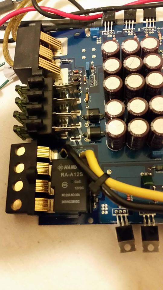

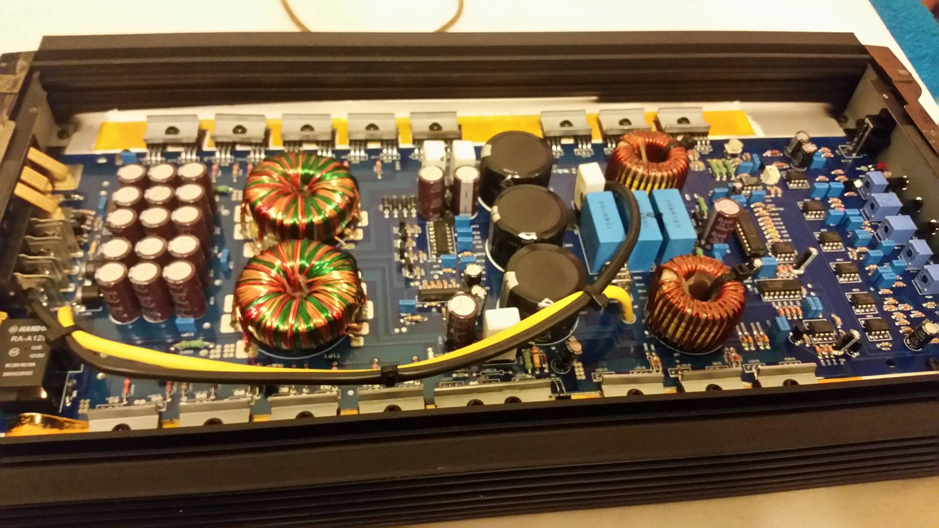

I have a solid audio here. The board looks like an old autotek and hifonics. The problem is that it stays powered on with the remote wire completely disconnected. It does play music but I dont believe its playing to its full potential. Any help would be greatly appreciated.

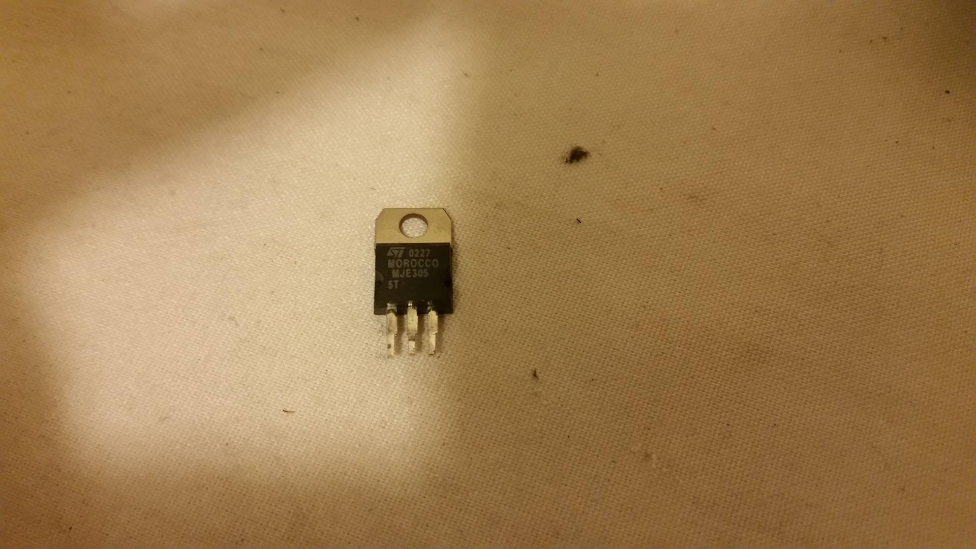

Around 70 volts rail voltage. I found the transistor MJE3055T shorted between legs 1 and 3. Is there an alternative I could use for this. I dont have any of these anywhere.

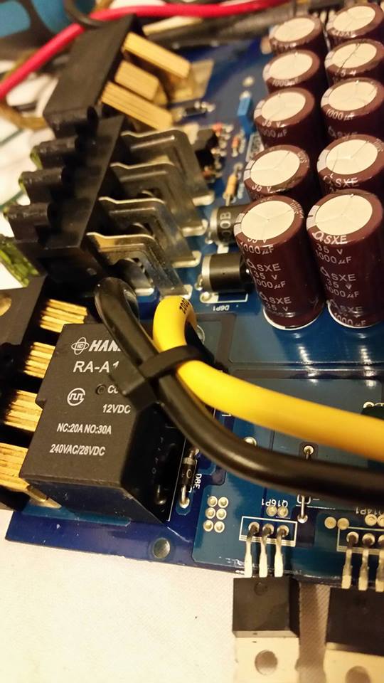

It was in location Q15P. It does tie in with the remote circuit and the emitter went across next to the relay to a diode.
