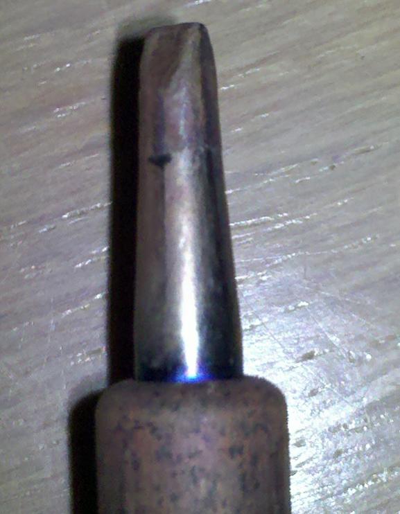

I have attached a picture of the bit I'm currently using (large because I'm working on a PSU for my amp!).
I would be truly grateful if anybody has any suggestions!

It looks like the tip is really dry (as in no solder on it). I would try some tip tinner. If that doesn't work, "paint" the tip with flux using a flux pen or liquid flux. Do this when the tip is cold. Then turn the iron on and hold a piece of solder to it as it warms up. If that doesn't do the trick, I'm afraid the tip is dead.

The only things that have changed most recently are the tips.
Tinning the bit has always been problematic though, and I've often had to resort to a bit of gentle treatment with sandpaper.
The tips always seem to go gray / black.
I don't leave the iron on for prolonged periods so it's not that.
I have a moist sponge and keep the tip (once successfully tinned!) as clean as possible whilst working.

Yea - sounds like you are doing everything right- Just because the readout on the iron says 270 degrees it might be that it is not heating enough. Does it sizzle when you touch the hot sponge? Would be nice to have a way to measure the temp of the tip. hmmmmmm

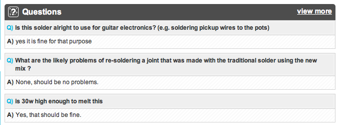

The solder you have purchased is unsuitable for electronics work, it appears to be silver solder for jewellery work and probably does not contain flux.
Purchase some electronics solder, Maplin sell lead free if you are stuck, but I use leaded solder.
This was purchased from Maplin!
Here is a link to the very product!
If the link doesn't work, search for code N31AR
Interesting to note in the Q&A that it appears to be suitable for electronics?

Well, I'm embarrassed to say...
It looks as though my trusty solder station has a fault. Perhaps a break in the cable to the iron, I'm not sure yet until I dismantle and test.
On and off, it was working (sort of) this evening, at one point (no pun intended) I actually had a nice shiny tip!
So it looks as though it's not getting hot enough. (obviously I don't do enough soldering any more to simply hold it under my nose and think 'yeah that's hot enough')..

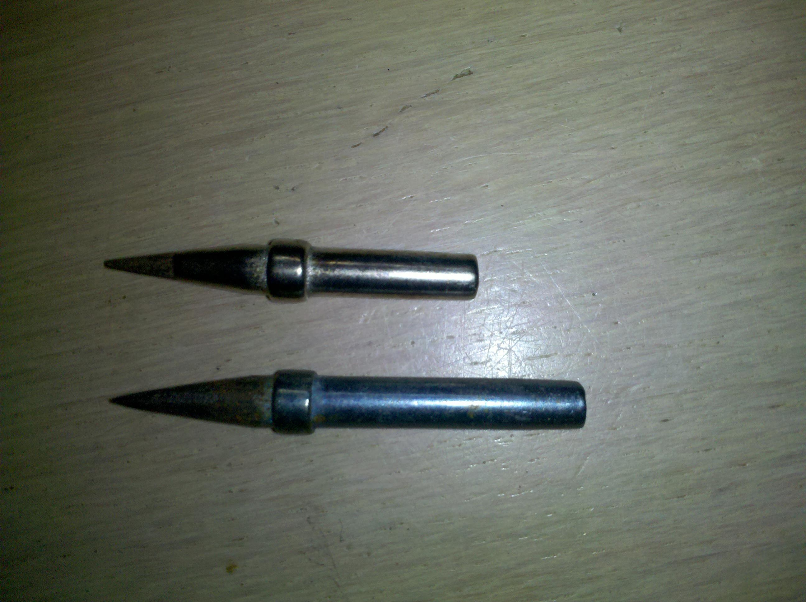

And here lies the problem.
Well gentlemen, I have found the problem.
Maplin kindly issue the following instructions:
"Please note: If your item has been purchased prior to 2008 the order code for your spare tip would be order code N71AP"
And yes, those were the bits I ordered.
However, they are the wrong bits for my iron!
Mine takes the longer bit - "N71AP" are the shorter bits! No wonder it doesn't work properly - I don't know how I missed this when changing them over.
