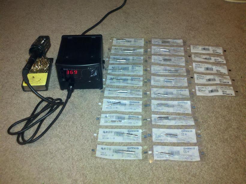

If you can get a Quick soldering station over there it should be cheap, I have their copy of the Hako836A, and it is magnificent, calibrateable, very accurate and repeatable temps, I have left it on overnight many times and over the years I had it I think I replaced one bit. And the iron was just over $30, also comes with a nice cast iron holder.

I bought two old soldering stations on bric-a-brac sales, this was a rela discover I won't never go back to temperature unregulated irons. The first one is a Magnastat Weller, the second, even better, is a Pace MBR-200E, which I found incredibly comfortable. However its tip is at the end of its life and despite having spent hours on the net searching for a replacement among various manufacturers, I couldn't find any with the requirement of 1/8" shank (original Pace part numbers : 1121-0130, 1121-0131 and 1121-0132). I will be happy if anyone can help (Europe).
