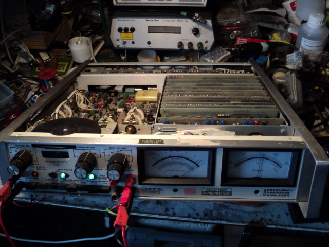

Just acquired 2 of these Solartron 1310 Frequency Response Analysers, one still in the post. A pic of the unit below.

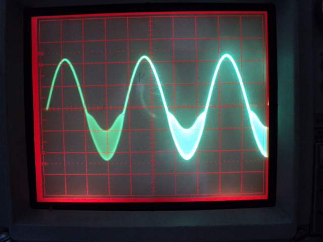

The first one I ran up on the bench today; some life with the Volt Meter circuit working but the internal Signal Generator has a fault which gives something like ramp shaped output waveforms for the lower frequency ranges and asymmetric 'oscillations' on the negative half cycles at higher frequencies. Pic of the 'scope showing higher frequency output below.

My experience with Solartron/Schlumberger instruments is that they tend to have dry solder joints... Knocking the PCBs might reveal some.
Thanks for the point about dry joints, have removed. cleaned and replaced the DIL ribbon connectors which improved things but the 'tapping' method hasn't thrown anything up.
One interesting result:
a bit of 'random prodding around' has found that the case voltage of an RCA 40362 TO5 Transistor, ID'd as Q23, is at +5.2 volts; but of much more interest is that the applied meter prod 'load' removes the -ve half cycle oscillations and also corrects the sinewave output voltage to the correct level... so might have located one area of one of the circuit boards to now fault-find further.

First of these Solartron 1310's now working and measurements on it using a 'series CR test circuit' give the same results as other Instruments that I have.
Q23 replaced with a BC461, plus a small value cap added, cured the internal Signal Generator instability.
Time also spent cleaning edge connectors to PCB's and ribbon cables.
Very good considering the Instrument was made back in the 1970's!
