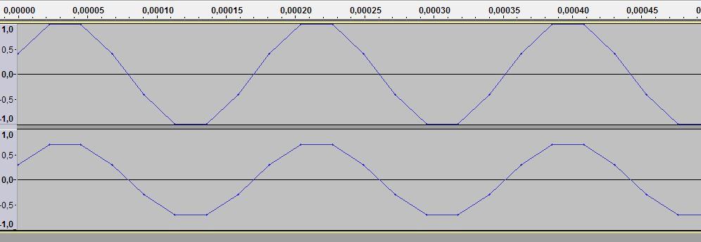

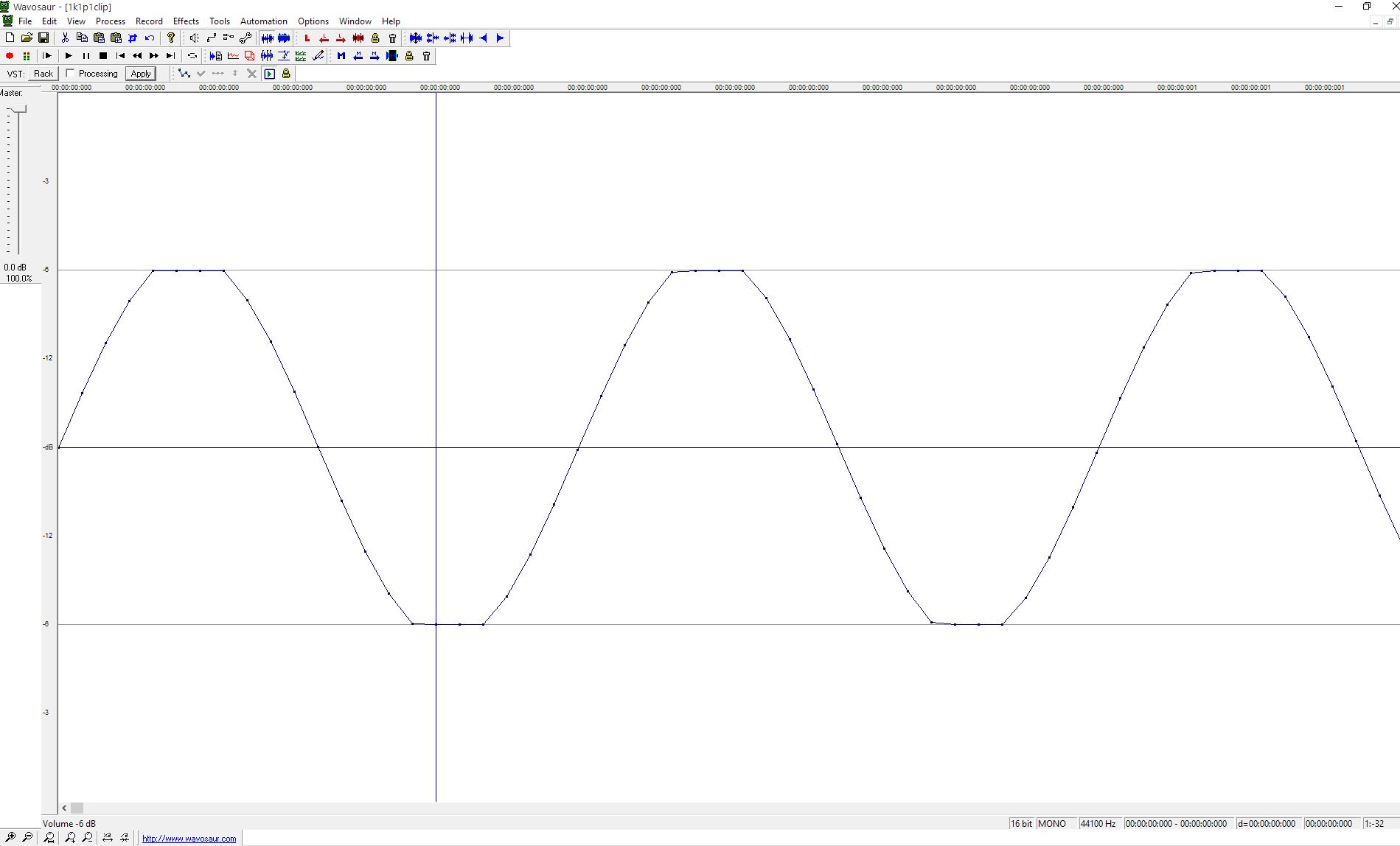

I have made some examples of sine +0dBFS signals for evaluation.
THE ANALOG VOLUME AT SPEAKER SHOULD BE -40 dB DOWN
to not burn your tweeter!

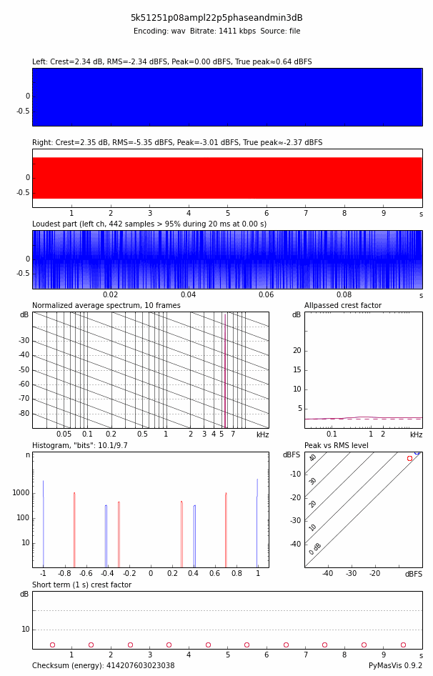

*44.1 fs, 5512.5 Hz sin stereo wav file that has 22.5 degree phase change and 1.08 (linear) amplitude in left channel.
Right channel -3dB with left as reference, or 1.08 / sqr(2) = about 0.76 linear.
1.08 linear is about +0.67dBFS so the rigth is about -2.33dBFS.
Assumes that +/-1 top linear corresponds to 0dBFS

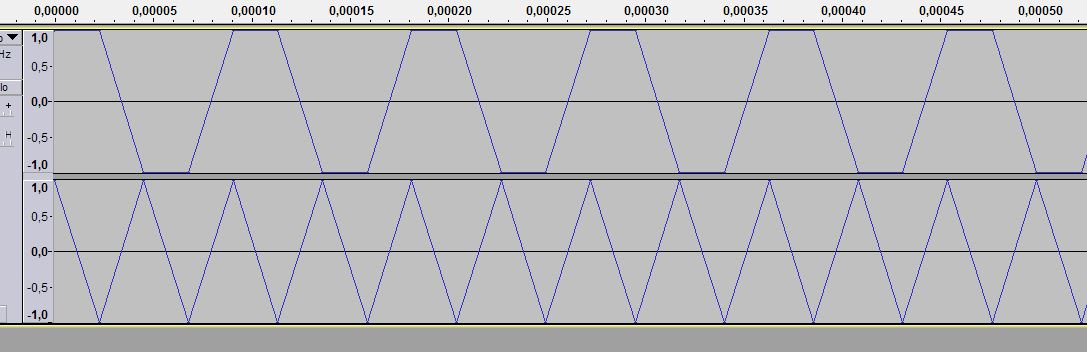

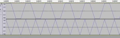

* The second one is:
Freq = 22050
SF = 44100
Phase = 22.5
Ampl = 2.6 , 8.3dBFS
Left channel:
Freq = 11025
SF = 44100
Phase = 45
Ampl = 1.41, 3.0 dBFS
Again mind the volume so that no tweeters are harmed!!!

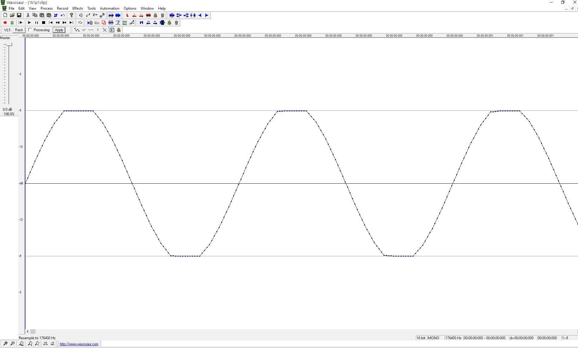

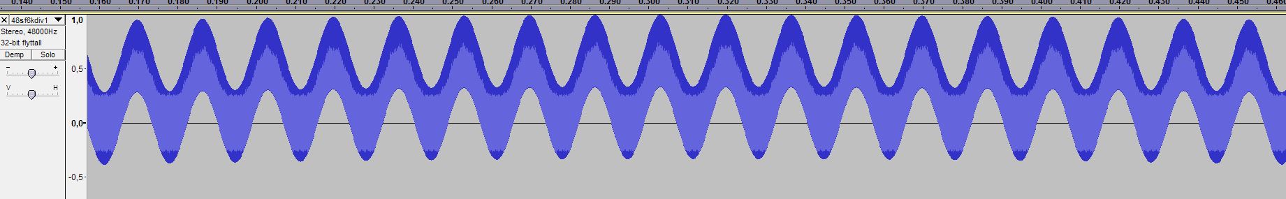

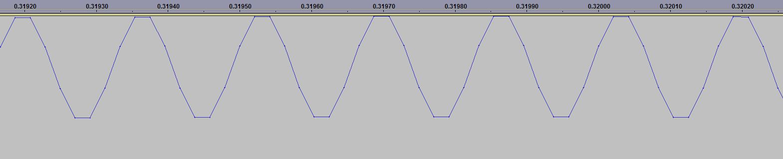

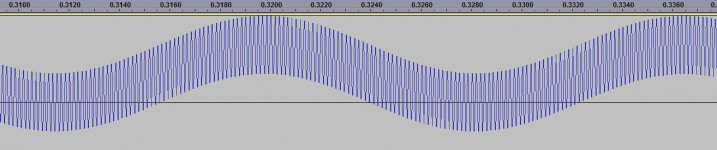

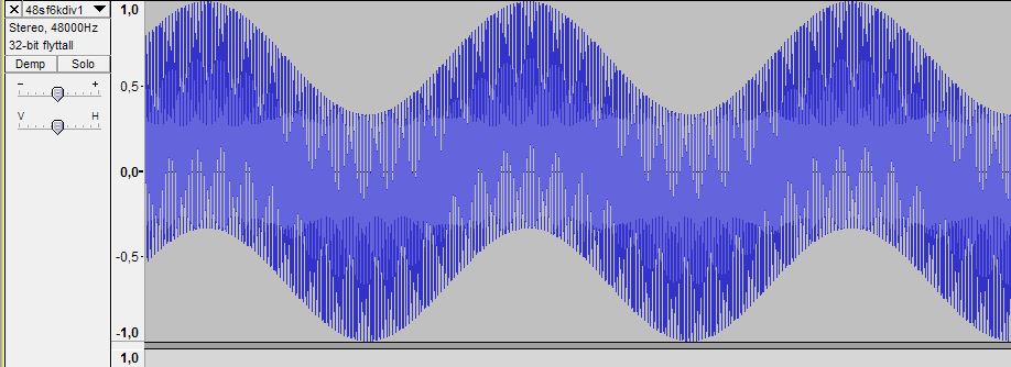

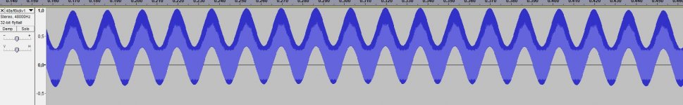

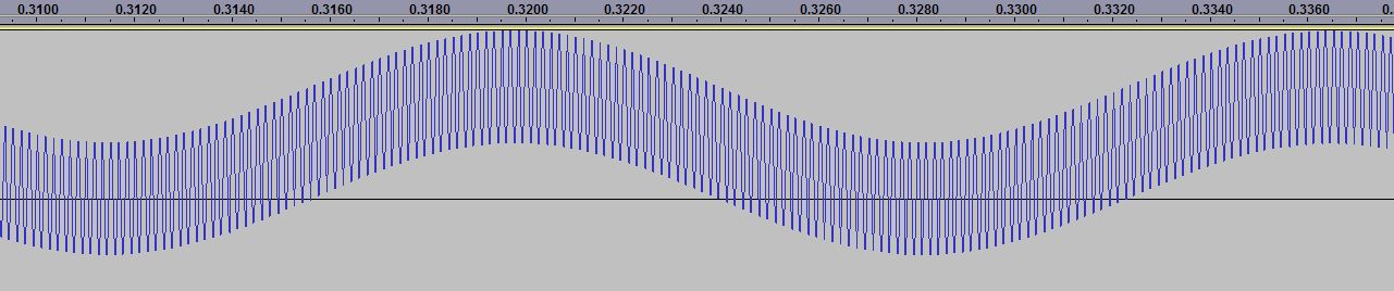

* Last a more real life like signal that is a HF sine modulated on a bass sine that is again modulated on a sub 1 HZ sine.
I made the "same" signal in two samplerates, 44.1 samplefrequency and 48.0 samplefrequency.
The 48.0 sf wav file is
sine at 6k phase 22.5degrees ampl 1.08 +
sine at 60 phase 22.5degrees ampl 1.00 +
sine at 0.6 phase 22.5degrees ampl 1.00
That means no samples over +/-1.00000
Top values at +0.67dbFS
This is more like overcompressed music that is not clipped.
The signal will produce artifacts and distortion that is easily heard if the chain don't treat +0dBFS signals with grace.
Again: BE CAREFUL WITH THE VOLUME AND YOUR EARS!!!!! Attunate 40dB or more before speakers.
The other file is 44.1kHz samplerate, signal scaled to 5k5125. The same artifacts should be heard or the chain is OK regarding +0dBFS signals.
I think the cain should also be able to handle these signals played with no digital attunation at the source.
Enough digital attunation at the source should make the distortion go away.

I'm planning on adding support for this to PyMasVis. Just have to find some time to implement it correctly.
That is great news. I really like your program!

Note that the 22050 @ 44100 example fails to satisfy the sampling theorem (assuming the response extends to DC), that is not a valid set of samples.

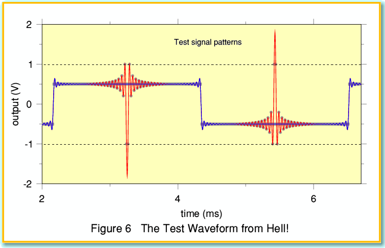

Intersample peaks are a known thing and come down to the fact that while you can digitise any signal that fits and reproduce it, not all sets of samples are reproducible.
Consider a sample sequence that is just +- full scale depending on the sign of the impulse response of the reconstruction filter, this is the pathological case and pretty much nothing will reproduce that.
There are at least two views on the subject of intersample peaks, you can take the view that the correct response is "So don't do that then", or you can attenuate by some arbitrary amount going into the DAC or lossy codec, 6dB is usually sufficient and is easy to contrive with a small amount of programmable logic if the DAC lacks the ability to do it internally.
Regards, Dan.

Yeah there should be a DC alias since 22050 is not < 44100/2
But i guess 22049.999999999999 could go on for a while before samples goes over 1.

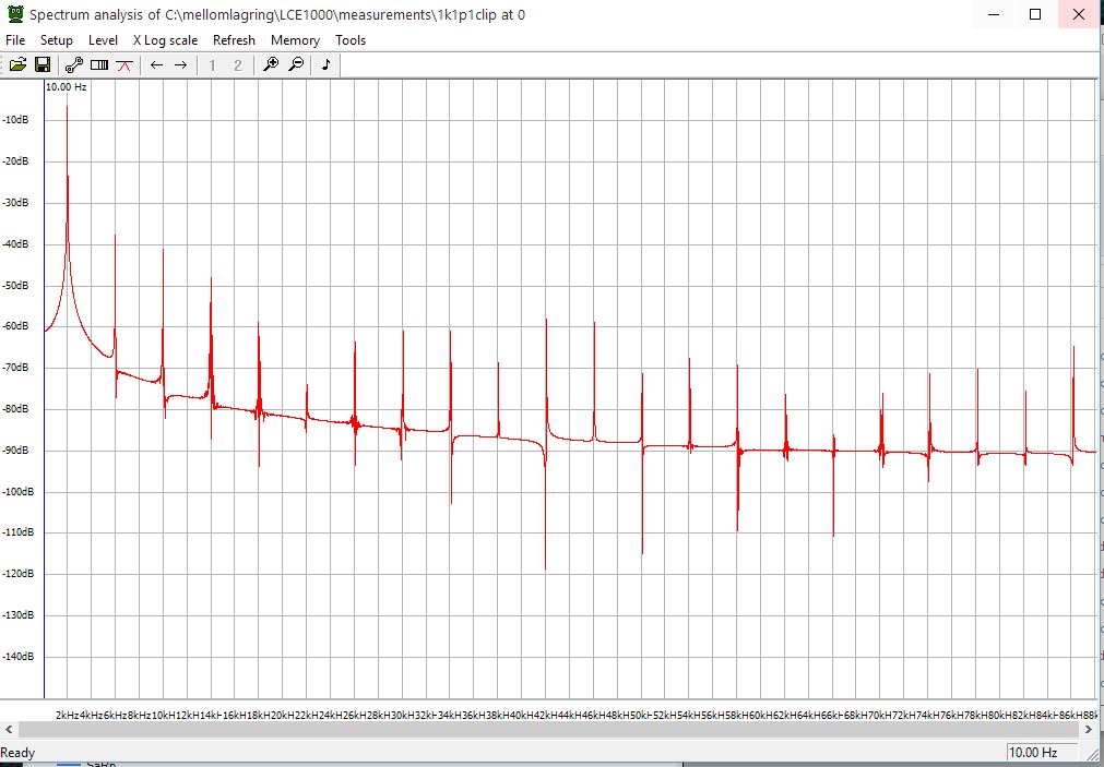

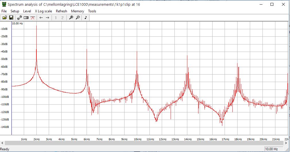

Got an idea (or maybe i have read it somewhere) how to, in a crude way, detect digitaly clipped signal.
A sampled signal is bandlimited to half Nyquist.
If no digital clipping or compression has occured there are no added frequencies over half Nyquist.
If oversampleing reveals frequencies over original half Nyquist there has been compression or clipping.
The enclosed pictures shows a 1kHz, 44100 SR, phase 0, peak -6dB, sine that has 1.1 linear peak, but are clipped at 1. (All sine values over 1 or less than -1 is set to 1 or -1) See first picture.
Second picture is FFT of the signal.
Third picture is the signal oversampled 4x linear.
Fourth picture is FFT of oversampled signal.
We can see that the clipping distortion is easily seen over 22050Hz.
Editor is Wavosaur free audio editor with VST and ASIO support
It is crude, but it it is easy to implement and we dont need to know more of the original signal than that it is properly bandlimited to <SR/2.
It will not detect subtle compression that is LP filtered or has no residue outside original SR/2

...a known issue that can produce "higher than expected" peaks in a amplitude, bandwidth limited digital waveform is illustrated by the "over 0 dB fs problem"
illustration from: Over The Top?
shows what you can get by deliberate construction, applying the realistic limit that real DAC hardware will amplitude limit so the "run up" to the "over" has to be both amplitude and bandwidth limited
by "eyeball" that isn't an "infinite" slew rate - 2x maybe?
