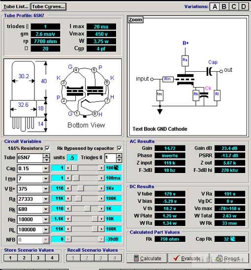

Software analysis using tube analog circuit Audio Note Kit 1
[FONT=&#23435]用电子管模似软件分析[/FONT]Audio Note Kit 1[FONT=&#23435]电路[/FONT]

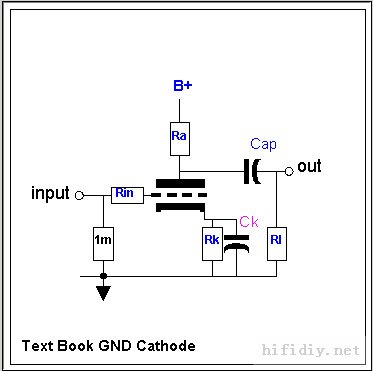

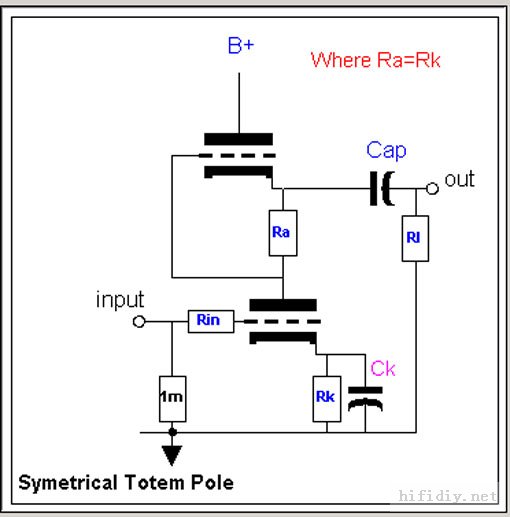

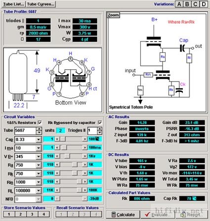

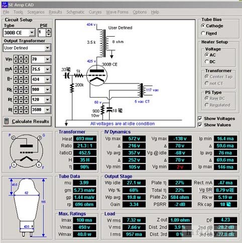

AUDIO NOTE Kit 1 [FONT=&#23435]是一款非常简洁的电路,无论从电路的结构上、还是选管上,都体现了名家之气、大将之风,实为[/FONT][FONT=&#23435]简洁至上[/FONT][FONT=&#23435]的精选。[/FONT]
[FONT=&#23435]通过电子管模似软件对电路的分析,进一步了解该电路的内含。[/FONT]
[FONT=&#23435]附:电子管模似软件。[/FONT]
AUDIO NOTE Kit 1 is a very simple circuit, in terms of the structure of the circuit, or the EAC, it's always embodies the masters of the air, commanding the wind, and to "simple first" selection.
Through the tube analog circuit analysis software to better understand the circuit contains.
Attachment: tube analog software.
