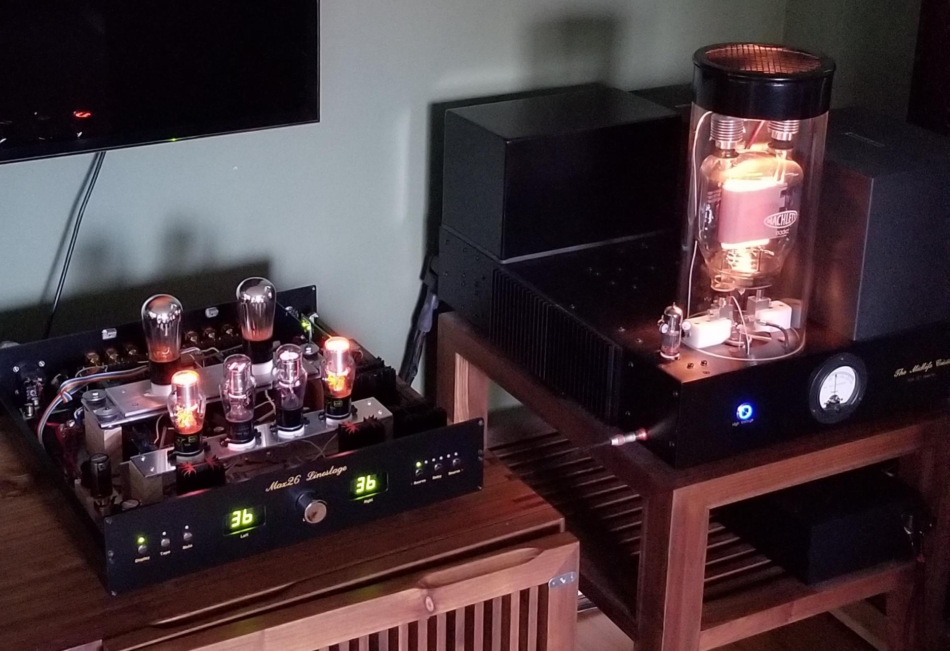

Well, 7 years of 2.3kV plate voltage at 160mA in my amps and I'm not suffering any radiation burns as of yet...
