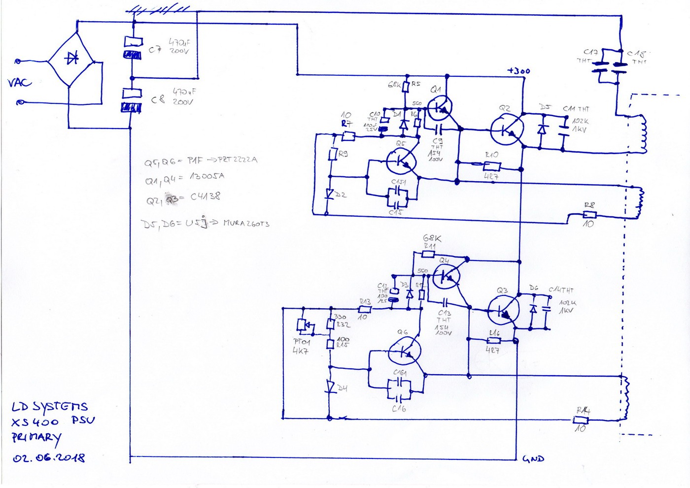

Hello BeardyWan! Were you able to find or resolve anything about it?, I am researching this, trying to find a soft start for an SMPS source, at the input it only has an NTC Thermistor mf72 1.5d25" 1.5 OHM 20% 10A 27.5MM as protection or soft start, but this is still not enough for the circuit , since it is delicate and fails at some startup; then it will be necessary to add some limiter to the circuit at the secondary input or output towards the source output capacitors, but I am in doubt about what to do, the circuit that I need to protect is quite large. basic and unstable at startup
