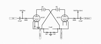

I figured I could throw in a schematic overview of the actual buffer circuit.
In = Signal in from the dac. (One regular and one inverted.)
Output = I tap the output for a servo circuit
B1 & B2 are the actual power supplies.
Bias is simply where I hook up the bias supplies.

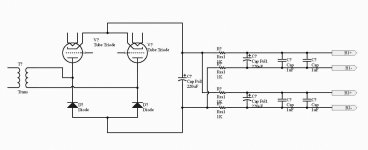

I'll trust you if you say it's a good match but I don't speak russian and since this is my first try at tube rectification it's kind of difficult just winging it?
I'm aiming for 150VDC and the transformer is 150VAC.
Do I just replace two SS diods in a bridge (creating a hybrid bridge)? How many volts will drop over the tubes?
I would add this damper diode in series with a filter choke, between filter capacitors. In such case you are not limited in capacitance domain by peak tube current.
I don't know exactly how much damper diode drops, I did not try it for myself, but I know it will work.
