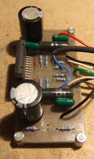

I'm trying it at the moment in an active set up to mute the noise of the crossover starting up. The only issue I have found is that with the relatively low rails, (15V), I'm using I have to use a 2200uF cap to get a long enough delay whilst keeping the resistance low enough to sink enough current. I may well go down the route of using a RC delay to drive a transistor and relay simply to make it a little more straightforward.
Here's a pic of my single sided LM4780 PCB I posted here a while back. Note the two holes for the cap just between the two resistors at the bottom, that's the space I have to work with. 😉
