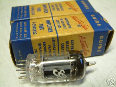

so, who made General Motor's "AUTRONIC EYE" tubes?
I got ahold of a few NOS 12au7 real cheap, that were manufactured for GM in the "AUTRONIC EYE" auto headlight dimming circuits.
I doubt that they are stellar for audio, but I couldn't pass up the price. Does anyone know who made them or what flavor of 12au7 they really are? They have a strange little flange toward the bottom of the glass.

How 'bout this:

HA! I have a schematic, but no use for it. Maybe I could make one and hook it up to my truck just for kicks. But seriously, if those tubes are decent GE or RCA, I'll be using them for audio for sure!
Yikes!!
That looks nothing like any GE or RCA I have ever seen, and I have 100's of them !
Me, I would try them. But I am crazy like that! Looks like I'll be trying to compare many other odd branded tubes in my collection to see If I have any unusual flared base's like that.
Gene

That's a Tungsol tube, the EIA code for Tungsol (322) is visible
on the tube. That's one nice 12AU7 you got there.
Tungsol also made auto headlamps and turn-signal flashers,
so it makes sense that auto-parts companies might buy
tubes from them as well.
funky flared 'AU7
Originally posted by: UncleNed
That's a Tungsol tube, the EIA code for Tungsol (322) is visible on the tube. That's one nice 12AU7 you got there.
My god it sure is! :drool:
I've got 5 RCA long plate 12AU7A's w/side getters! And I'm keeping them for something... 😀

Uncle Ned to the rescue! Thanx for the info man.

Aletheian,
I think it's safe to say that those TungSol 'U7s will either make or play music.
