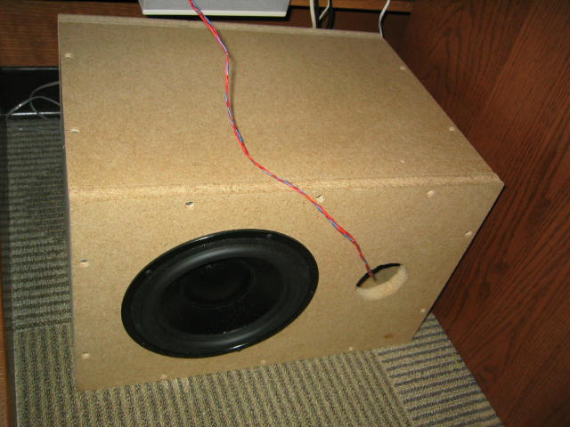

I wish I had time to learn how to use all the neat software. I have way too much school to deal with. I am sneaking home this weekend and taking advantage of the power tools. So I am just going to build a box and see how it sounds. I decided Dayton 8" since there really isn’t any room in my dorm room for an 18"X18"18" sub. For the vented design it takes 14"X14"x14" box, i was wondering if could reduce one of the sides by 2 inches and make another longer. I would like to fit the box under my desk.

Richie V6 said:For the vented design it takes 14"X14"x14" box, i was wondering if could reduce one of the sides by 2 inches and make another longer. I would like to fit the box under my desk.
Thanks for all the replies.
Sure you can, as long as the interior volume stays the same.
Jack
assuming that you will be using a 2 in. port and 3/4 MDF and the 70 watt PE amp...
You can get W 14 x H 14 x D 16 tuned at 30 Hz with a 7.9" port. You'll have a F3 of about 30Hz, I'm no pro but it relatively flat and should work for you. Everything included in the box, drivers amp, so you don't need to add them if that plan is how you would want to go, but...
Try using WINisd beta version, it's easy to use and doesn't take long to figure out. You can plug these specs in and get what you need to get started with it.

Thanks for the help guys shes done and sits under my desk. My port is on back order but so far it sounds good. After listening to this thing i think i am going to move it some where else in the room. Its really loud i dont think its good for my hearing or genitals.😀
