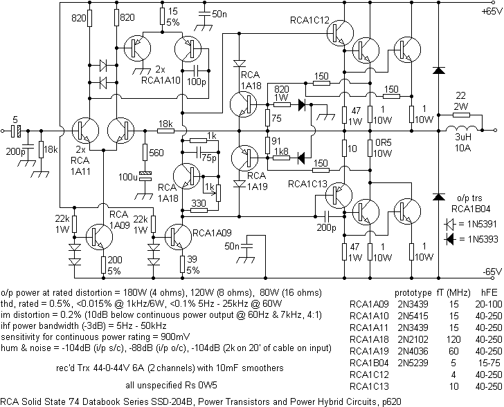

first piece of audio equipment i ever (successfully) fixed. it had a blown output stage in its left channel and a NASTY fault in its PSU that was basically shorting the secondary of the trafo through the filter cap due to shorted rectifier diodes!
the thing that really blew my mind is that this RCA had no fuses/breakers in it whatsoever! not even in the mains line !!! so if that baby were left on in the condition it was in the secondary would be shorted and would heat up/melt until it caught fire. i of course installed mains, secondary and rail fuses but really, what were the design engineers thinking at the time? now those were some REALLY confident guys ... bet they had women all over them ! 🙂

now if anyone has a schematic for this thing (or a similar RCA product) you have just made a friend for life. heck i'll even send you all the money i have in my pocket right now at this moment ... seriously!

So, what do you have there? A couple of TO-66 case (early Si NPN?) devices in totem-pole, driven by a split-secondary transformer?
4x 2SC830. TO-66 case. quasi-complimentary configuration. 200W per channel. distortion characteristics unknown, but believed to be good due to the # of compliments received of the sound quality. the trafo is split secondary but the PSU is configured in an unusual way. the CT is ground, but there is a rectifier diode going from each hot leg of the secondary to the + rail, with the cathode pointed to the + rail and the anode toward its respective hot leg. there is no - rail. so rail voltage ends up sqrt(2) * 1/2 voltage between hot legs of secondary side of trafo.
hence why when those two rectifier diodes shorted the trafo was shorted across the reservoir cap. between one hot leg and CT on the top half of the cycle and the other hot leg and CT on the bottom half.

200 wpc from 4 2SC830's? Not a chance. What's the rail voltage, 60V maybe?
The old-school 2-diode center tapped bridge is the way they used to make B+ supplies with tube rectifiers. It had he advantage of reduced secondary current over a 4-diode full wave. You don't see that much anymore, except for low current supplies.
What I was referring to about 'split secondary' was the driver transformer. A lot of amps from that era used them, as opposed to a compelmentary driver transistor pair. You'd see it done with old PNP Ge stages all the time (those were usually TO-3's). The trafo had two secondaries, each one driving the Vbe junctions of the output pair out of phase. It had the advantage of separating the DC (bias) from the AC (signal).
wg_ski said:200 wpc from 4 2SC830's? Not a chance. What's the rail voltage, 60V maybe?
76V last time i measured it. and since P = V*V / R its easy to see P = 38 * 38 / 8 = 180W. actually a 7.22 ohm load would be required to drive it to a full 200W peak. so 100W rms per channel for 8 ohm, 200W rms per channel for 4 ohm. handles 4 ohm loads nicely. vibrates dishes in the neighbors house if i get too trigger happy with the vol control 🙂

oh i see you mean a trafo between the VAS and OPS to set the bias in the OPS by feeding the bias voltage into the CT? to be able to use non-complimentary devices?
no this amp is not configured like that. its just standard solid state quasi topology with bandaxell diode improvement.

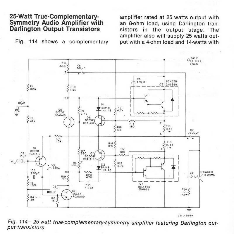

RCA schematic
