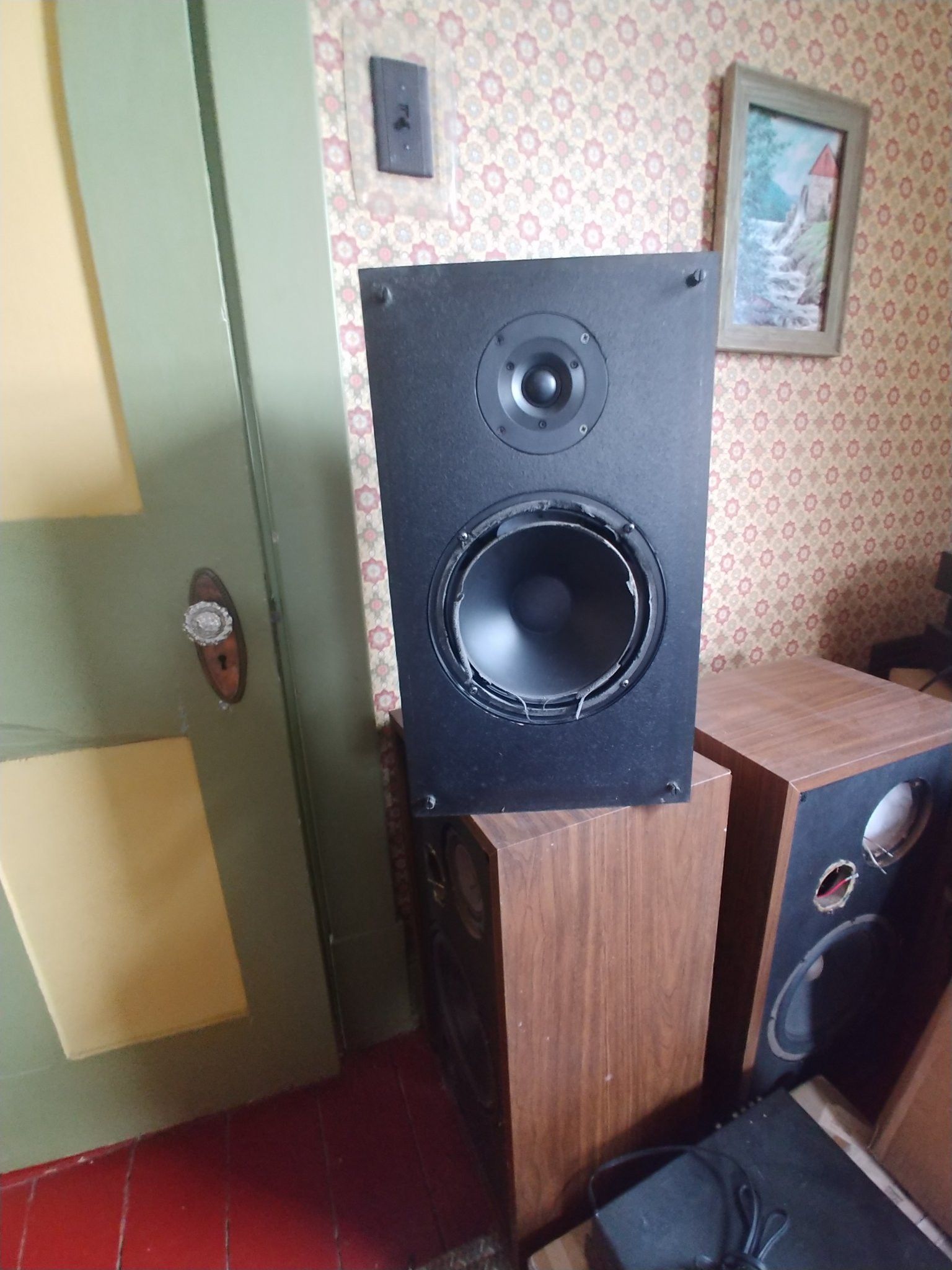

I have complete set of woofers, tweeters and crossovers for a pair of Snell type K mk2. Picked them up at a yard sale and I want to make cabinets for them. Is there anyone who can help me with the baffle dimensions (how far from the top the tweeter sits and how far from the bottom the woofer sits)?

Hi I have an old pair of mk2s with bad woofer surrounds. I took some measurements...the cabinets are 18.5 inches in height. 10.75 inches wide and 7.5 inches deep.
Okay measuring from the top of the cabinet down to the top of the tweeter flange is 1 inch & 7/16th.
From the side of the cabinet to the side of the tweeter flange is 3 inches & 5/16th.
From the bottom of the cabinet up to the bottom of the woofer flange is 3 inches & 5/8.
From the side of cabinet to the side of the woofer flange is 1.25 inches.

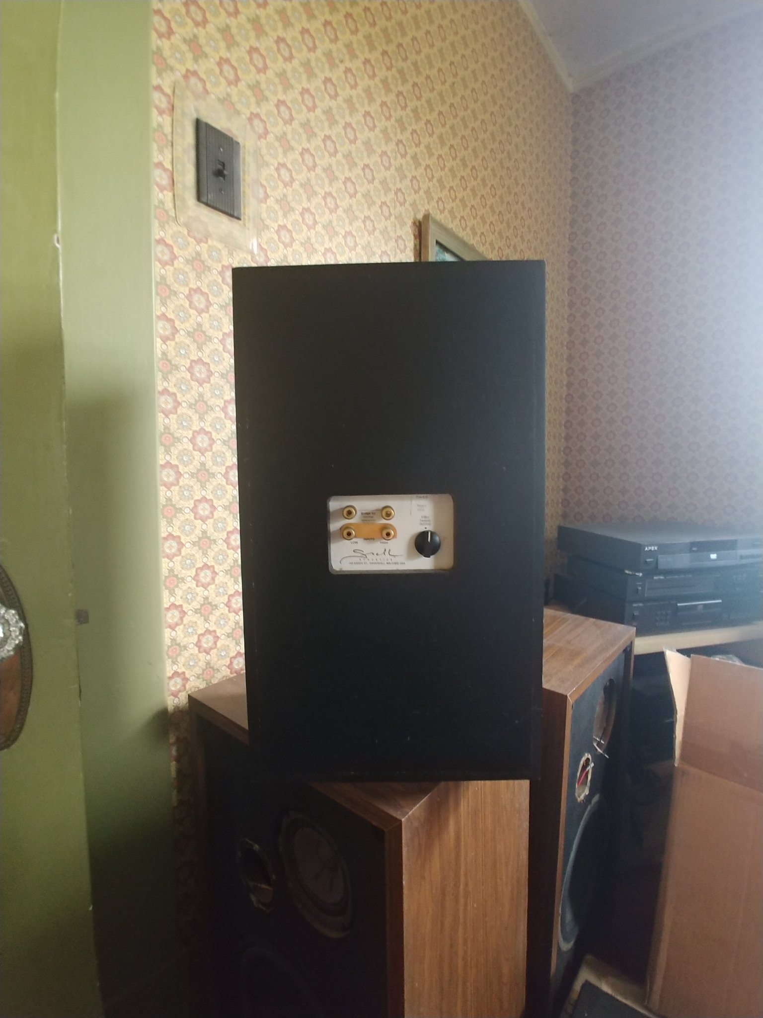

Here is a picture of the back showing the tweeter attenuatorThank you all for the input Dave, Fatmarley and Bathtub! I can not wait,to get going with this project!
