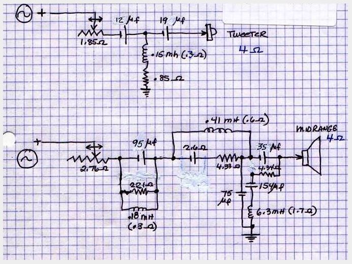

The Type A was a mess. The 10" woofer never really produced much bass. The woofer had a low Q alignment in a too big box. The crossover between mid and woofer was around 300Hz which was way too high for the separation between mid and woofer and left a big hole on the lower midrange. Crossover to tweeter was at 2.5k which was way too low for the Audax 1" dome and resulted in very harsh sound at even moderate levels. Crossover parts were cheap and the crossover itself was overly complex. The speaker really never got decent until the A III. The Audio Critic paned the speaker.

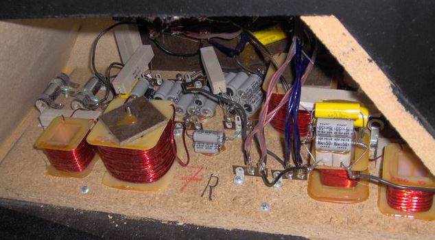

I've recapped an A and those cap bundles are something to behold! Hidden beneath a few of them was a single pico-farad disc cap used to bypass and provide a base to glue the bundle to the board.
Hmm, see what you mean. The schematic and picture of SOMETHING early Snell Type A here...but we can't blame this birdsnest on Dave Smith! 😀I've recapped an A and those cap bundles are something to behold! Hidden beneath a few of them was a single pico-farad disc cap used to bypass and provide a base to glue the bundle to the board.
At least I understand the 4 ohm tweeter filter. 😎
