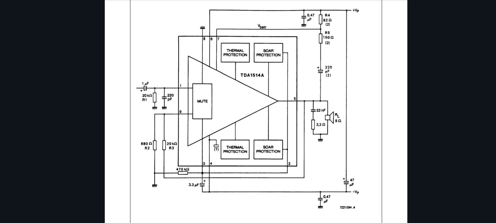

I'm going to put together a couple chip amps, and want to ask if anyone had recommendations for suitable switch mode power supplies that work OK in this application. Going to use TDA1514A and TDA2050, looking for a 24V power supply that can be tweaked up and down a bit, and can be bought off the shelf from mouser or digikey

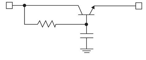

Can you really hang 10,000uf caps on the output of this? As for the capacitance multiplier, you mean this kind of circuit?

What are the consequences of using them "raw", to directly power a chip amp (assuming bypass capacitors are used on the chip amp board, per data sheet) versus having an intermediate filter stage, in terms of performance?
I'm thinking specifically about the TDA1514A here.

According to the lm3886 datasheet the chip needs 1000uF+22uF+0.1uF next to its pins, some of these smps cannot handle that much capacitance.
I guess the capacitance multiplier could be used for that reason and not so much for improving the performance of the amps.

As long as the SMPS can handle the added capacitance it'll work just fine. You'll get some of the SMPS switching frequency trickling through to the amp output, but it's well into the ultrasonic frequency range and usually at very low levels, so it's not an issue except if you include the switching frequency in the measurement bandwidth in a THD+N vs frequency sweep for example.What are the consequences of using them "raw", to directly power a chip amp (assuming bypass capacitors are used on the chip amp board, per data sheet) versus having an intermediate filter stage, in terms of performance?
Older chip amps don't have stellar PSRR at common switching frequencies, so you'll get a bit more of the switching frequency trickling through than you would for a more modern design, but that's the only drawback.
