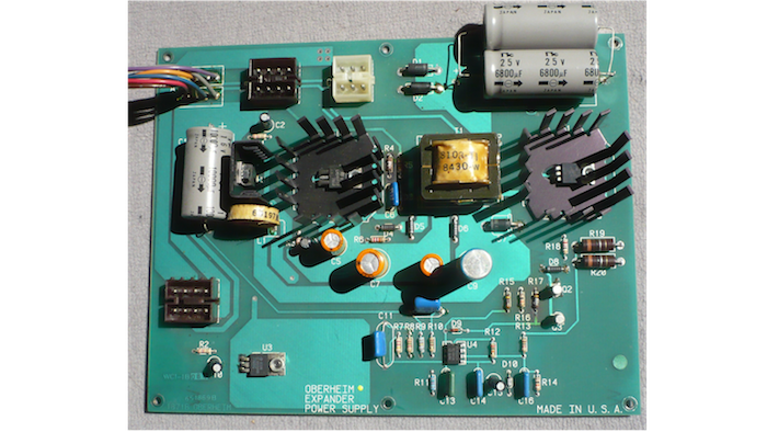

hello, i'm happy owner of a xpander
i have problem with power supply board since two days ..
xpander shout out in middle of project..
resistor R4, R17 had burn out
we replace R4, R17, so the x pander start again, good
but after 2 min, resistor R17 goes too hot again and smoky ..
so we replace also transistor Q2, Q3, and capacitor C15 ..
big signal transformer (fixed on metal case) delivery 13v
and his extension look ok as the guy say .. i don't know ..
What can make resistor R17 overheating ?

hello gmphadte,
D9 , capacitor Q2, Q3, circuit U4, circuit in center of Q1 have been change by new..
the pro technician tell me today,
transfo driver 8103-TI 8430W T1 is not working.
they are no equivalent, we need the original he tell me..
How to find this ?
last chance is to build external power supply for the 4 voltage circuit..

i still looking for this flyback transfo . XFMR 3Okhz from old oberheim period.
Any info welcome ( old stock store ) ..
photos:
14/26/beem.jpg - Visionneuse Zupimages
14/26/j3df.jpg - Visionneuse Zupimages
14/26/k5pz.jpg - Visionneuse Zupimages
somebody know his caracteristic in / out voltage, watt, ampere ?
or what's the caracteristic (watt, ampere) of the four circuits to power the xpander ,
+ 55v. -12v +12v. -5 +5v. 9 vac in case of building new external power supply ..
