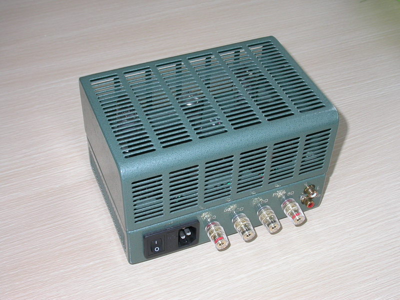

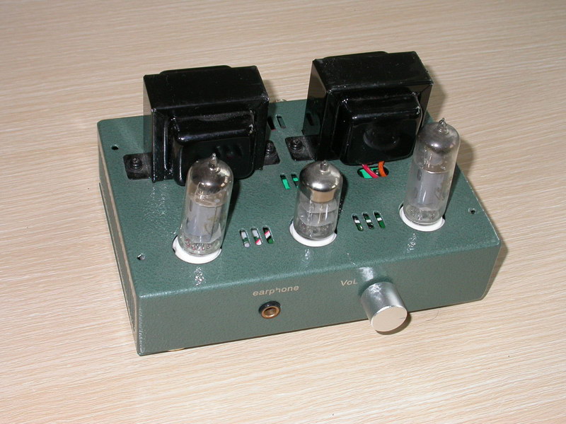

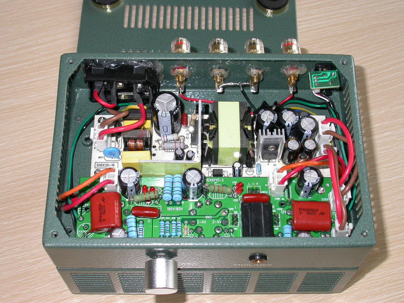

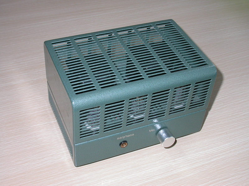

Today I received the SMPS power modules and SMPS powered tube amp. Tubes are 6N3+6P1. It could be used as headphone amplifier as well as 3W small power amplifier. The first impression it's light weight. Don't have time to listen to it. Pics first. I will post more testing result later.

Sorry for so late. It's a time cost work to measure and adjust and measure and adjust. Now we are sure the R2 is in it's best condition. We are also sure it's the best status for a low cost 6P1 tube.
This design has no feedback from the output of the transformer. So the quality of transformer is important for the bandwidth. See the following result:
