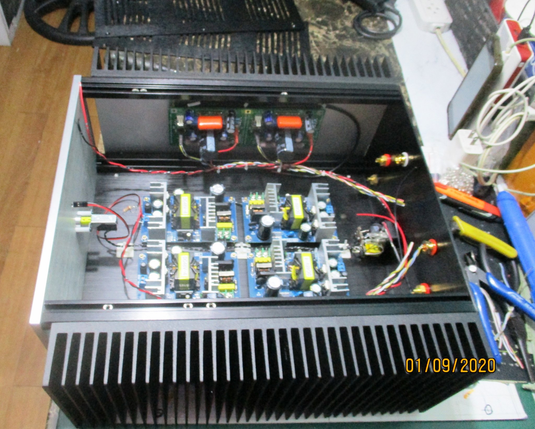

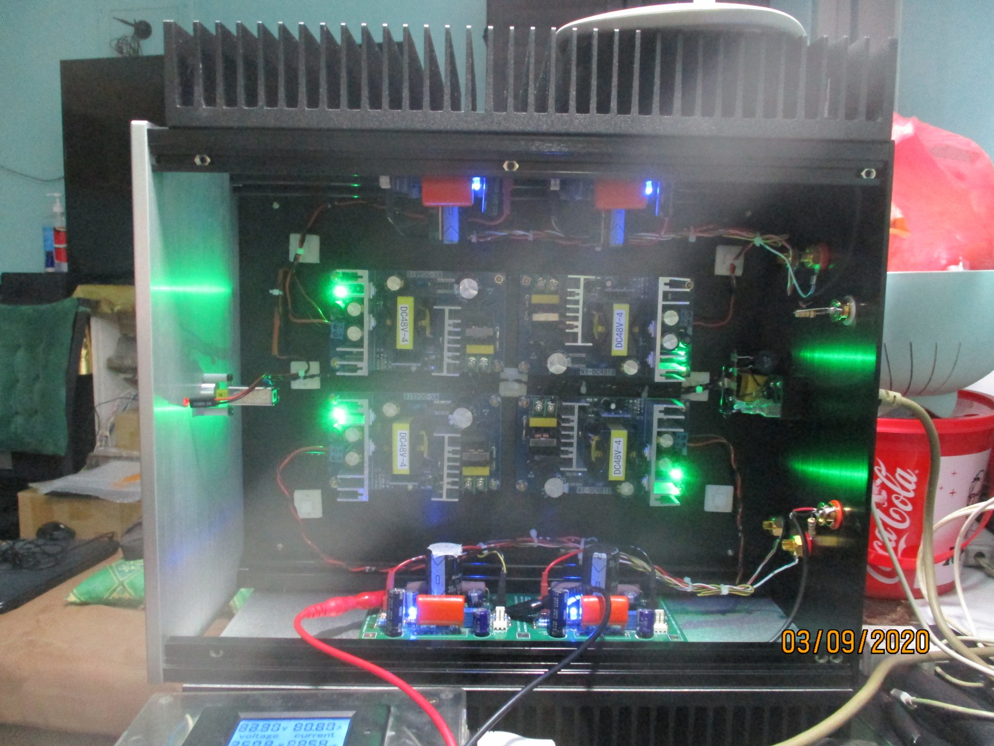

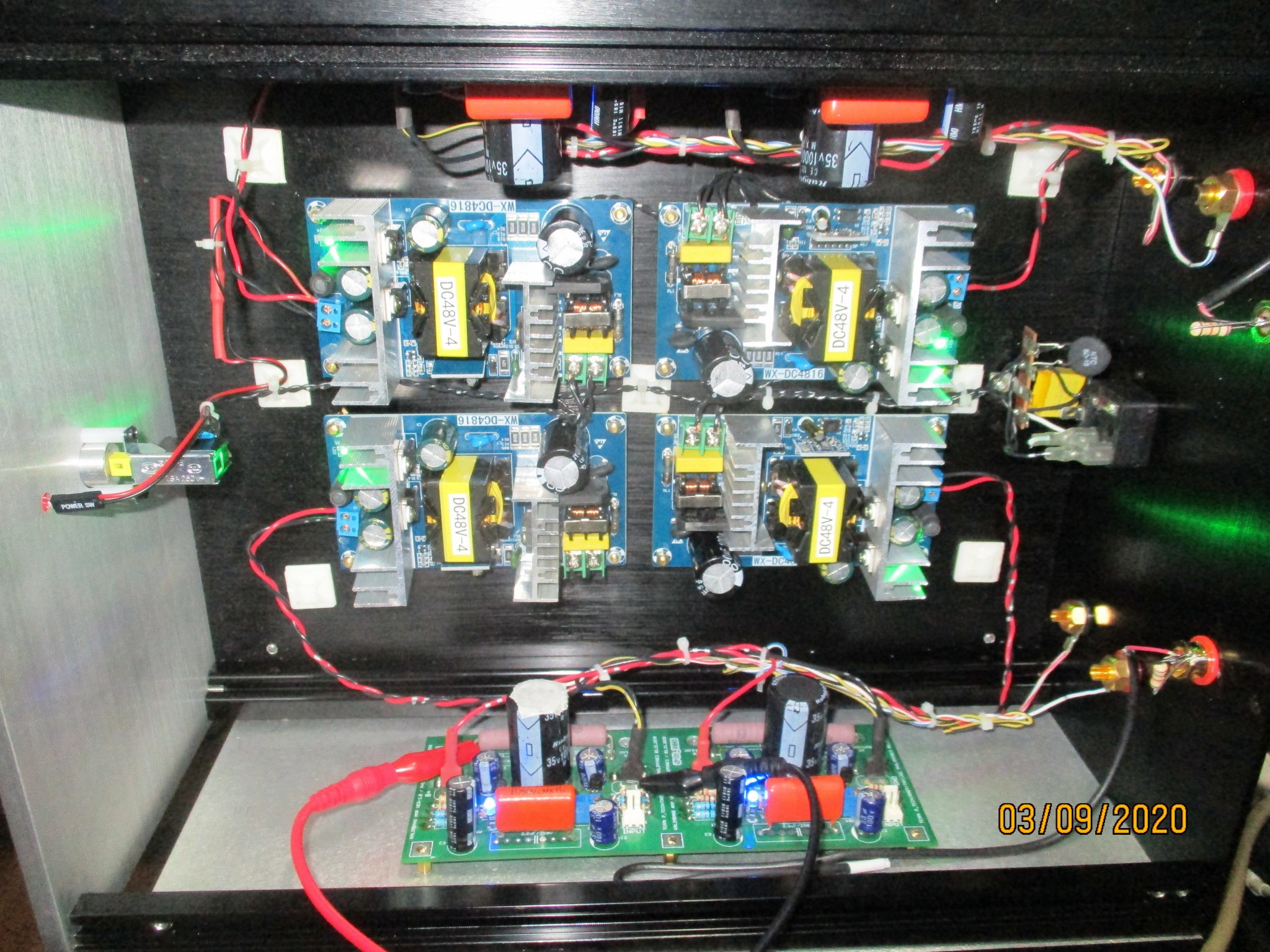

the thing i look out for in an smps is current delivery, not so much about filter caps values, available units come with paralleled 2200/50vdc at the output, for example in my 48v ACA amp which called for 1.4A supply current, i chose an smps brick that can deliver 4A..
