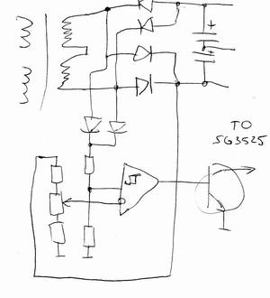

Any ideas how to make car SMPS Current protection? How to make negative rail protection?
I drawed caps backeards
ups.. I want to limit output current. For example - to turn of sg3525 at 8 Amperes in rail or maby short circuit protection. I want to protect the smps from overload. I had made protection via adding transformers in primari side, but it is dificult to make them, and constructive place them somewhere..
And why don't you sense voltage drop across the MOSFETs in the primary side during the on period? The own switching devices can act as sense resistors for free, all what you have to do is to take the drain voltage through a resistor and switch it to ground while the device is off (some blanking delay is required after turn-on and before turn-off). Then, a comparator feeding the shutdown input of the SG3525 produces a nice pulse-by-pulse current limiting (remember to add slope compensation if you use regulation).
Furthermore, as Rds-on increases with temperature, the current limiting threshold will be lowered as the transistors get hotter.

I have successfully designed an overcurrent protection without resistors, based on mosfet Rds(on) for my Class-D amplifiers, but I want to raise a question:
If you try to apply that principle to a CAR SMPS, where mosfet losses are very low (typically in the order of 5 mohm when parallelling a couple of them), you will get such a small sense voltage even at high currents that perhaps it would be impractical to detect them (we are talking about 250mV for 50A primary current) without false-triggering due to noise spikes (or being too slow if it is heavily lowpass filtered)
I don't like the sense resistors solution either, due to increased losses, size and PCB routing inconvenience, so the only practical solution I can think of is the use of a current sense transformer. However, making a CS transformer for such high currents (say, 50A) is not easy and even difficult to find in commercial catalogues.
What do you think of this?

Careful design and layout allows to obtain quite clean 250mV current sense signals. I'm also working in class D stuff now, and I'm successfully using 0.020 ohm shunts.
Note that any class D circuit is inherently much more noisier than any push-pull car SMPS due to direct switching across conducting diodes.

I've used a small piece of copper wire and connected sense wires on each end for voltage drop detection. I twisted them together and around the positive supply wire. I like to detect the supply current to the power transformer. I find breaking the ground connection to the MOSFET sources inconvenient in terms of part layout.
