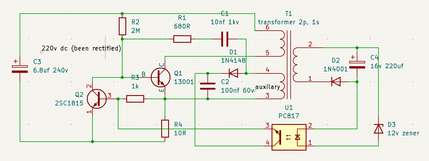

At the moment, im considering the option of adding a very small, simplistic self oscillating 12v smps (similar to the sort of smps you might find in a phone charger brick) to the tl494 control board so that it can have its own supply, removing the need for the main transformer to have any auxilary winding, and removing the complication of initial transistor pullup on the half bridge. Would love to hear some relatively simple auxillary ideas 😁.

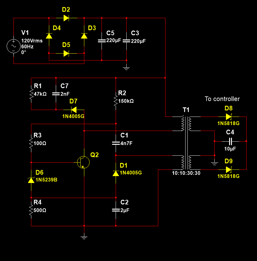

Drew this little smps up that could be dedicated to supplying the tl494:
the R4 10ohm current sensing shunt resistor could always be changed depending on how much current the tl494 will draw, driving its gdt

A little house keeping supply is a good way to go. I don't have an example handy but I have seen startup resistor/capacitor dividers that are removed from the circuit right after startup. Here is a more appropriate house keeping supply I copied from somewhere and changed to fit my needs. It's frequency and quality is fairly dependent on the transformer.
