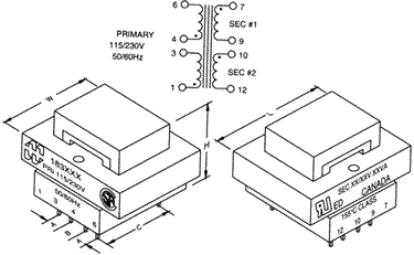

I have been working on my latest project, and right off the bat Ihave hit a snag. I am using a Hammond 183K12 to power the heaters of 2 6AS7G and 2 6SN7. I Connetect the transformer as follows: (the bottom transformer is my Hammond 269AX for the PSU section)
When I turned on the power, the transformer started smoking, and I quickly cut power. I disconnected everything from the secondaries, and turned it back on to test the voltage, and unfortunately I got zero. I have ordered another transformer, but I'd like to knwo what I did wrong. I am about 99.9% sure I wired it as shown by my drawing.
Any ideas? Thanks in advance.

Your diagram is okay. How fast did you say it smoked? I assume you did check the heater currents against the Hammond's ratings. I haven't yet. You always leave some headroom there.
But even still, I've not seen a transformer smoke quickly unless it's high current and the winding is shorted. The hum would tip you off first I'd think.

i have been doin' this for 40+ years and have never made a trannie smoke -- even through the thick and thin of many catastrophes in audio, ham radio and physics labs which destroyed several transformers (I burned out the transformer in my Eico 753 Tri-Band transceiver when I keyed down on 20 meters for too long -- rewound the transformer !)
If you accidentally wire the two parallelled primaries so they are out of phase, the transformer will smoke immediately! Don't ask me how I know this. If the power wasn't on long, there may still be some life left in it. I woudn't use it in an amp, but I would try again before you smoke the new one.
If you look at the diagram on Hammonds web page you will see a small dot next to one of the pins on each winding. Whenever two windings are connected in parallel the pins with the dots are connected to each other, and the pins without the dots are connected to each other. For this transformer, connect pins 1 and 4 together. Connect 3 and 6 together. Connect power to the 1-4 pair and to the 3-6 power. Test for voltage with no load. If you have voltage, then try it with a load.

Well, I may actually have made a mistake then. I ran jumper wires from one 6AS7G to one 6SN7. I then did the same thing wit the other set of tubes. Then I ran one winding of the secondary to one of the sets, and the other winding to the other set. However, the windings were never run to each other, so I doubt they were out of phase.

Tubelab is right. If the primaries are out of phase, they will cancel the inductive reactance. The DC resistance of the windings will be the only resistance in the circuit. Causing it to draw way too much current. See this page
http://www.hammondmfg.com/5CHook.htm
The Second example for the primaries is what your trying to do.
My only guess is you connected 2&3 togeather then 1&4 together. Which is bad. If you didn't do that, then I can't see why you fried it. It should be capable of supplying the heater for those tubes.

Not for a series connection. For a series connection, it's dotted-to-undotted to form a center tap, and mains connection to the remaining dotted and undotted terminals. Of course, if you get it wrong with a series connection, you get little voltage. Reverse phase in a parallel connection, and you poof something.

I just checked, and I had pins 1&6 together, and pins 3&4 together. Secondaries: I had pins 9&7 out to one heater, and 12&10 out to the other heater.
For 240V operation connecting two windings in series out of phase will get you lots of smoke! (Particularly if you don't use a fuse of suitable rating.)
Just as is the case with an incorrectly phased parallel connection the winding inductance will cancel as a function of the windings mutual inductance (coupling) leaving you with very little more than just the DCR. (And some inconsequential leakage inductance as well.)
