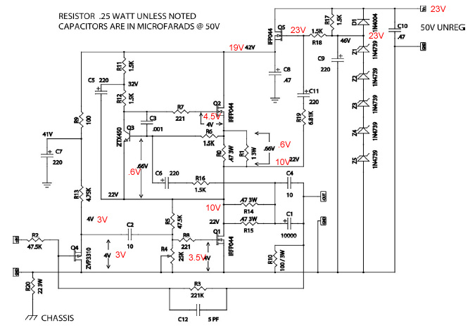

Most probably your Qs are blown. The best course of action I can recommend is to replace Q1, Q2, Q5 and try again. Also, never put a 3 amp fuse - sure way to get stuff fried
Once the Qs have been replaced, put a 150W bulb in series with your primary. You should see following voltages (in red). Any deviations will tell you what the problem is (without causing further damage):

Voltage across R0and R1 is what smoked them.
The very low resistance values of the R0 and R1. The problem is if the volatge raises above the normal 0.66v. With the resistance at 0.33 ohms for the pair, running just 2 volts will put six amps through. With this you are running 6 x 6 x 0.33 or 12 watts.
The 2 volts was just a number, you could have a much higher voltage.
George
