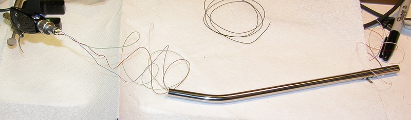

Last night I wired up my spare SME connector with 33ga Cardas tone arm wire and started to assemble the arm. The trickiest part is securing the SME part that carries the ground wire, everything else was very easy.

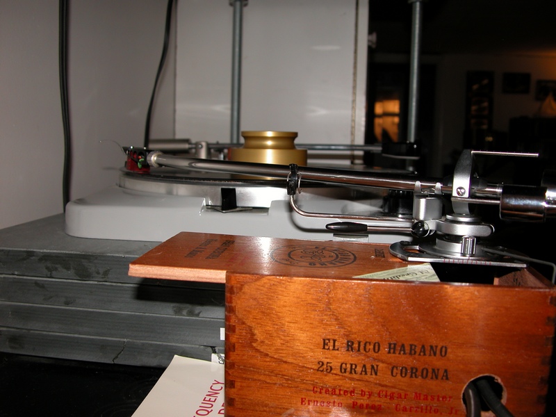

Here are some pictures of the arm..
The one thing I did have to was drill out the two small holes that retain what SME calls the "track" - the part on the arm that is involved in cueing. See the second attachment where the "track" is clearly visible.
Drill out the two small holes to fit your "track"

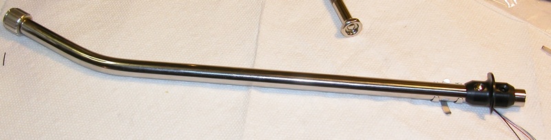

Picture 1 shows the head shell connector after I wired it. Feed the tone arm wiring through the proper hole and out the end BEFORE wiring.. 😀
Install the retaining screw after pressing the connector into the end of the arm.
Picture 2 shows what it should look like after wiring.
Picture 3 shows the knife edge installed. This involves fitting a little T shaped metal fitting with a threaded tube, and a ground wire soldered to it. I found it easiest to use a short piece of wood stick from a swab glued to the piece. I then applied a very little bit of blue tack to the knife edge and pressed it into place over the screw holes. With some patience, and a bright light I was able to visibly align the T shaped metal fitting and thread the first screw into the knife edge and the T.

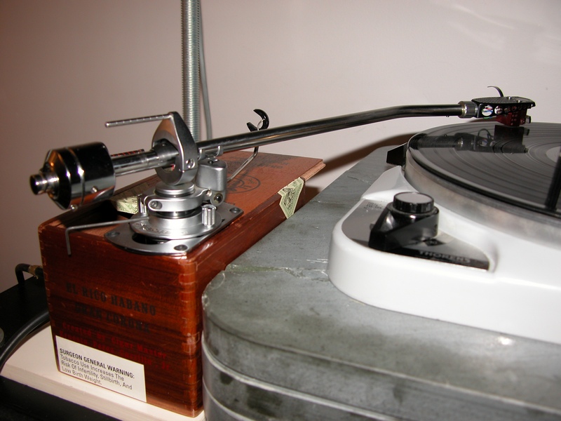

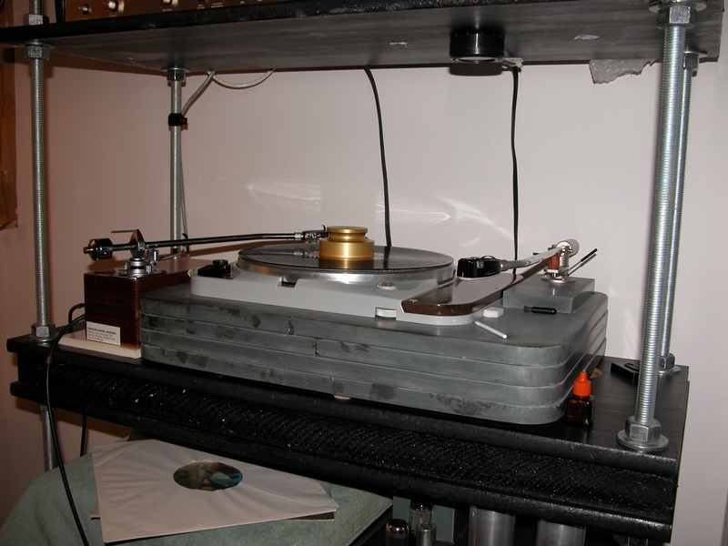

The rest of the process is not shown because I got excited and successfully finished the arm..
The cigar box was a gift from a friend, and I find them useful for a number of purposes, but no cigars will ever be smoked in this house! 😀

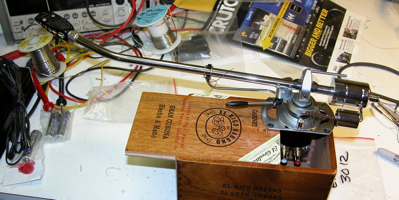

I am fortunate in that I had a bunch of SME parts on hand including the SME head shell connector, bearing pillar, yoke, cuing lift, track and bed plate. I just had to acquire the base connector mounting hardware, a pair of bed plate acorn nuts with clamps, and some 33 ga Cardas litz wire. I didn't have to cannibalize a nice SME 3009 to do the conversion.
The arm together is very nice to look at and in preliminary testing performed well - to the limits of the cartridge installed and considering the cigar box test bed.. 😱 😀
Tonight I thought after several hours of listening to a blameless Meister Silver on the Schick arm it might be fun to put a better cartridge than the Shure in the SME 3012 clone. 😀
The cartridge on hand is a Goldenote Boboli from Italy which is a heavy low compliance HOMC with a surprisingly low tracking force of 1.6gms.
I had to remove the supplemental weight on the counterweight as this cartridge is installed in an SME S2 head shell which is quite light. I was able to balance the arm and set the tracking weight to within 0.1gm using the onboard weight - verified with an inexpensive digital gauge.. Quite good actually.
While this cartridge is not in the league of any of the SPUs I have on hand it is not a bad cartridge on any level - moderate resolution, speed and imaging. Inoffensive - a decent cartridge of a rather laid back forgiving nature...
This arm in no way detracts from its performance, if anything it sounds better in this arm than in any of the others I have heard it in.. (An arm I can't disclose and my SME 3009 Series II) The arm seems a competent performer, and I can only imagine how good it would be with one of my SPUs and in a proper mounting arrangement. I am pleased.. 😀 😀

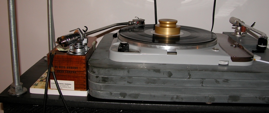

A close friend of mine is making me a standalone base so that I can move the 3012 clone between my two tables. This will be phenolic cylinder with a top plate to match the 3012 bedplate and the bottom of the base will be filled with copper coated lead shot to add some additional and needed mass.
I mounted the Boboli I've mentioned on an inexpensive rigid head shell made by Ortofon, it is definitely an improvement over the SME S2 head shell with this cartridge.

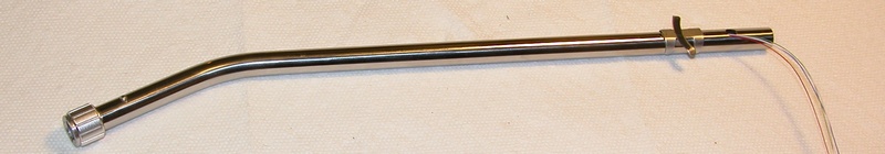

This is the clone with the original wand. The picture on the bottom shows the replacement knife edge bearing which came with the kit. I wasn't sure before of the quality of this item so I bought a brass bearing just in case. As is, the kit bearing seems to be of good quality build and is metal, not plastic. If I'd been certain I wouldn't have bought a different one.
The arm was re-wired with Cardas. On the above picture you can see some bamboo skewers. These were what I used for the earth post inside the tonearm. Just split the end a little and used this to hold the post (like clips) and line it up.
The only issue I had was with the arm-lift. The original was not a t-bar lift. I could have used the original bearing with the track as seen but the brass bearing was installed already.
The wand of the clone though had the holes underneath to fit a track like in earlier models. I looked for these tracks and wands that may have them still but no joy.
I ended up buying a t-bar arm-lift which I refurbished for the arm. Fitted it and all is well.
