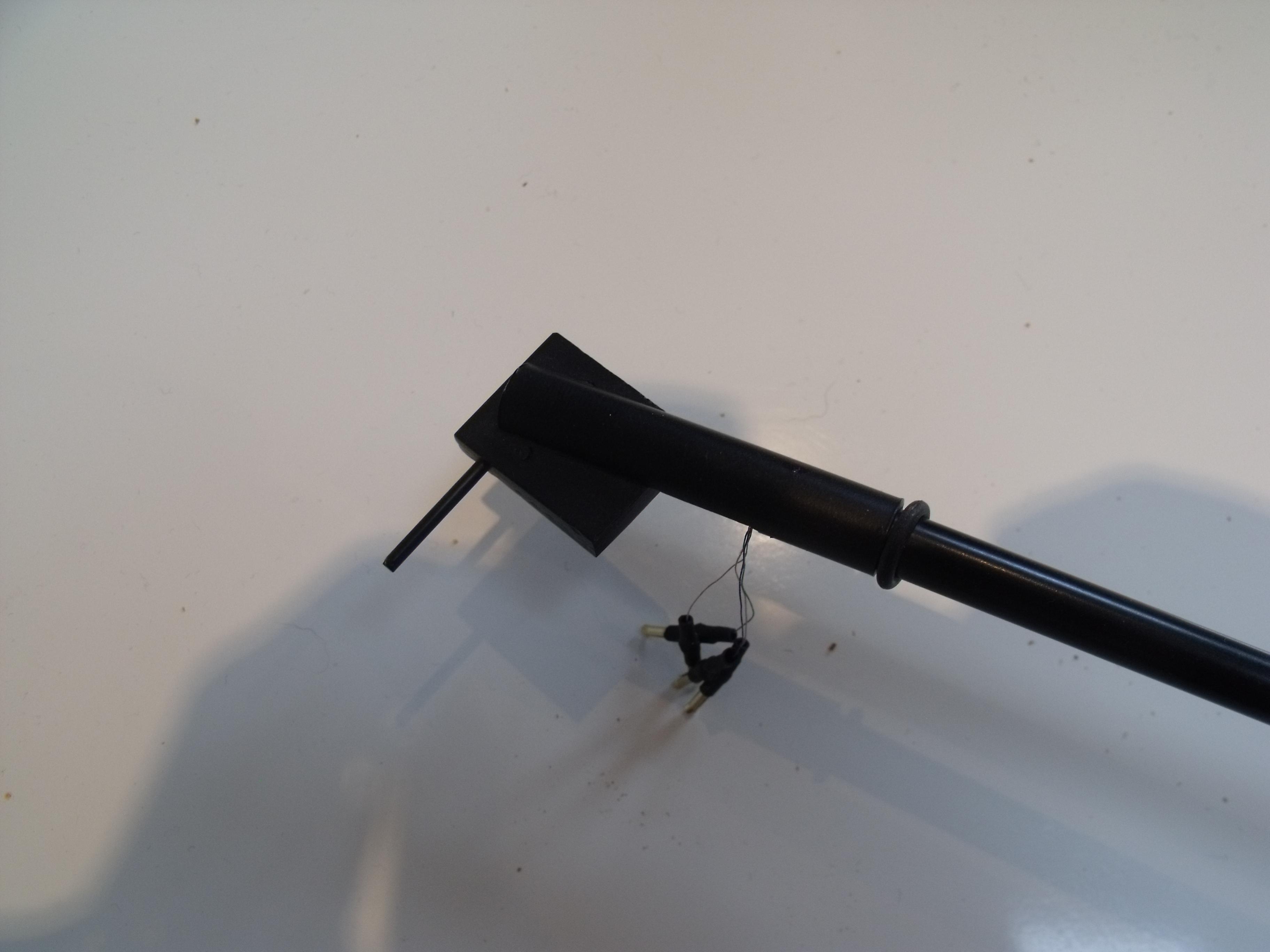

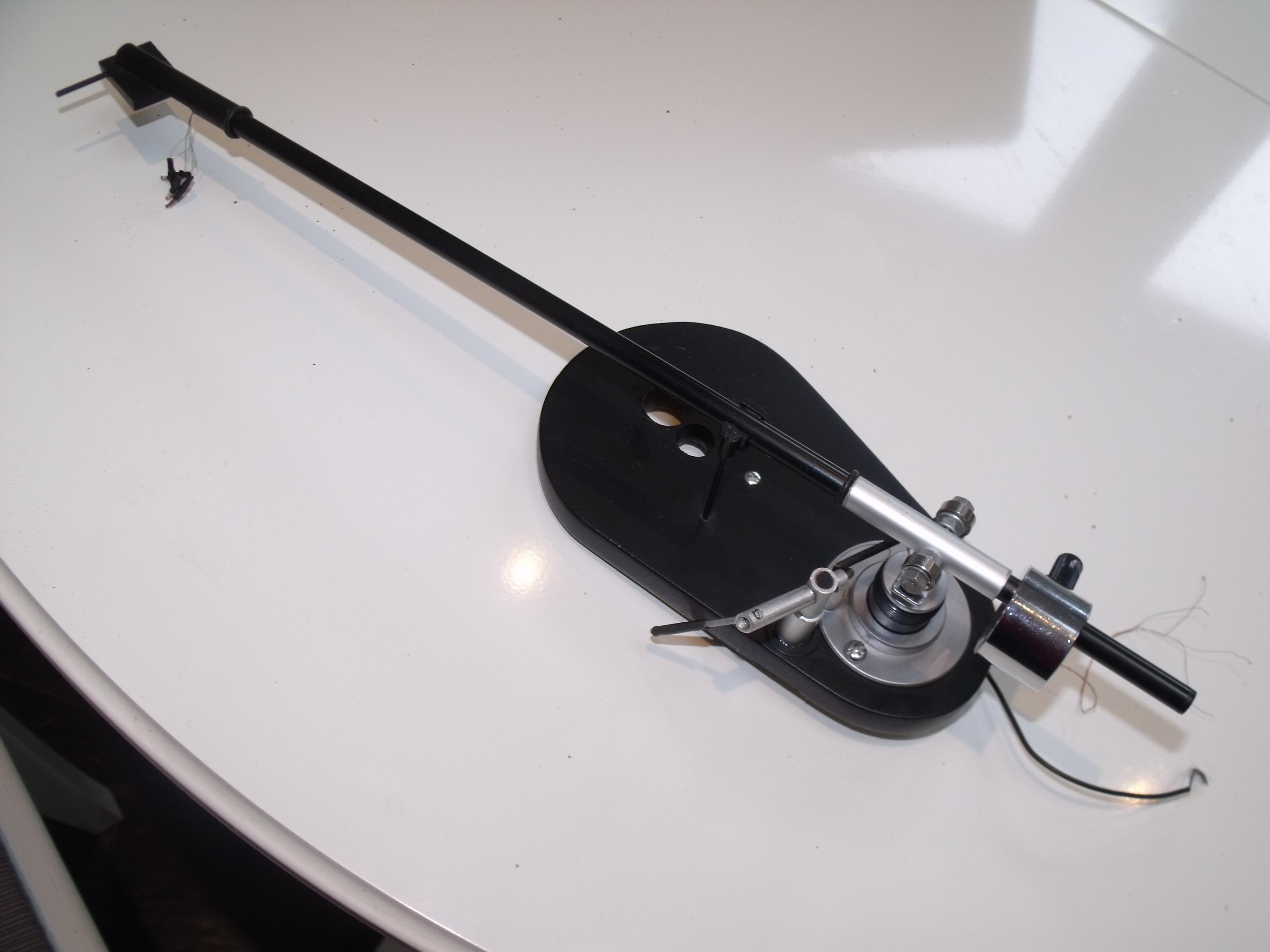

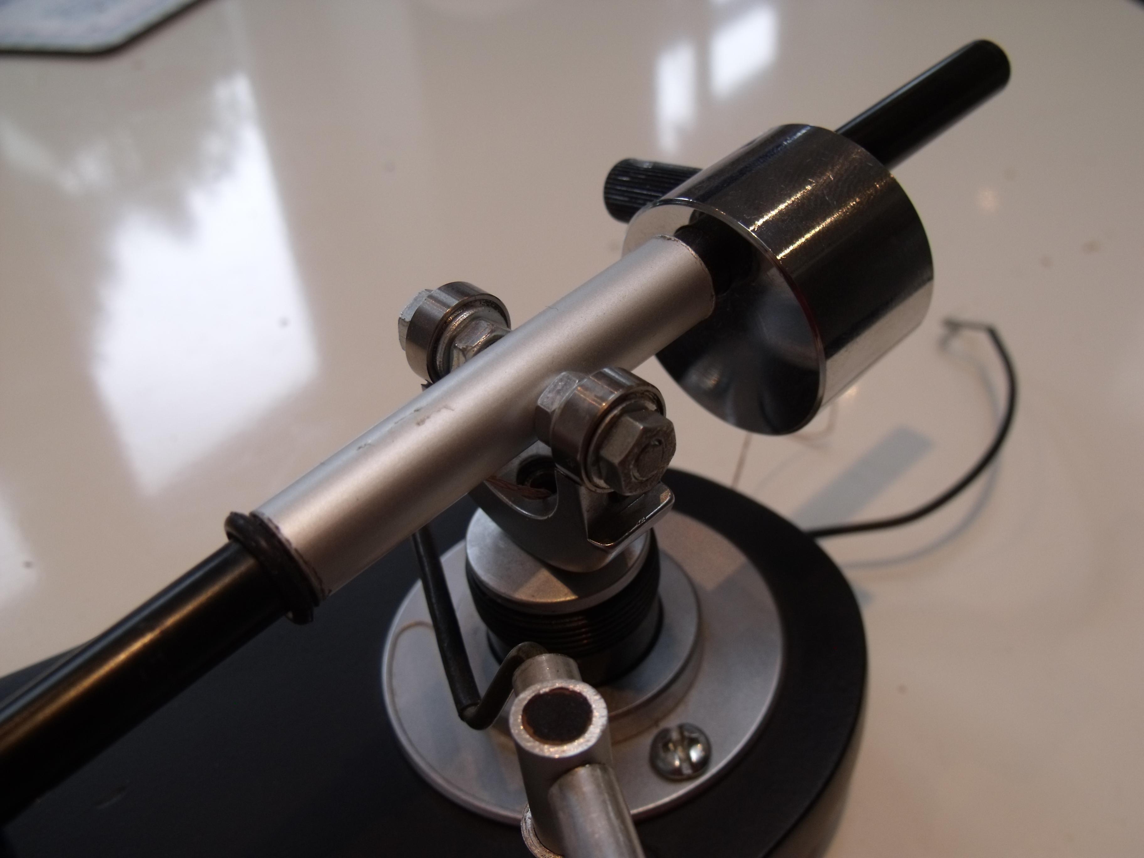

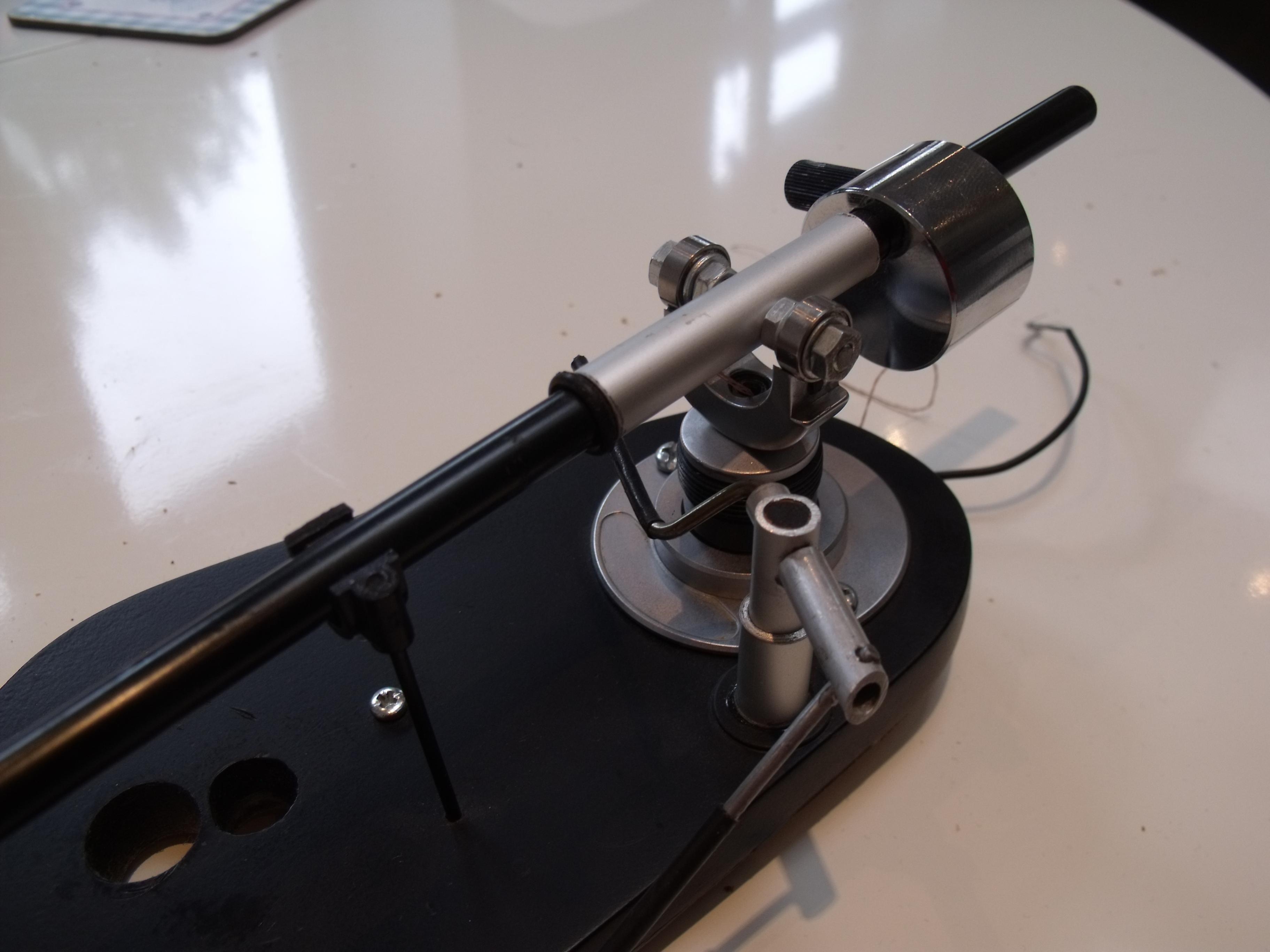

12" SME Hybrid
Hi All
Here are pictures of a little experiment I carried out. I had an SME arm pillar and bearing knocking around and decided to add a 12" arm tube and replace the lousy knife edge bearings with ABEC 9 ball races. Arm tube is an Easton Gamegetter arrow shaft (a la Nanook's arms) and the lift is a prototype which works well.
RESULT? I had 2 or 3 SME 3009's a few years back and was disappointed. No such results with this version. It performs brilliantly.
regards
Chris

I will try to get a 3009 for parts and start with experimenting with it. Mine is new and it would be a crime to cannibalize it so, I have decided to sell mine together with the Thorens TD147 Jubilee.
