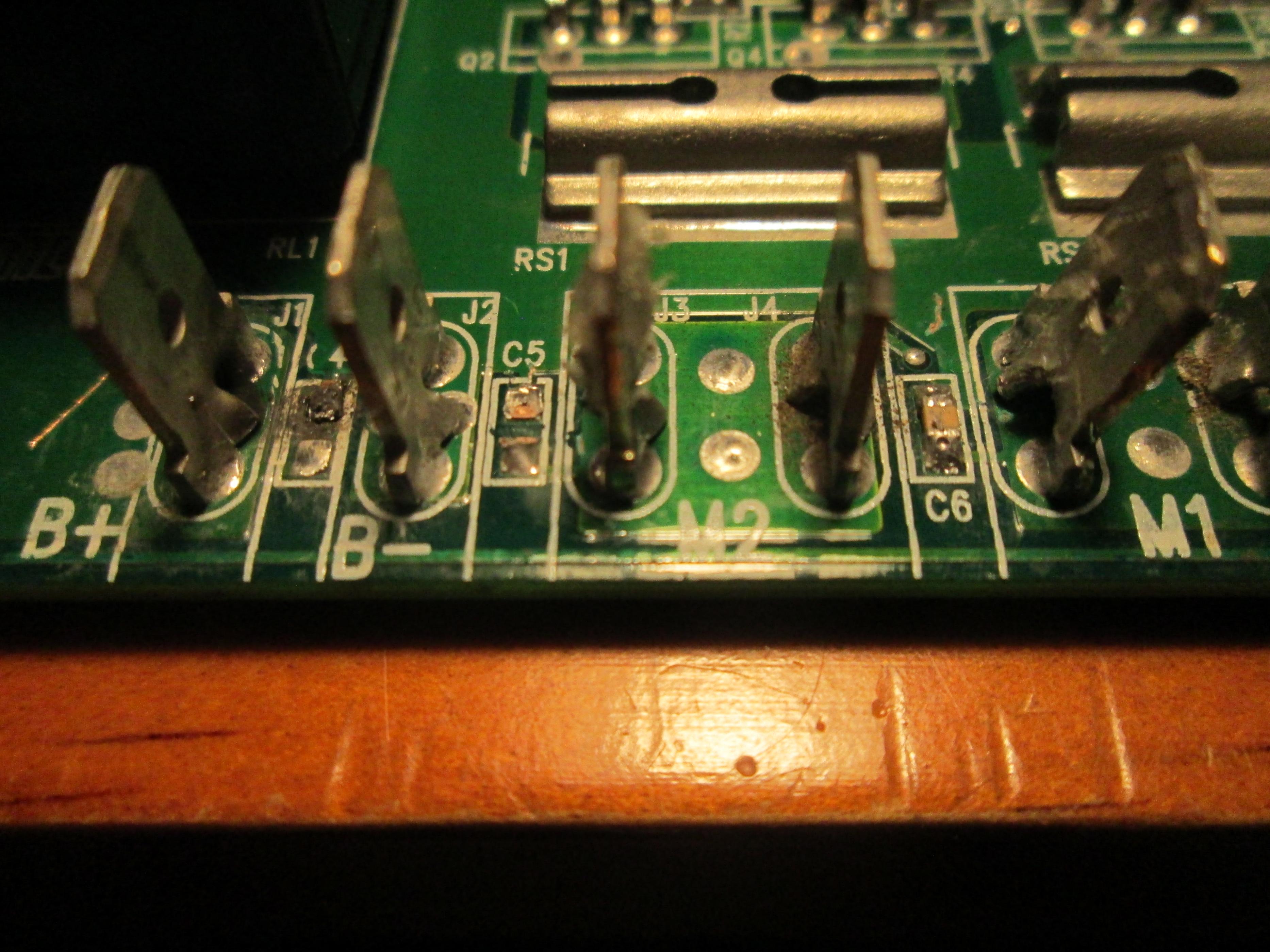

I found an ants nest in a mobility scooters controller so to open it up and clean it I had to dig out the hot glue gun deposits over the spade connectors. While doing this I dug out 2 SMD capacitors C4 and C5 while I was at it. C6 is still intact but my Fluke 87V doesn't register anything when I try to read the remaining C6 value? Any ideas what I could replace them with? I have some 1uf SMDs and some others I could scrounge from some boards laying around the place. They look like they connect to the B+ and B- rails and ground.
Those caps are ceramic types, your multimeter will need to measure capacitance into the pf range.

Maybe to try and parallel another known value for the test and see if you can get over the meter’s threshold?
A couple of those caps appear to be across battery connections and motor connections. I wouldn't scrounge - and I would try to get the actual schematic if possible.
You haven't mentioned what the package size is, looks big - 1206 in ceramic dielectrics are typically above 1000pF unless very high voltage types.
I would recommend new caps not scrounged and suspect X7R 100V 0.1uF might be in the range.

These capacitors are for RF suppression I think, 100nF 50V X7R will be suitable at a guess, they should not be necessary for functional testing of the scooter - just for passing EMI emissions certification process.
BTW I like the surface-mount massive current-shunt resistors on the PCB, not seen that type before.

I think you are right about those missing caps on the B+ and B- rails being RF suppression caps! I downloaded the Curtis PMC 1228 motor controller manual, it didn't have an internal schematic but it's big on EMI that's for sure, if it doesn't interfere with my stereo gear I'm Ok with leaving them out. What if I used ''No More Gaps'' to seal the spade connectors when I put it back together? It's waterproof and grips pretty well.
I put it all back together and it's working Ok now minus the caps. Thanks for all the info fellas.
