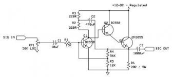

Or you can try this! I have very pleasing results from it!
See link here: http://www.diyaudio.com/forums/showthread.php?s=&postid=1538431
And see attached (updated schematic)
Cheers
D
Cheers
D

Do you have any pics of the actual build?
It is still a tangle of wires but I am going to develop it into a more presentable product soon.
D

Actually, GlidingDutchman, I take back what I said about it needing to be tube. That project looks simple enough that I might even tackle it! I need to work my way up in complexity of projects first and if it sounds as good as you say then it may be a good one to do. Do you have a parts list? Can that HP amp double as a preamp easily?
