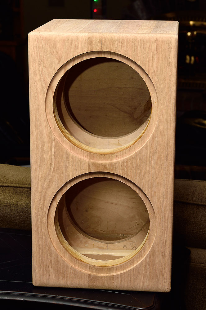

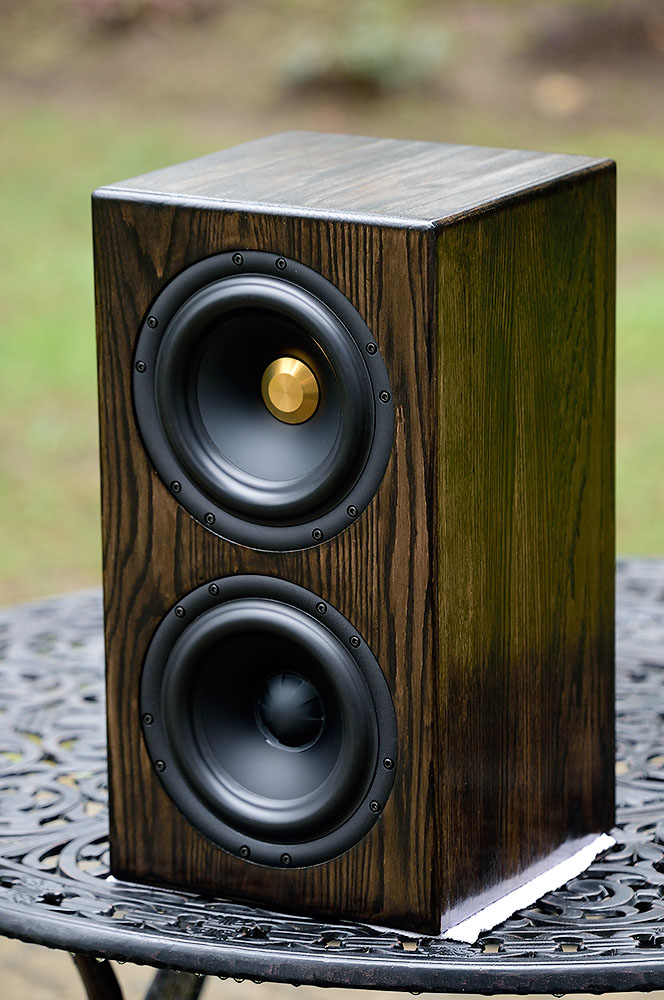

What qualifies as small? I built a 1 cubic foot sealed subwoofer enclosure with the ScanSpeak 23W/4557T-02, 9" Aluminum Cone Subwoofer and ScanSpeak 23W/0-00-02, 9″ Subwoofer, Passive Radiator.
From the distributor’s web page at the time; "The Scan-speak 23W/4557T is a very high end subwoofer, designed to be used with a passive radiator in a small enclosure. This sub has a very rigid aluminum cone, low loss rubber surround and cast frame. The passive radiator is similar, but with a weight attached to the bass of the cone. The 23W/4557T is using the SD-1 motor system. There are gold plated binding posts and the woofer is covered by a decorative rubber cap.
Frequency response with the passive is down to 25Hz. One cubic foot sealed has an F3 of 33Hz."
“This is the passive radiator intended for use with the 23W/4557T active woofer. We recommend putting both in a 1.0 cubic foot enclosure. This should yield a bass response down to 25Hz. The woofer should still be linear at 180 watts and have an output of about 104dB.”
Not the loudest and can’t take as much power as some but it does sound great and plays low.

One of the fellows who attends our informal car audio get togethers has a 23W/4557T-02 in a 30 litre (circa 1 cubic foot) sealed box in the boot of his Toyota Avalon and it goes deep, loud and sounds very musical in a classic case of quality over quantity.

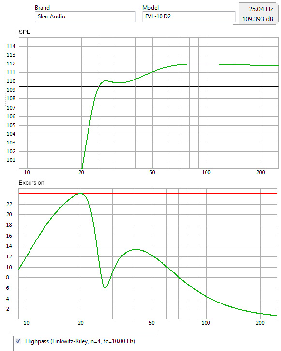

Sorry I can't help with what kind of passive radiator might be able to handle it; I just wondered if this car audio driver is interesting to you, since at my level of knowledge it appears to be build for for this application: The EBP recommends vented, but it only needs tiny tiny boxes even for very low tunings, so I'm not sure what it would be useful for beside PR use!
WinISD suggests that it might have a quite loud -3db point at 25hz, in 0.75ft3 ported, which is completely unbuildable as a vented box (it would 12 feet of 6" pipe for a port to keep velocities under control, haha).
